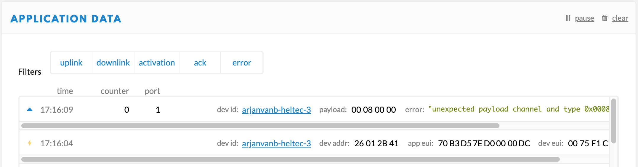

Is there a way with TTNv2 to
  • surely see if a Join Accept was generated by the network server?
  • to which gateway it was sent?
  • to clear the DevNonce history of a device (to ensure double DevNonces are not an issue)?
Posted by @arjanvanb back in Feb 17 :slight_smile:
@MOS-FET They are both the CubecCell dev boards.
I had wondered if for some reason there was an issue on the TTN side (I figured a remote chance, even though unlikely), so created a new application with a new app key and same issue. I’ll post to the Heltec forum as well for some ideas.

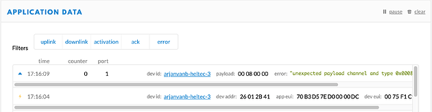

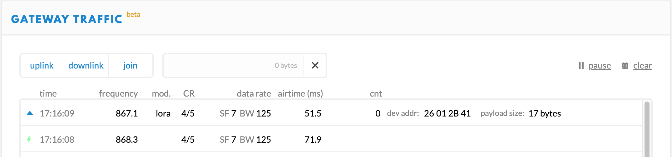

Apparently somehow depending on the type of gateway, or on the type of forwarder software (like Semtech UDP or TTN MQTT), the gateway Traffic page(s) might show an orange Join Request. The application’s and device’s Data page will always show an orange Activation if TTN accepted the Join Request (including the new DevAddr). And the Traffic page of the gateway that was selected for the downlink will show the green Join Accept:
For errors see OTAA shows "Activation DevNonce not valid: already used" or Activation not valid - no gateways available.
