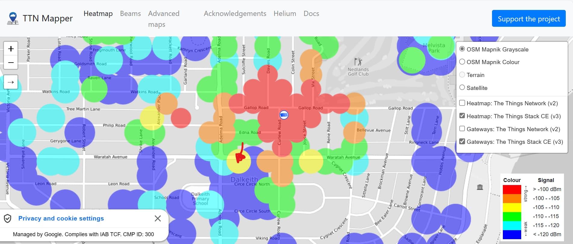

The sensor is located where the red arrow points. It looks like there is enough coverage there but the sensors won’t connect (or at least won’t appear as connected in our application).

there are two different channel planes in aus
AU_915_928 and AS_923
{"netID":"000013","tenantID":"ttn","id":"rak2245-rpi","eui":"B827EBFFFE9E871E","clusterID":"au1.cloud.thethings.network","updatedAt":"2023-12-12T10:05:26.922718Z","location":{"latitude":-31.9931,"longitude":115.80183,"altitude":32,"accuracy":0},"antennaPlacement":"OUTDOOR","antennaCount":1,"online":true,"frequencyPlan":{"region":"AU_915_928","loraMultiSFChannels":[916800000,917000000,917200000,917400000,917600000,917800000,918000000,918200000]},"rxRate":0,"txRate":0}
that gateway is on AU_915_928 and your sensor is on AS923
you will need to most probably get your own gateway
as the closes one to you is some 6km away
