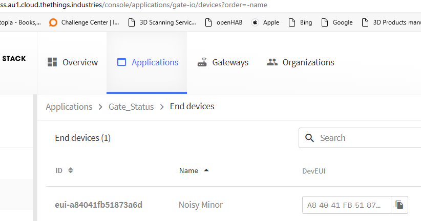

I have just tried logging out and in again, making sure that I selected the “au1” cluster.
The dashboard seems to show me connected to the au1 cluster by the URL as well as the connection status icon.

Could it be a problem that I named the end device with 2 words with a space between them? I assumed that the device would be referenced bu it’s EUI rather than its name.

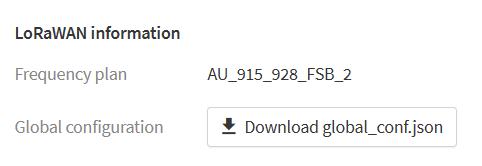

The frequency plan is Australia FSB2. I believe that this is what TTN & TTI require. The image below shows the setting for the Gateway

Thanks, I will look further into the documentation around naming. If the space in the name is a problem, I’m not sure how I will fix it as I don’t seem to be able to edit the devices configuration. I will cross that bridge when I come to it.

You can’t put a space in the device id and you should be able to edit a device name.
