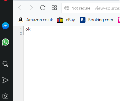

Using view page source (ctrl + U) I just get the “ok” again.
