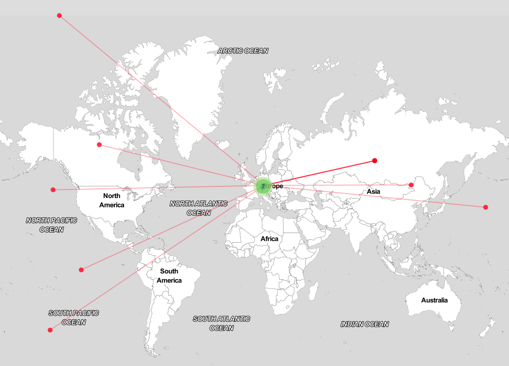

On TTN Mapper I recently started seeing a lot of invalid data points, like below:
This also happens to devices that were mapping fine for years on V2.
Further investigation shows that V3 is forwarding port 0 data to the payload formatter. Naive payload formatters do not check the port number, and decode port 0 mac commands as if they are coordinates.
See the raw data for the device in the above screenshot here:
port0decoding.csv.txt (120.8 KB)
In this CSV we can see that it is the packets received on port 0 that is causing the invalid locations on the map.
How to fix this:
Add a check for the port number in your payload decoder. If you know you are sending gps coordinates on port 1, add a if check like this:
