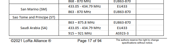

A quick check of LoRa Alliance RP002-1.0.3 shows
Though you should check with them for latest info and also (as you are doing) do your own due dillegence/regulatory checks - consequences of mistakes in some countries can be profound! :wink:
This is just for general information as private network + 433Mhz likely places outside of scope of this Forum (unless engaged with TTI Core for the Private Instance - in which case I’m sure the team can guide you further :slight_smile: )
