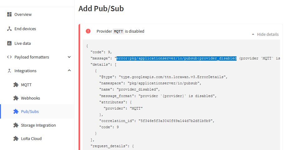

I’m trying to configure and mqtt pub/sub integration but I always (tried 2 different brokers) get the following error.
What does it means?
What does it means?
These kind of Pub/Sub integrations are disabled on the deployment you’re using. While these integrations do work on small deployments, they don’t scale well (or reliably) on large deployments, which is why large deployments often disable them.
When disabled, the integrations should be hidden from the Console as well to prevent confusion. We’ll work on fixing that.
Thanks @htdvisser
So, there will be no pub/sub integration in The Things Network Community v3 (https://eu1.cloud.thethings.network)?
No, The Things Stack (in this configuration) will not publish/subscribe to an external broker. The Things Stack still exposes its own MQTT server if you want to subscribe to that from a client.
The most scalable and reliable way to integrate The Things Stack with external platforms is to use webhooks.

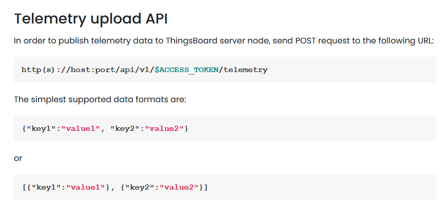

Webhooks are nice, but the decision of moving the downlink api key to the header will break some integrations, like the ThingsBoard Community one.
It would be nice to have the api key in the body of the webhook.
I’m not sure how the ThingsBoard integration works. I think @snejra knows more about that one.
Ok I’ll wait.
The problem with ThingsBoard is that you don’t have access to the header of the request; just the body and with a very tight format
At this point, ThingsBoard integration in V3 is implemented only via MQTT, not Webhooks → did you take a look at our documentation?
Thanks @snejra
It’s a pity that the ThingsBoard Community Edition (not Professional) are left behind.
We will find a alternative
