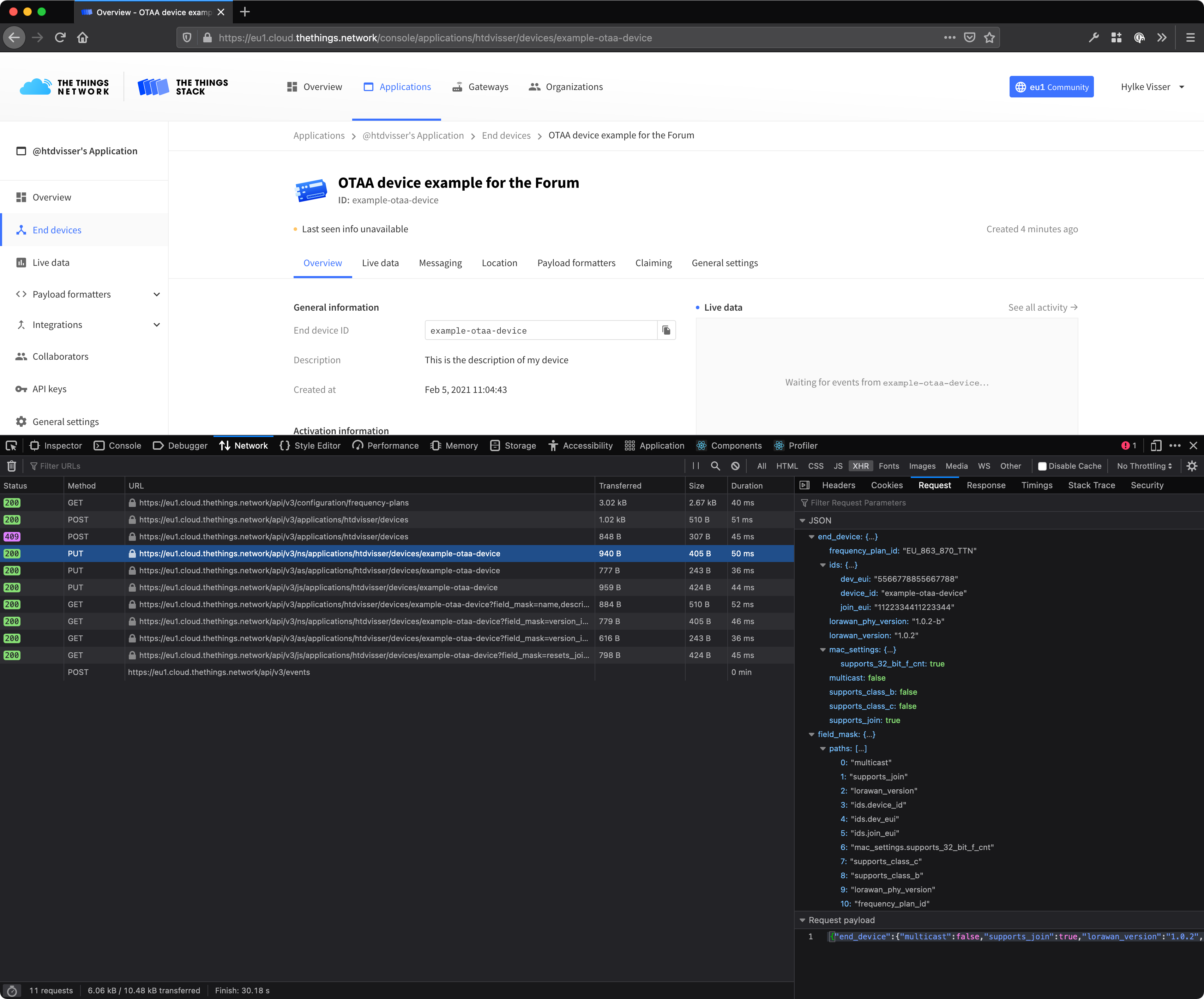

My recommendation for anyone working with the HTTP API would be to take inspiration from the Console, as it uses the exact same HTTP APIs that you’re trying to use.
Open the Console in your favorite browser. Then open the Developer Tools of your web browser and select the “Network” tab of the Developer Tools. Now execute the actions you’re trying to implement. The “Network” tab should capture the requests the Console makes, and you can see exactly what your application would need to do.
Screen Shot 2021-02-05 at 11.09.07
(don’t mind that 409 error, that’s a known bug in the Console that’s getting fixed)
This is the approach I took found it very quick way to get started
Hylke, thank you very much.
This is indeed the quick way to start. Now I have my commands available in Postman.
It did help me very much !
