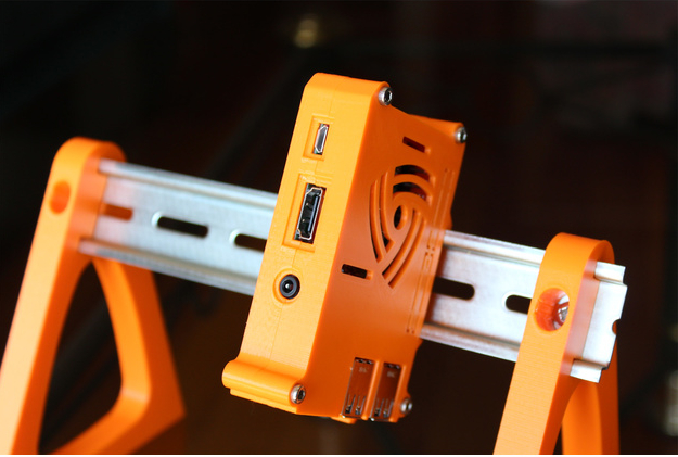

Was planning to use modifed RPi DIN cases - ended up using them when I got bored in lock down…for RPi’s! :slight_smile: Will check if have some left in spares…did a bunch…and will send you 1 or 2 if I can find them :wink:
Found designs on Thingiverse and another place - will check…
One example - IIRC the Pygate mounting holes were just a bit smaller spacing than the RPi mountigs so easily adapted, given smaller size relative to RPi. Was looking to cut a couple of small slots in longer edge of housing for pwr, external SMA Ant, etc.
Was waiting to check when in hand as suspected there was just enough space at end of case to add a small DC-DC to adapt a standard DIN PSU feed…
Nice-looking DIN case.

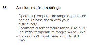

Data good on some aspects but ambiguos/unclear/conflicted on some basics. e.g.
So both industrial and consumer temp range called out - so which is it? also if that is abs max, what is operating limit to stay safe under warranty? (I may have missed but couldn’t see called out in spec on quick read.)… I know will do as recommended and check what is/may ordered…
Ok can see variants by op freq and bundles with PoE adapter…but no temp variant
May be a clue in Regulator declaration?
Ah so its commercial then? :wink:
Note the OEM Warning also highlighted…if yo integrate it with other products ina system your not allowed to tell people how to remove (e.g. exchange if changing territory or if a unit defective…not a hobbyist product…confirmed by…
Just asking/highlighting…
Perhaps someone from Pycom can comment & clarify, is there a roadmap to wider temp versions?
Is it ok to add a WiPy module as indicated in the 1st diagram in the datasheet or does that open up a world of pain and additional costs?
All very good points.
I hadn’t thought much about the low end of the temp ranges, which surprises me because in my professional life I often have - 0 deg C is insufficient around here. - 20 °C is close enough, -4 °F is extremely rare around here, especially recently.but single digits °F is seen up to a handful of days in a given winter. We used x86 architecture processors, which are never rated below 0 °C - so were dependent on those few fanless industrial/transportation computer vendors who bother to test and bin the Intel chipsets by low temperature tolerance for different applications. They can warrant some product variants for low temperature range uses using the “binned” chipsets.
Unless I can hope that the internal heating in an IP67 enclosure from an always-on PyGate and WiPy generate enough delta-T to keep it about 0 deg C - sounds likely. Since I think I see a heat sink on the baseband chip, it seems likely.
