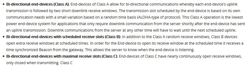

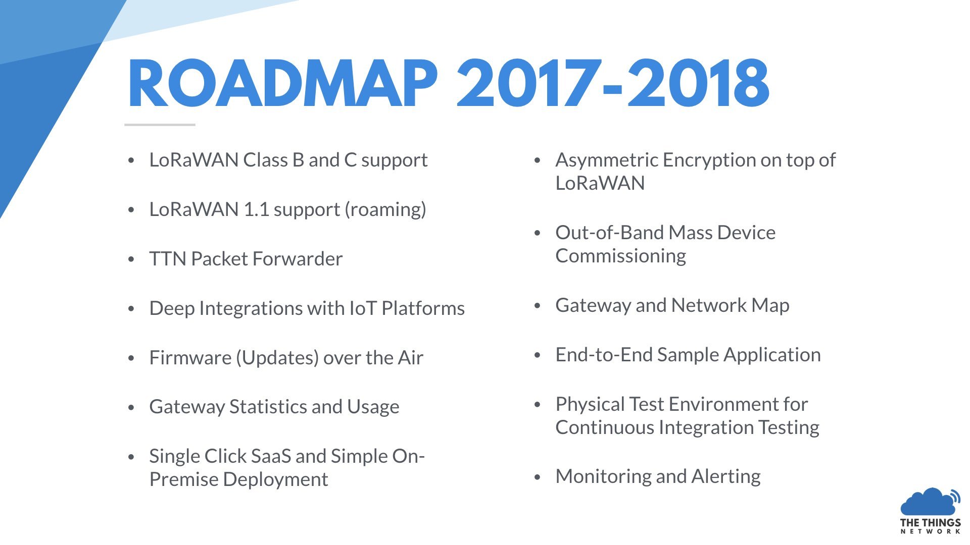

I see in the roadmap that TTN is planning class B and C support.
How does this time synchronisation work for class B ? does it work with non TTN gateways and what changes technically for a node ?
Is this the roadmap for the ‘free’ TTN, or will some features be reserved for premium services offered by TTI?

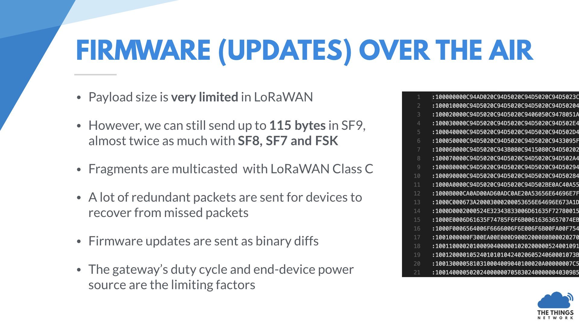

What will be the approach for transmitting the OTA firmware updates?

@wienkegiezeman @johan Now that the TTN gateway is shipping, maybe it’s a good opportunity to update the roadmap ahead?
Personally, I’m very interested in the status of the TTN gateway agent. Does @egourlao has any updates as well?

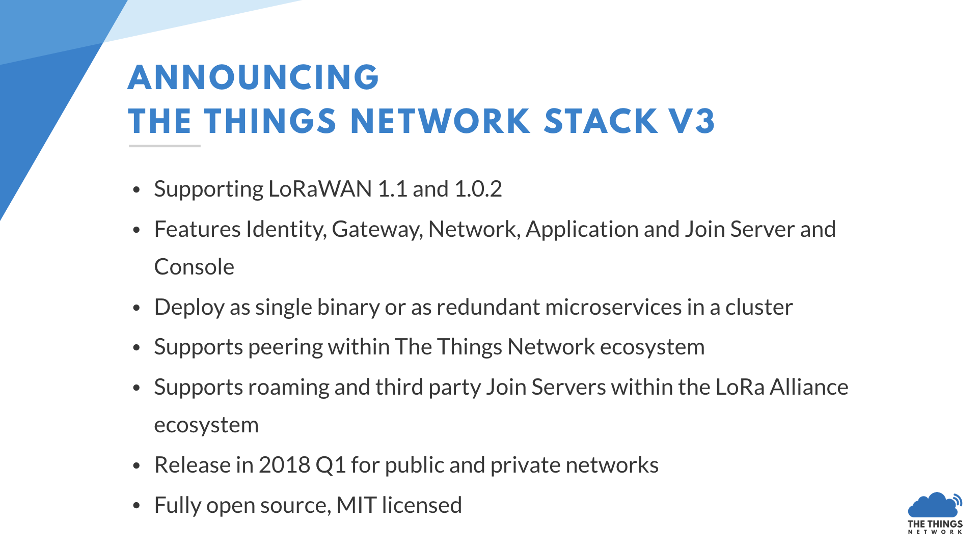

@Epyon you’re very right about the need for an updated roadmap. We are working on this, and the Conference will cover a keynote about it for sure. The goal is to get it out before.
Here’s the key points that are public so far:
