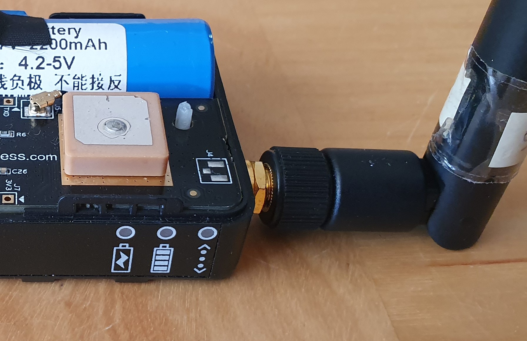

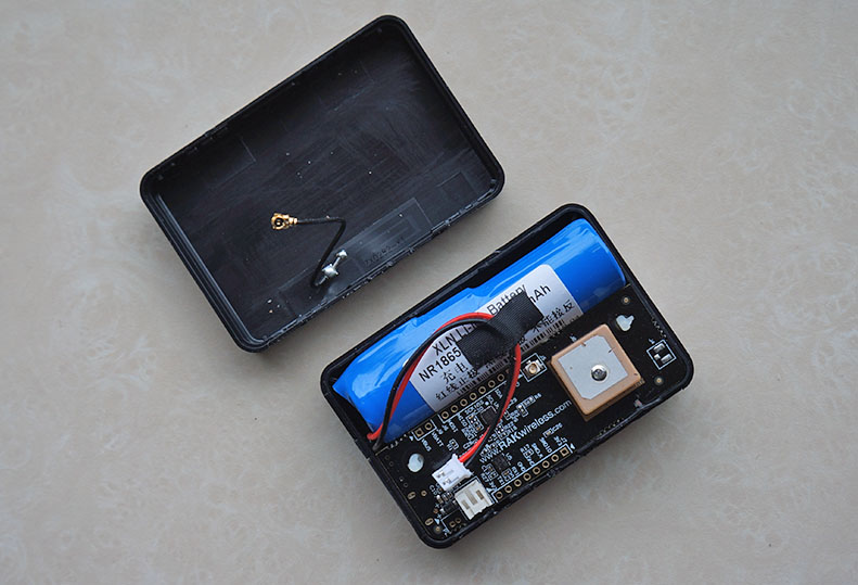

modification for external antenna

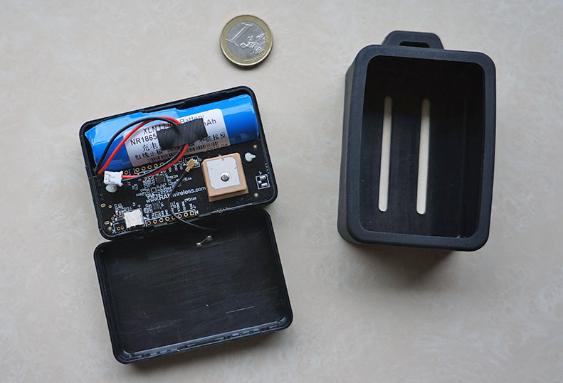

I closed the enclosure before attaching the battery … any tips how to ‘crack’ it open again ? :scream:
x1541
x1542
45%20PM
:hammer: :pick: :bomb:?
tnx… it worked :wink:

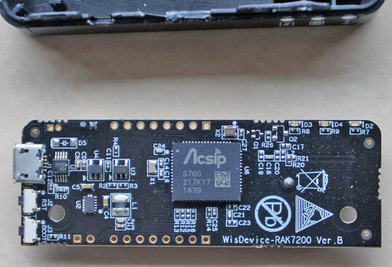

Only just noticed the move from '811 to Acsip radio module! :thinking: Hummmm…

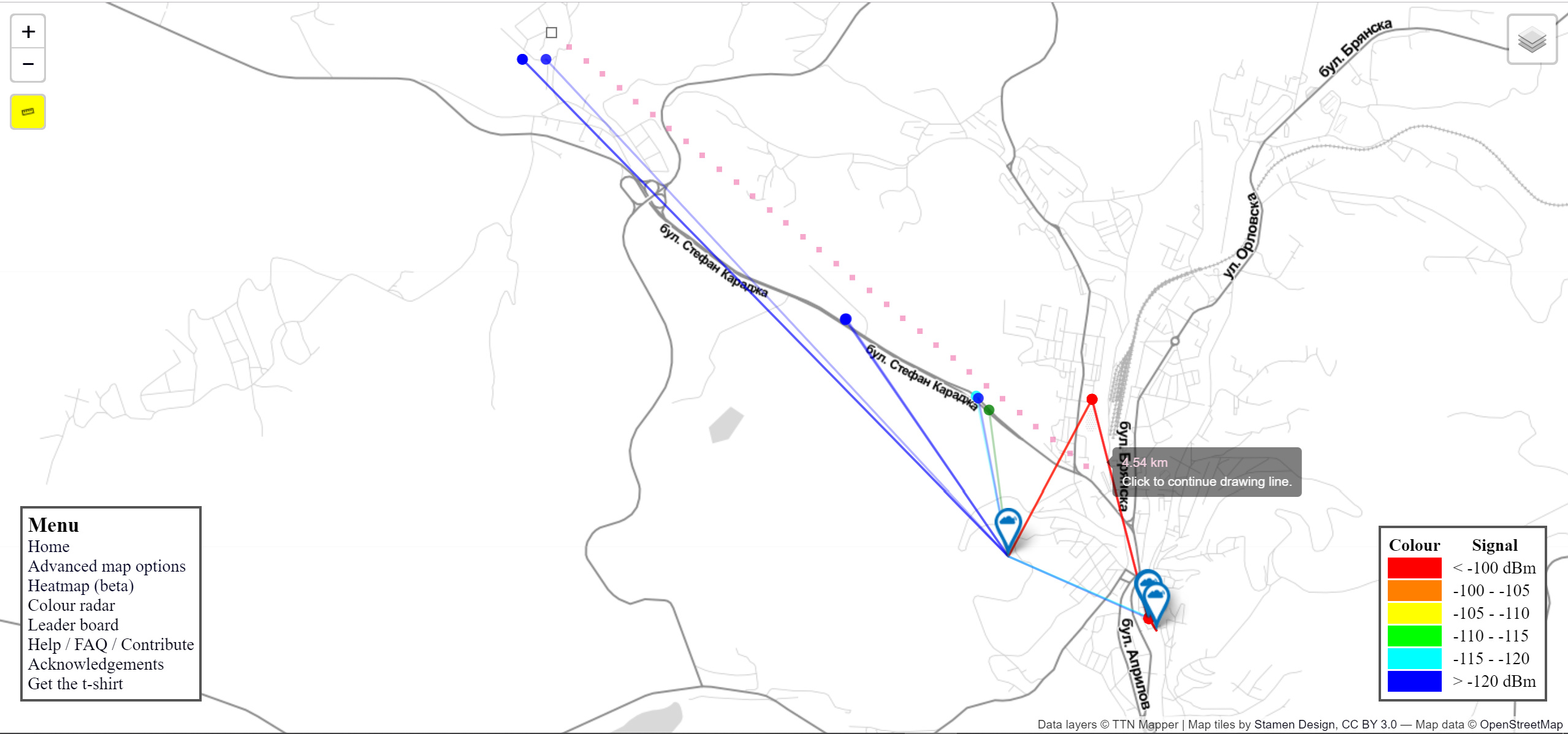

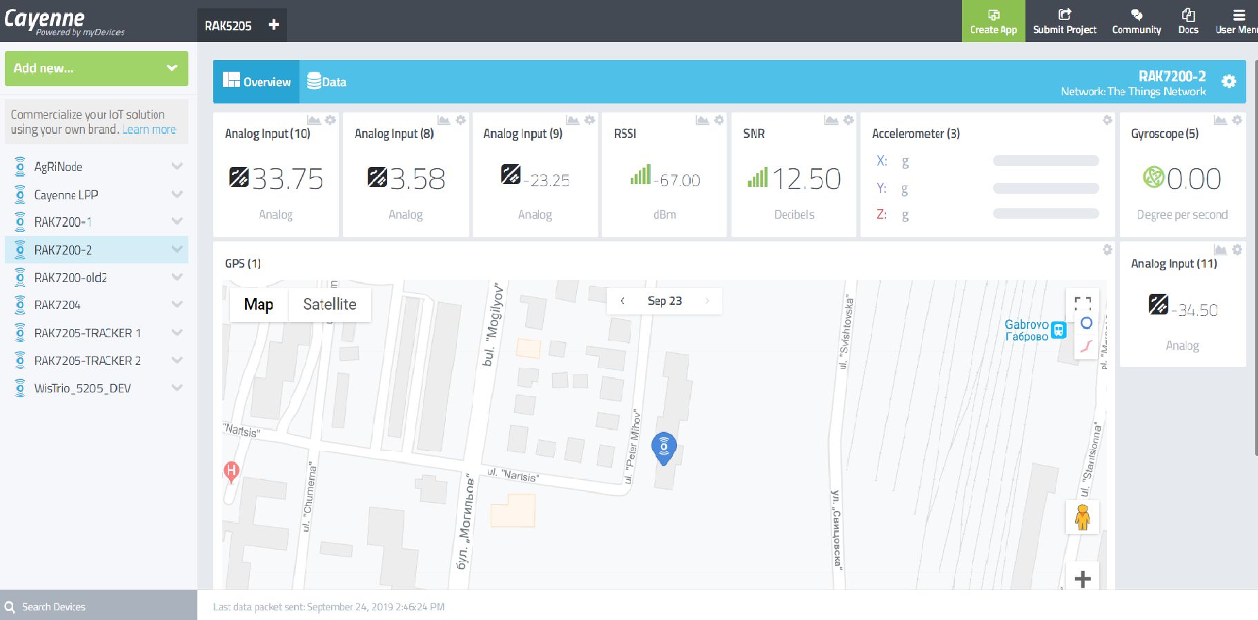

Around 5 km driving, auto data sent - 60 seconds, GPS timeout 60 seconds.
Test is made in Gabrovo, Bulgaria, EU.
Cayenne is also back
cayenne7200
You are testing it with a RAK5205, not a 7200. Also you have a temp/hum sensors which isn’t available on a 7200
Today drove 2x 27km and no GPS hit received with 100sec GPS timeout.
