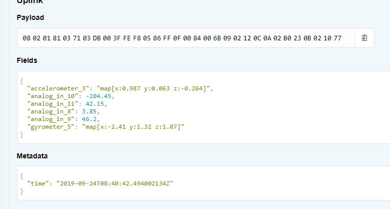

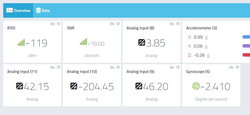

I have finally received RAK7200. Wanted to test it registered on cayenne and it looks like decoder works wrong and coordinates shows like analog inputs. Is it possible to fix it somehow?
On TTN it shows also wrong so it is definitely decoder problem:

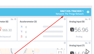

you can edit the title to ’ battery voltage ’ :wink:
Amazing :smiley: it shoud be something we can do about coordinates. Anyone gets correct coordinates on cayenne?

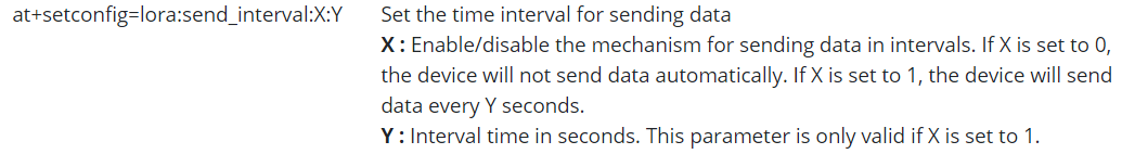

The AT command is this one:
In this version firmware, you can use this AT command and set X to 2 which means RAK7200 will send packet every Y seconds too, but after sending, RAK7200 will not go to sleep.
For example, “at+set_config=lora:send_interval:2:10” means RAK7200 will wait for 10 seconds after sending a packet without sleep, then it will prepare another packet for sending.

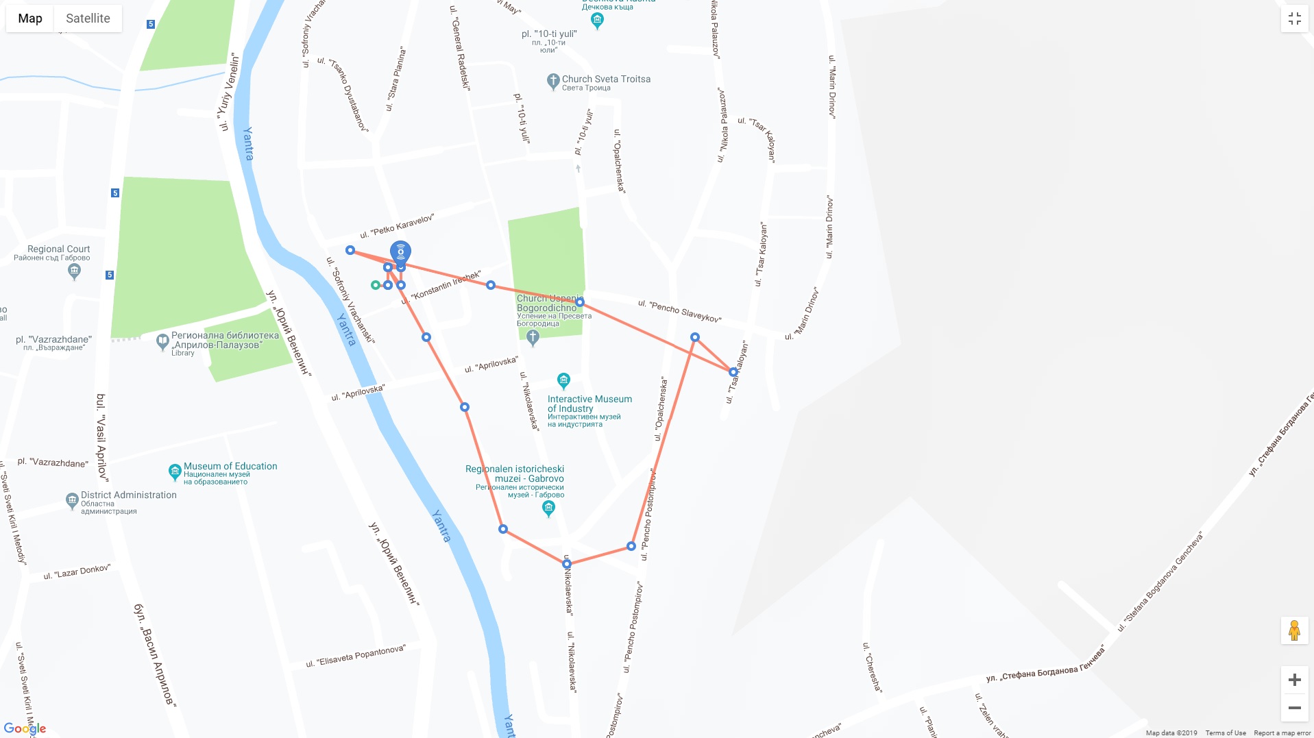

This is test from today :
cayenne

Hahaha, and the temp/hum sensor dissapeared also :wink:
Wow. My bad, wrong picture attached :smile: Glad there is so observant people.
