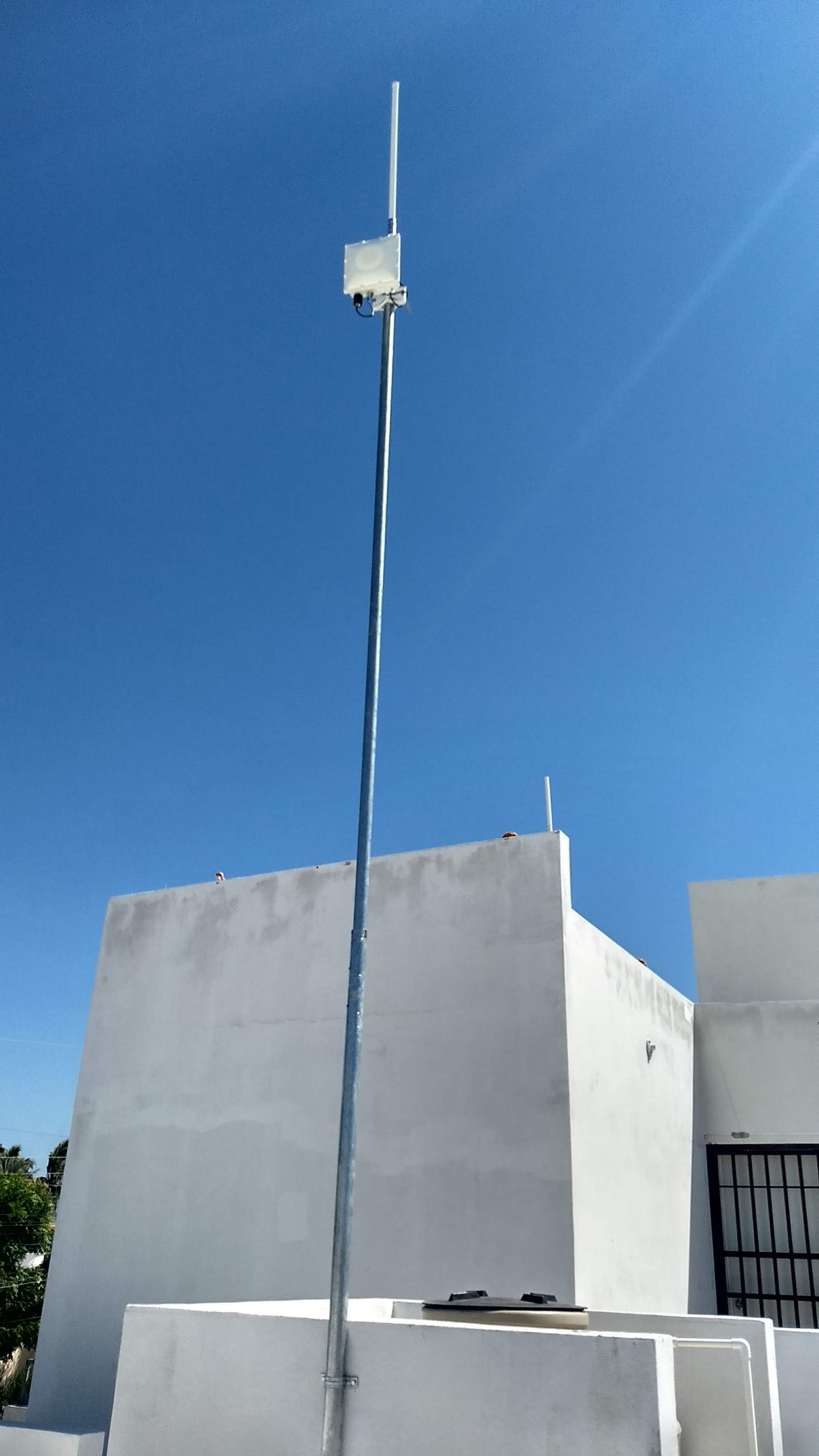

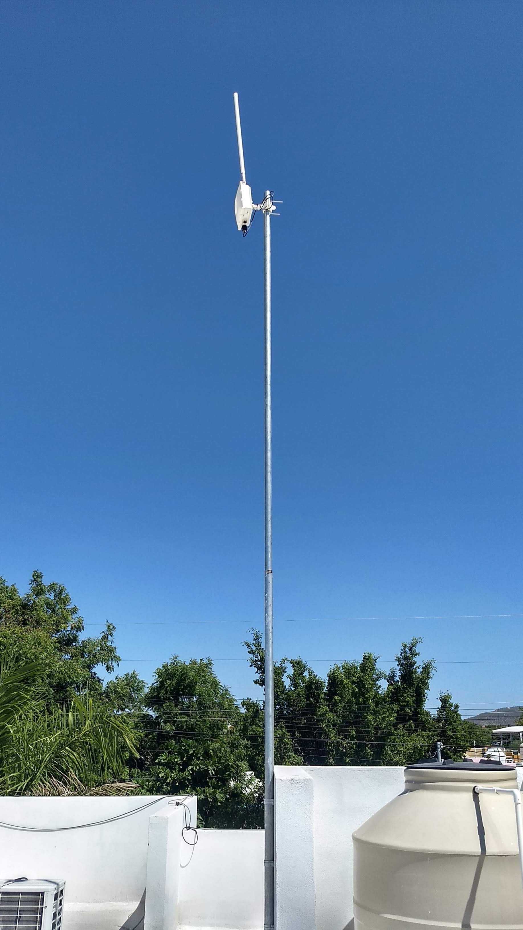

Finally my little boy is playing on to my roof, RAK micro gateway indoor into a IP67 Rak enclosure feed with PoE 48V, 5.8 dBi gain antenna everything working as expected at 9-10 meter above sea level. Not bad for a test, 10.8 km in TTN Mapper and i don´t went further
IMG_20191009_132902738_HDR IMG_20191009_132910535_HDR

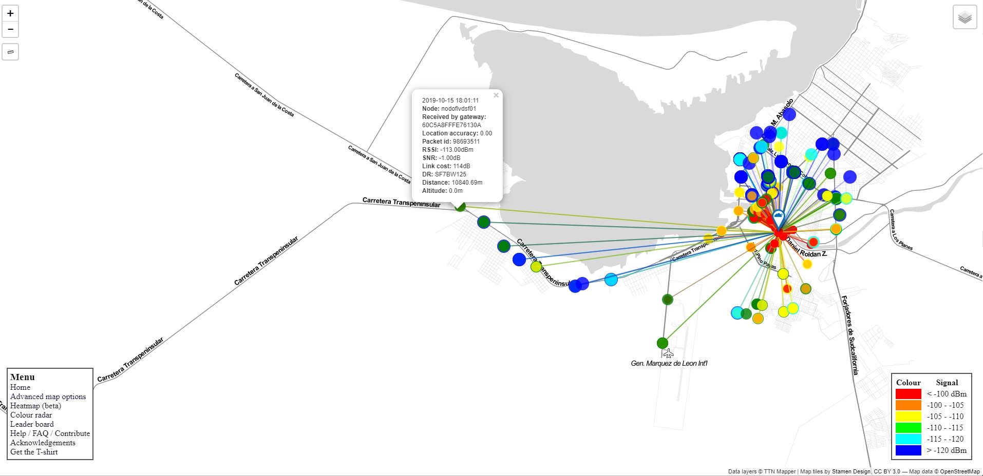

And the TTN Mapper map
TTNmapper

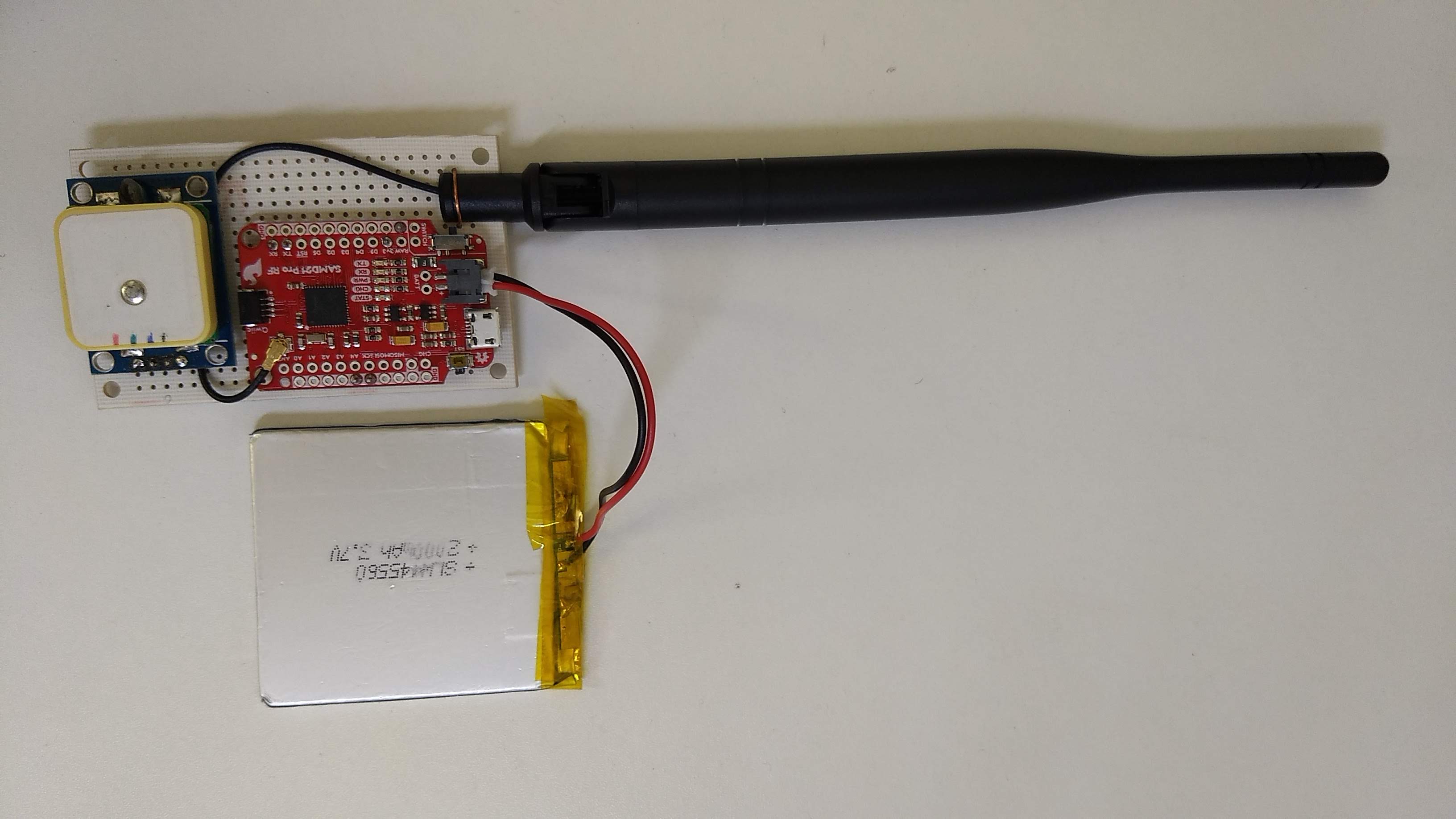

With SparkFun RF Pro LoRa node and NEO-6M GPS attached
Node
