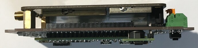

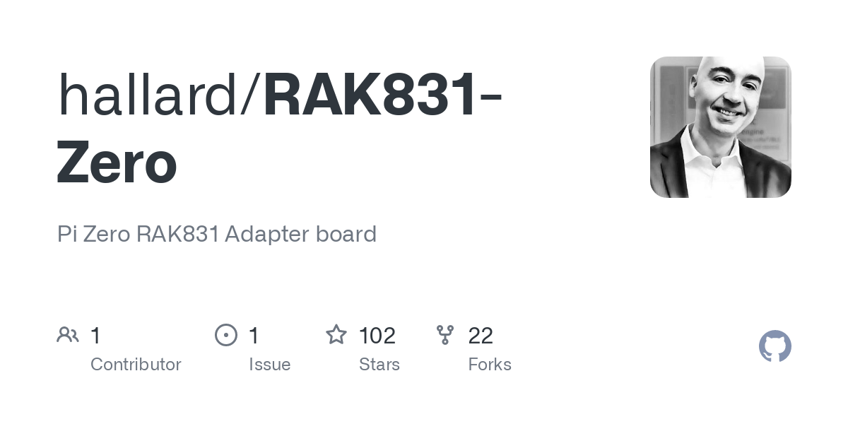

just to let you know I’ve released all source code, BOM and documentation of this DIY small GW based on a Raspberry PI zero and RAK831 Concentrator. It works with @kersing new packed forwarder(MP Packet forwarder release for Linux based gateways)
PCB Boards https://github.com/hallard/RAK831-Zero
Software Setup https://github.com/ch2i/LoraGW-Setup
Any ideas and/or changes are welcome

Did you noticed the place for your favorite OLED with 5V power :wink:
Add a RAK831 maybe? :wink:
