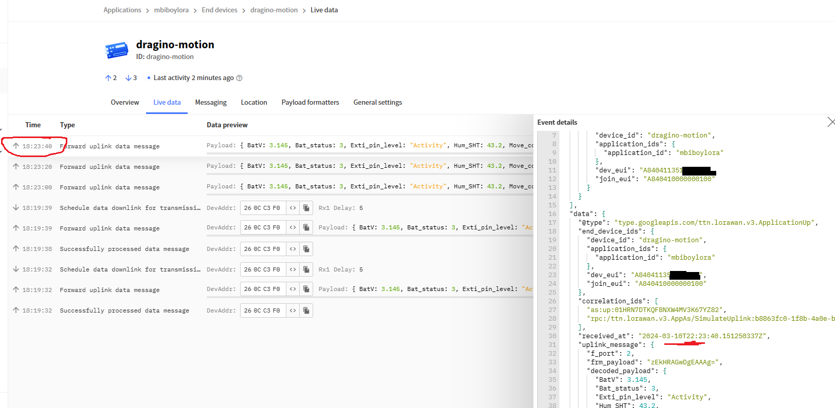

msg.payload.received_at timestamp is 1 hour behind after daylight saving time change. See the screenshot below. The timestamp is in UTC and my local time is EST (-5:00 from UTC) and it is defiantly off one hour.
This is throwing off my node-red functions that flag if one of my devices has not communicated for over 1 hour and shows it offline.
The time stamp circled in red are related to the time zone from your browser (form the browsing device)
The time stamped underlined in red are from the LNS, that is definitely not off.
So check your time zone/settings on the browsing device.
Yep my bad. The UTC timestamp is correct. I need to account for daylight savings in my JSON expression. Thanks!
