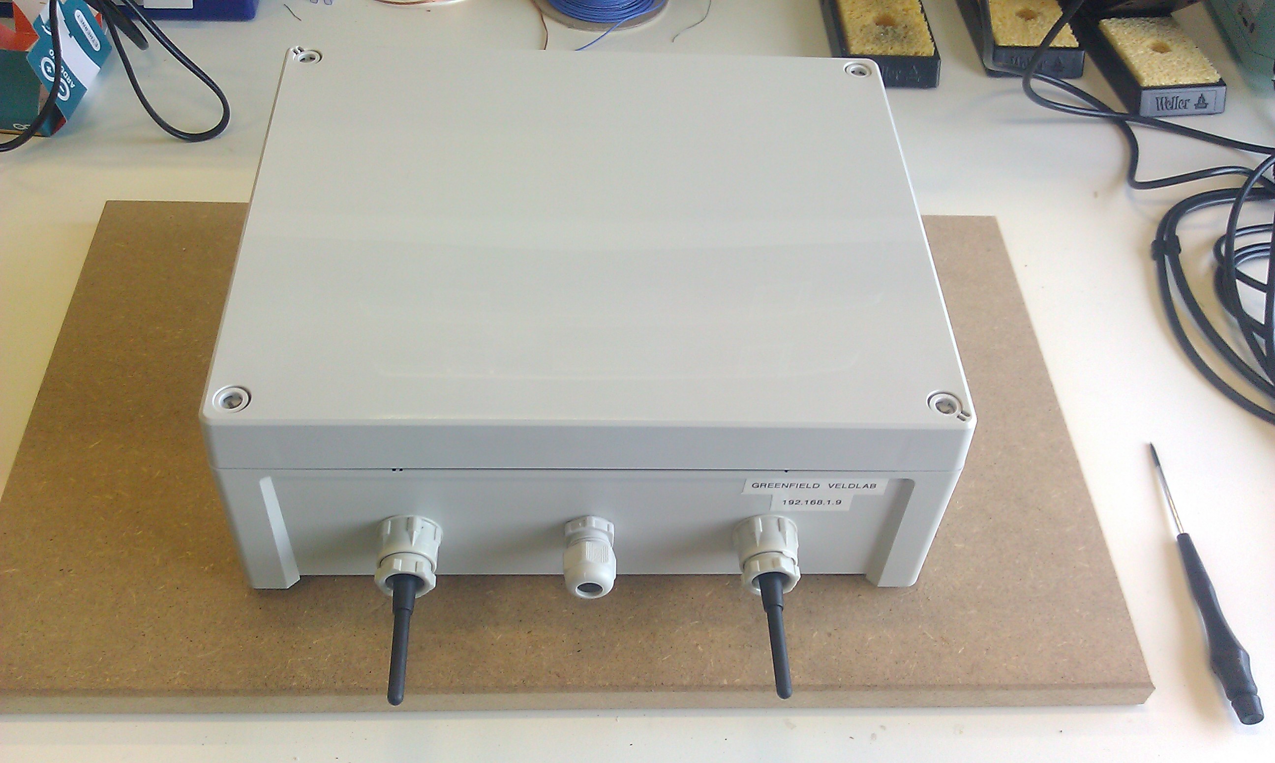

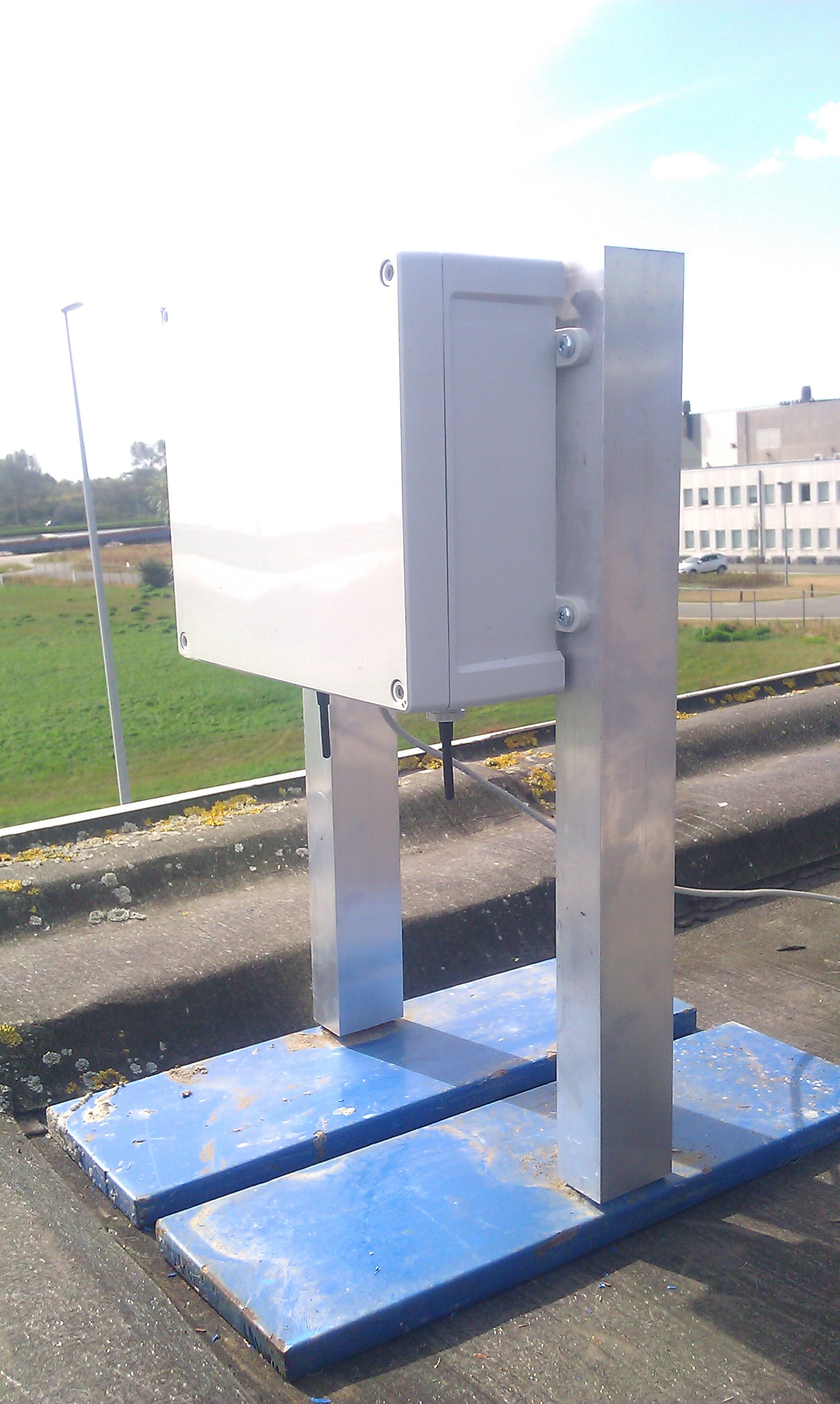

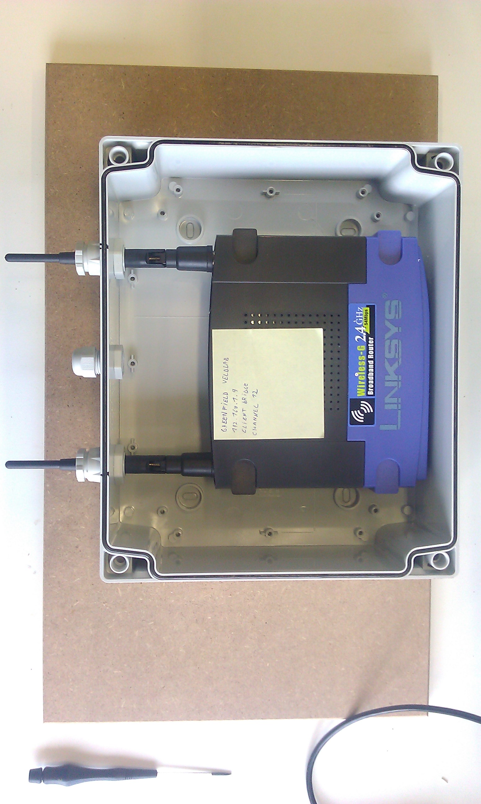

To give you an idea: one of the first outdoors WSN I set up was based on WRT54GL soho routers. I bought inexpensive IP54 enclosures from Fibox to put the routers in, and drilled holes and used cable glands for the antennas and power/data cable.
The boxes were placed on roofs and in a field where they were subject to wind, rain, cold and heat.

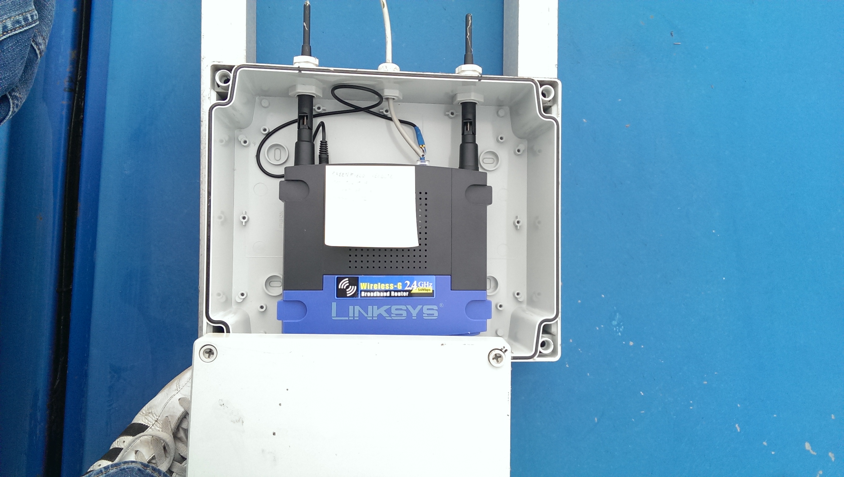

This is how the inside of the box looked after 6 year.
Eight years later they still function just like on the first day :slight_smile: . So I wouldn’t worry too much, just buy a good (white!) enclosure and in most climates you’ll be just fine.

Could it be that your enclosure isn’t absolutely tight where you feed the antennas through the glands? That would possibly explain why this setup doesn’t suffer from condensation even though you didn’t install a pressure vent AFAICS.
Indeed, that is also why I mounted the glands on the underside of the enclosure only. I tighten them enough so that spiders can’t get in, but moisture levels can settle. Water can’t get in because of the location of the glands. Poor mans solution, but works perfect :slight_smile: .

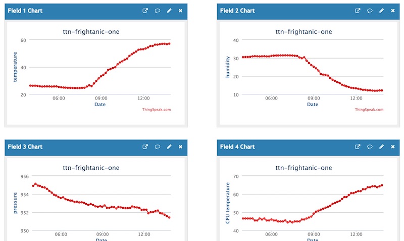

Ambient temperature reaches around 31°C in summers. No idea how hot the enclosure gets, it’s white but not shaded from the sun. Winters can get -5°C. I’ve not had any issues with the equipment so far.
I have a BMP280 in my enclosure and push the data to https://thingspeak.com/channels/275145
Here are the figures from today, a sunny day in fall. The gateway is unshaded in full sunlight (I’ll change that soon):
gw-figures
–> ambient is close to 60°C
–> Pi CPU temp is ~65°C
Both Pi and iC880A are rated for up to 75°C as per their spec sheet.
