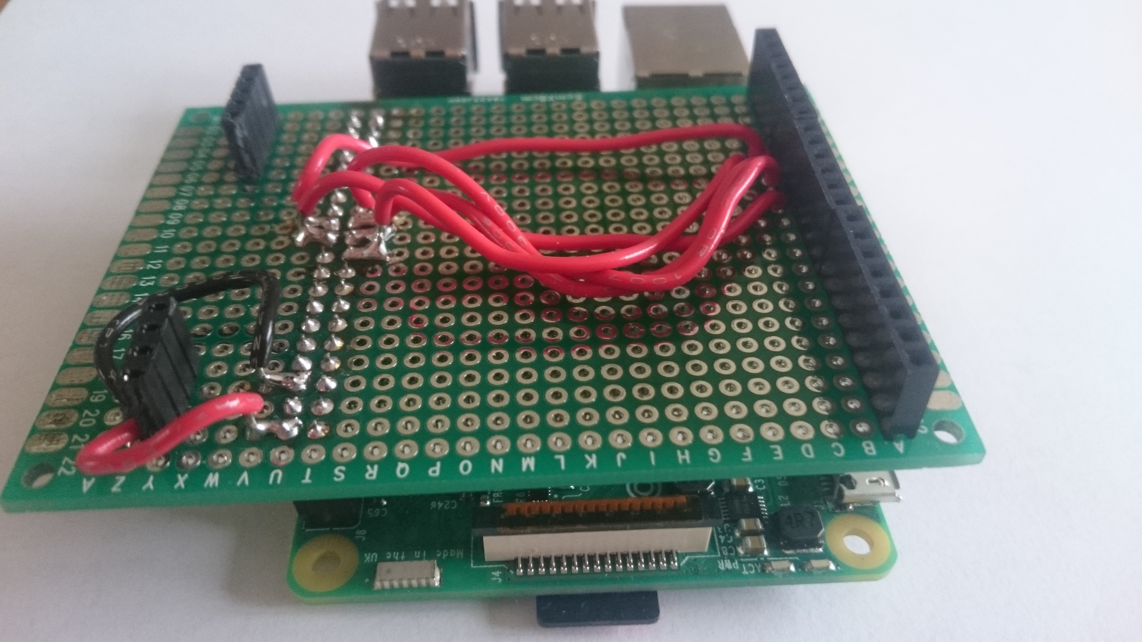

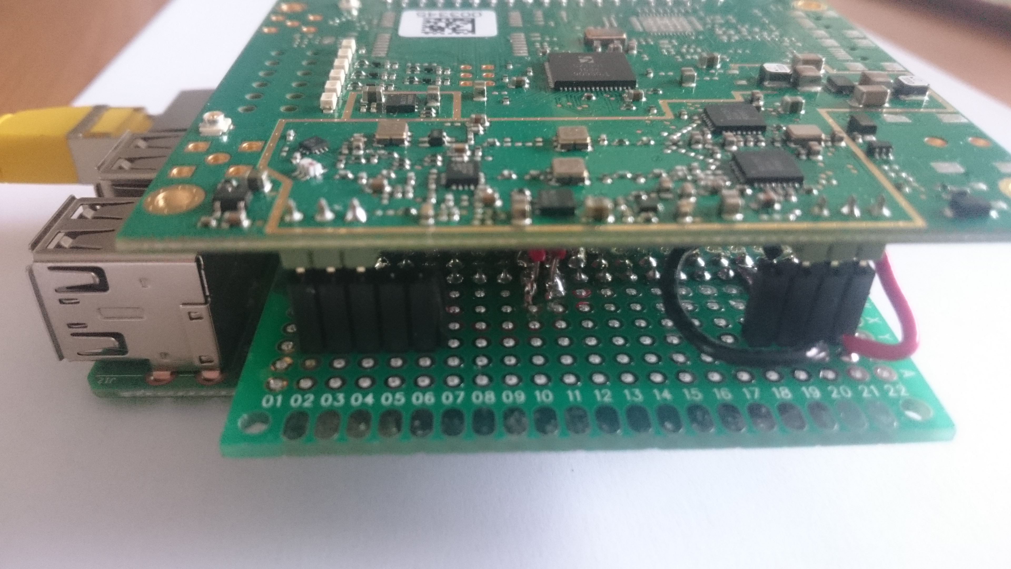

You can build a Gateway with a Raspberry Pi and iC880A-SPI in a IP66 case.
The costs are around 250 Euros.

This was my shopping list
The iC880A-SPI concentrator is the most expensive part 155.- Euro at https://webshop.ideetron.nl/iC880A-SPI
Raspberry Pi 40.- Euro
Antenna + pigTail kit for use with LoRa 10.- Euro
Protoboard and Male/Female headers (connecting Raspberry and iC880A) ~5.- Euro
IP 66 case Schneider Electric Thalassa 40.- Euro
2A power supply from my mobile mobile phone

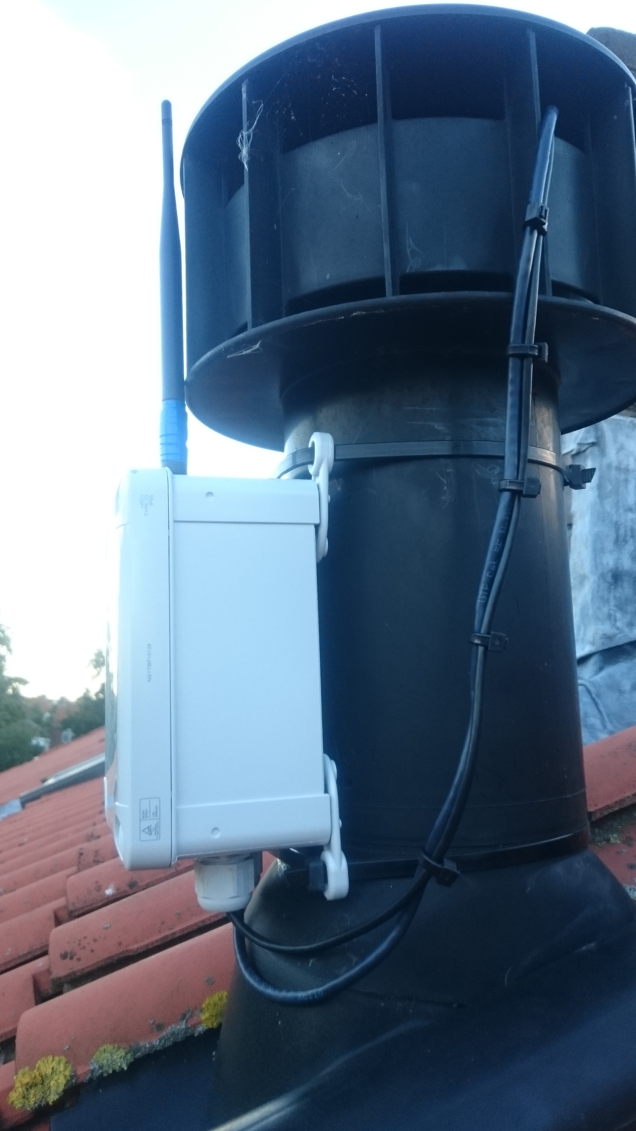

I just took a look and it is an option. I’m of two minds now, buy a gateway and put it in an IP box; or build the gateway in a box. It is not just a case of cost but environmental considerations. I’m concerned that box in a box may exacerbate condensation, associated damage and gateway lifetime. Am I unduly worried?
There is a really good story on building a Lora Gateway by @marcelstoer where he described his condensation issues and how he solved them. It’s also a really good build story. I am edging towards that approach pending answers from @johan @laurens on committed shipping dates and Ingress Protection answer.

@SmartEaling thanks for the nudge and the praise. For the sake of completeness here’s the link to my lab story: https://www.thethingsnetwork.org/labs/story/build-a-lorawan-gateway-for-the-things-network-my2cents Users left comments where we’re discussing options.
I’d definitely build a DIY gateway again because it’s fun and instructive. I learned a lot in different areas.

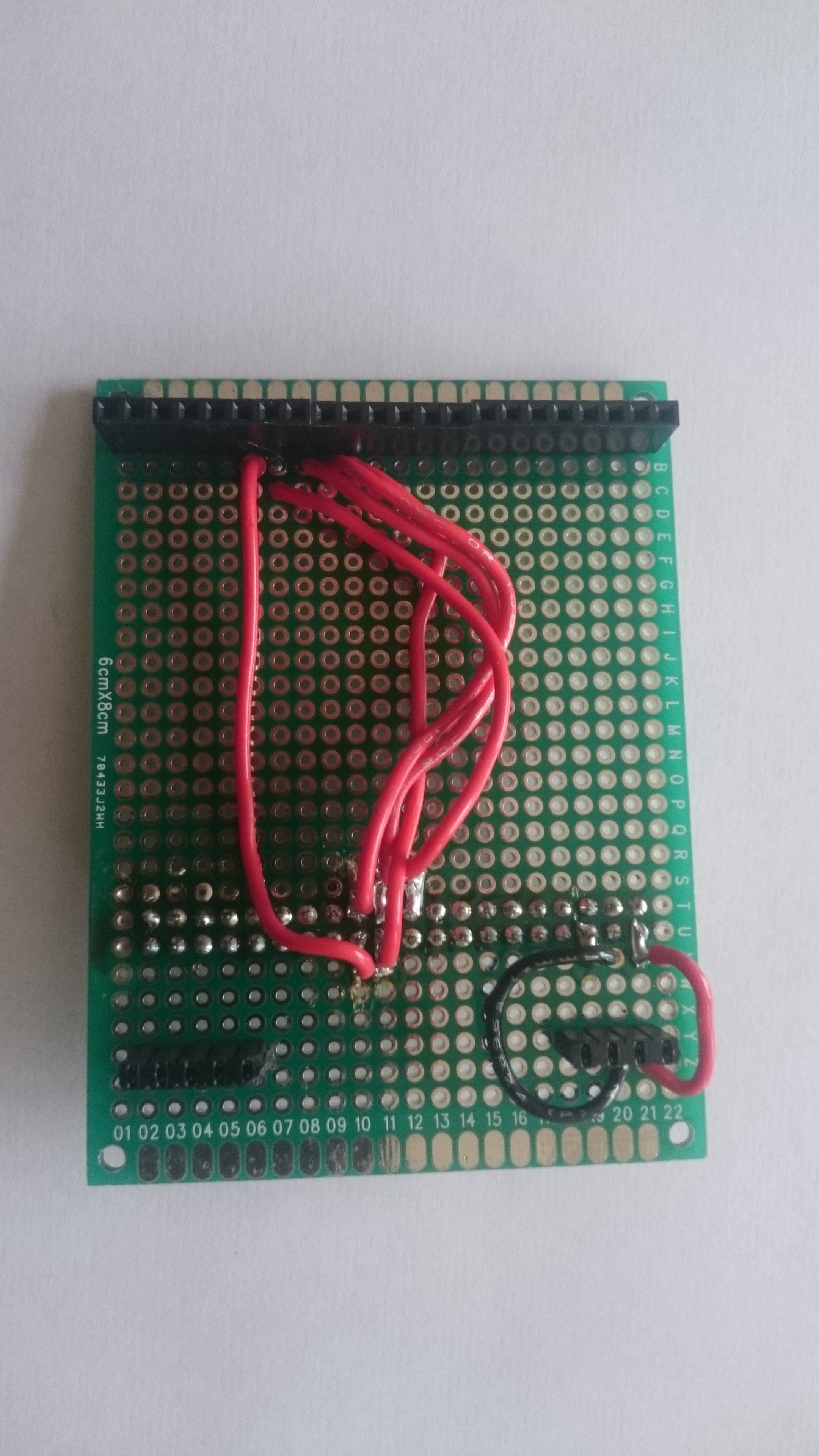

That looks very compact, no cabling inside. What type of adapter board did you use to connect the IMST880 PCB to the raspberry? Where to buy?
@PacificShore @Verkehrsrot there are different adapter boards on the market like the one @marcelstoer uses.
But you can easily build our own with a protoboard and some GPIO Header for the Raspberry Pi.
connect the right pins en your iC880A will fit nicely on the raspi.
I did follow this tutorial and I tested the wiring first with jumper wires on a breadbord.
