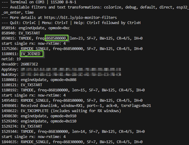

I found the issue with wrong band after further reading the documentation - as usual :rofl:
After adding the following additional buildsflags:
-D ARDUINO_LMIC_PROJECT_CONFIG_H_SUPPRESS
-D CFG_eu868=1
-D CFG_sx1276_radio=1
It keep going the right way:
