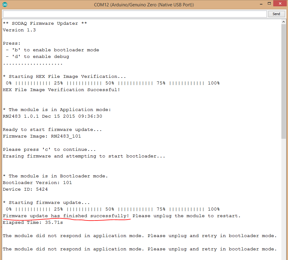

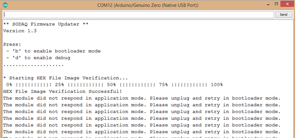

Thank you for this user-friendly method.
I’ve just tested the Firmware updater several times on a Sodaq Autonome but sorry, this doesn’t work for me, not in application mode, neither in bootloader mode.
Compile and upload was done without problems but the update process went wrong.

Hi Guys,
This upload program only works on Arduino boards with the SAMD chip.
We have developed the program for the SODAQ ONE. We have added the support for the SODAQ ExpLoRer and SODAQ Autonomo + LoRaBee in the next version. We will push it to our public github tonight.
@IoT_Marco
To let it work for the Autonomo we added the BEE_VCC pin to enable the power on the bee socket.
pinMode(BEE_VCC,OUTPUT);
digitalWrite(BEE_VCC,HIGH);
The program will NOT work on the Things UNO and NOT on the SODAQ Mbili because it is written for the SAMD chips.
@Mehradzie
Yes it works on both RN modules, but only when you use a micro controller with a SAMD chip like the Arduino Zero or SODAQ Autonomo.
If you still get the message: “The module did not respond”
Give the board an power cycle. Disconnect the usb cable for 10 seconds and re-open the serial monitor.

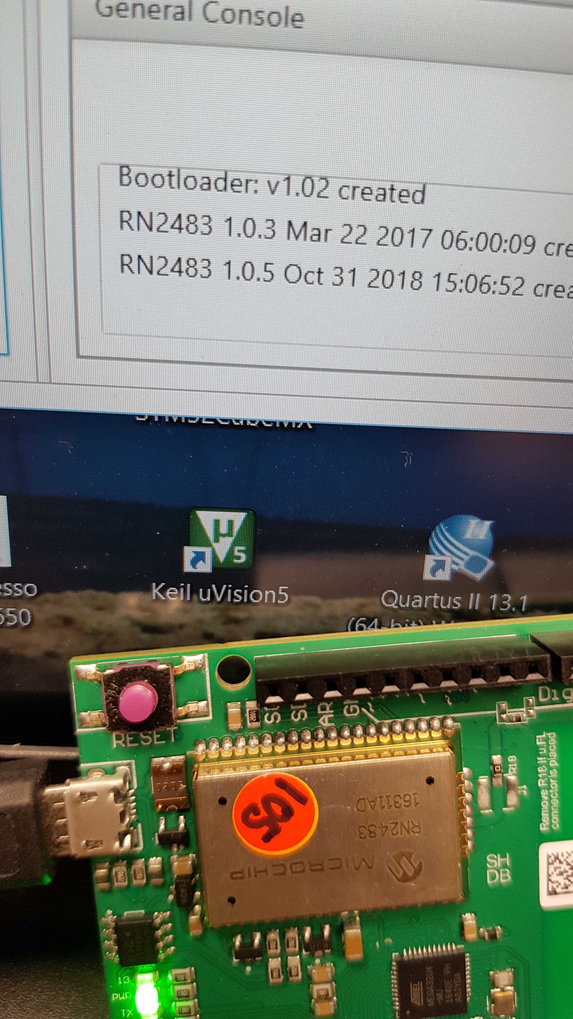

(Remko) #13
And another successfull upgrade:
44

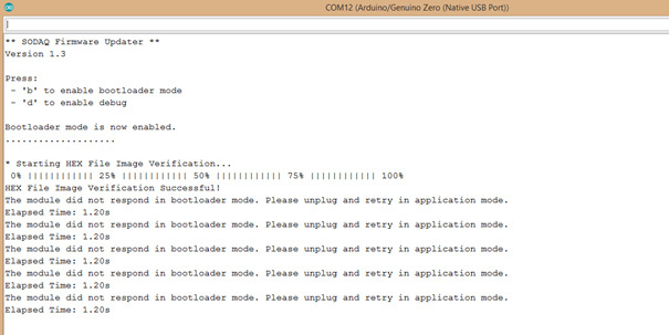

(Paul Stewart) #17
Unfortunately for this Sodaq Explorer it stalls and doesn’t go any further at “Hex file image verification successful!”
and in Bootloader mode I get the “Module did not respond” message.
I have an RN2903 module and trying to use HexFileImage2903AU_097rc7.h
Any hints to try?
cheers
Paul
#18
Hi @Paul_Stewart,
This is a known issue.
Update your IDE to the latest version and also the SODAQ Board files.
You may have to update to the new download url, see:
https://support.sodaq.com/sodaq-one/arduino-ide-setup/
Best regards,
Jan
