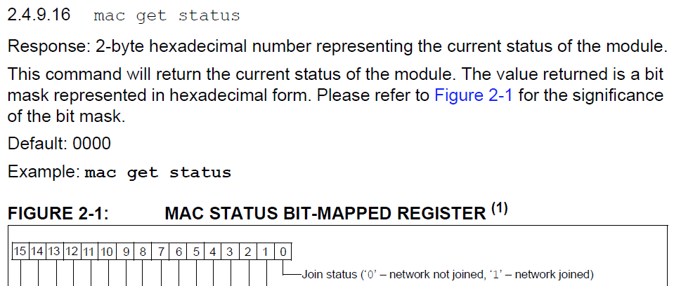

You have to use RN2483 commande mac get status, and check bit 4 : Join status (‘0’ – network not joined, ‘1’ – network joined)
look at
RN2483 LoRa® Technology Module Command Reference User’s Guide for more details
Best regards
that’s a good hint, thank you. But I mean it is bit 0.
Bit 4 is automatic reply status.
RN2483 mac status
be carefull, join status bit mapping is differente beetween versions , if before 1.0.4, join status bit is 1 for 1.0.4 or later it’s bit 4
