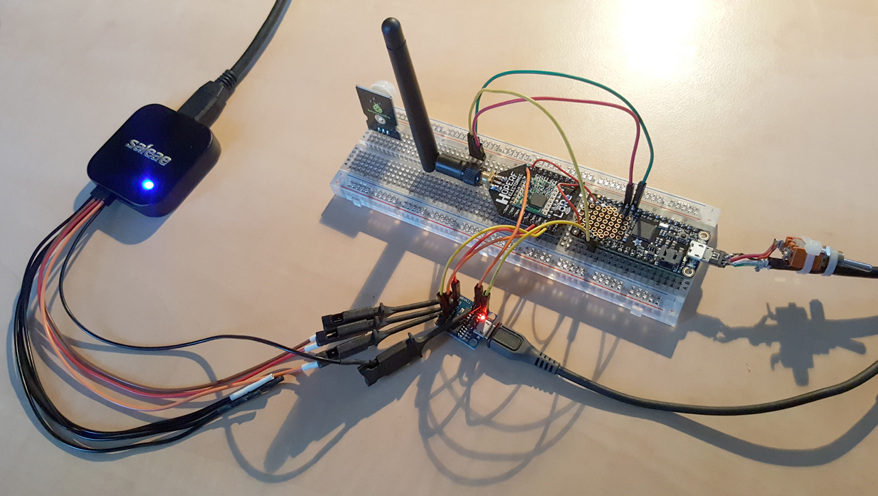

This is my test setup. I’m using a Feather M0 Proto for reference, and also for providing 3.3V for the ATtiny and the RFM95.
