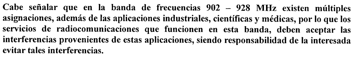

Hi Patricio, take a look at this document from the SubTel. Apparently it is clear for the SubTel that the 902-928 range can’t be considered as exclusive in any way, as: “many industrial, scientific and medical equipments are using it”. The Subtel also goes further and states that, “anyone operating in this band has to accept the interference that is now assumed to be part of this band”. This documents is dated March 2014… before the one you mentioned which is dated December 2014. In my opinion this is another demonstration off poor/lack government management around these “modern issues”, where first everyone is allowed to use a certain frequency band, and at the same time the government agency is tendering part of it. Certainly the worst part of it is the point where it states that: “is responsibility of the interested part in avoiding those interferences”, which clearly translates into cases like the one you mentioned, where one of the biggest telecommunication companies in Chile is demanding a home-owner for using some surveillance cameras at his home. Only in Chile…
Extracto_Resoluciones_14r_791

(Ignacio GĂłmez) #16
I just found the modification to the grant that is cited in the resolution here. Similarly to what @awagner cited, it states the following:
3. El uso de la bandas de frecuencia asignadas deberá aceptar la interferencia perjudicial resultante de aplicaciones industriales, científicas y médicas (ICM) que operen en la banda 902 - 928 MHz, conforme a lo dispuesto en la Nota 42 del Cuadro de Atribución de Bandas de Frecuencias, del Plan General de Uso del Espectro Radioeléctrico, aprobado por decreto supremo Nº127, de 2006, del Ministerio de Transportes y Telecomunicaciones, y sus modificaciones
I haven’t found something that refers to this decree, and as I understand it, it states that though there is a grant, they have to cope with use of the band by third parties. If someone can provide more recent information or any modifications to his or other decrees, that’d be great.
(Felipe Astroza) #17
I saw that but the fact is Subtel from 2014 [1] is asking to stop transmission on 902.1-912.1 range. What I don’t want is once we are deployed a network along chilean territory someone comes to us to stop the project. There is a preceding complaint and resolution from Subtel, what could be different in our case ?
Would it be a good idea to ask directly to Subtel about this misunderstanding ? o maybe, meet to AUTOMOTRIZ PETRIC to know how they handled the requirement.
just in case, we still have two available plans AU915 and AS923 to evaluate
[1] http://www.subtel.gob.cl/transparencia/Perfiles/Transparencia20285/Normativas/Oficios/14oo_13939.pdf
(Ignacio GĂłmez) #18
I think that’s the key. We have no problem with switching ranges, but it’d be good to know if there are real limitations or not, since everything we’ve seen dates from 2014. Who’s to tell that later on they don’t grant another range to someone else and we must keep switching? Are they even able to do that? What could we as a whole community do against it? Those are the things that concern me if indeed that range is banned for our use.
Anyway, we’ll let you know if we find anything else.
