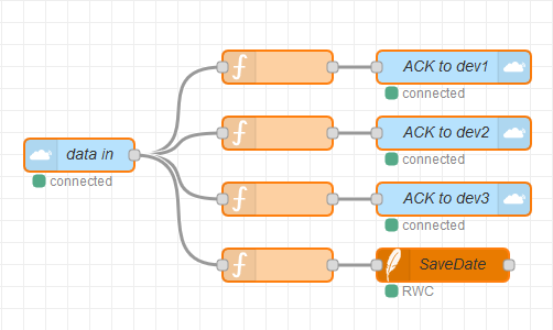

These 3 node assemblies does the same thing only in the end they send ack to the different device. So what i wanted instead of creating loads of those somehow to be able to pass device id to the downlink node and use the same one for all the data coming in.
Sorry, but providing a screenshot of the icons doesn’t show us that the configuration of the nodes is so I’m unable to suggest how to proceed.

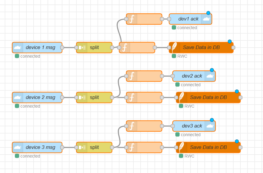

Ok i was able to reduce the number of nodes slightly but when number of nodes will be 100 or so its still a lot.
Code in functions which connects to ACK to dev1, 2, 3 is as follows
var newmsg = JSON.stringify(msg.payload).substring(19,22);
var ID = msg.dev_id;
if (newmsg === "JC/"){
    if (ID === "device1"){
         return { payload: "01"};
only changes device1 to equivalent device.
the last function only prepares data to be saved i database
