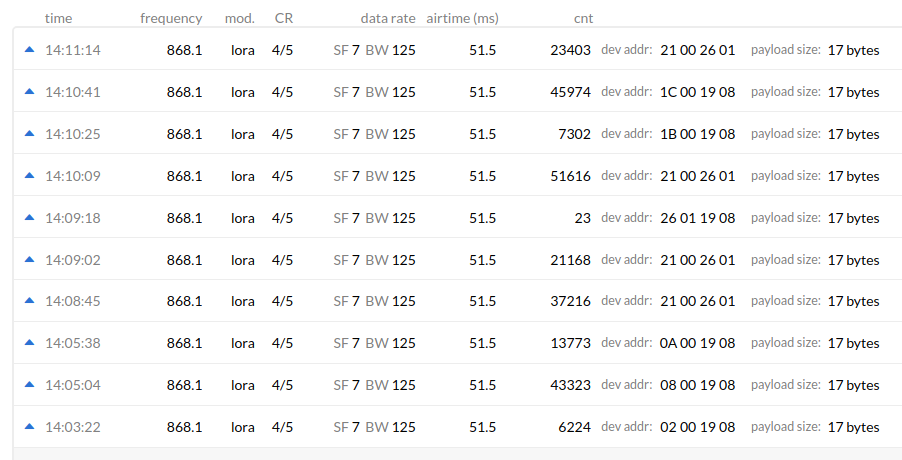

Got a singe channel gatway based on the lorago dock up and running.
wanted to use the internal sensors to display some data.
got not get that working :frowning_face:
The is data send to ttn i see payload dont know what to do with it and dont know what it is,
anybody got some experience with that ?
