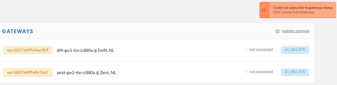

Hi all,
I can confirm, two ‘old-type’ gateways using ‘router.eu.thethings.network’ are also reported down by the TTN console. I think we did not change and/or break anything.
In the console both are reported as not connected with a ‘NOC connection time-out’ error see screen dump.
Logging on gateways seems fine with a PUSH /PULL ACK received see:
Mar 23 22:00:55 gw1 ttn-gateway[715]: JSON up: {"stat":{"time":"2017-03-23 20:59:55 GMT","rxnb":1,"rxok":1,"rxfw":1,"ackr":100.0,"dwnb":0,"txnb":0}}
Mar 23 22:00:55 gw1 ttn-gateway[715]: INFO: [up] PUSH_ACK received in 47 ms
Mar 23 22:00:55 gw1 ttn-gateway[715]: INFO: [down] PULL_ACK received in 40 ms
Mar 23 22:00:55 gw1 ttn-gateway[715]: INFO: Disabling GPS mode for concentrator's counter...
Mar 23 22:00:55 gw1 ttn-gateway[715]: INFO: host/sx1301 time offset=(1490299095s:858225µs) - drift=-43µs
Mar 23 22:00:55 gw1 ttn-gateway[715]: INFO: Enabling GPS mode for concentrator's counter.
Mar 23 22:00:55 gw1 ttn-gateway[715]: ##### 2017-03-23 21:00:25 GMT #####
Hope this helps the ‘back-end’ people. (if not let me know)
