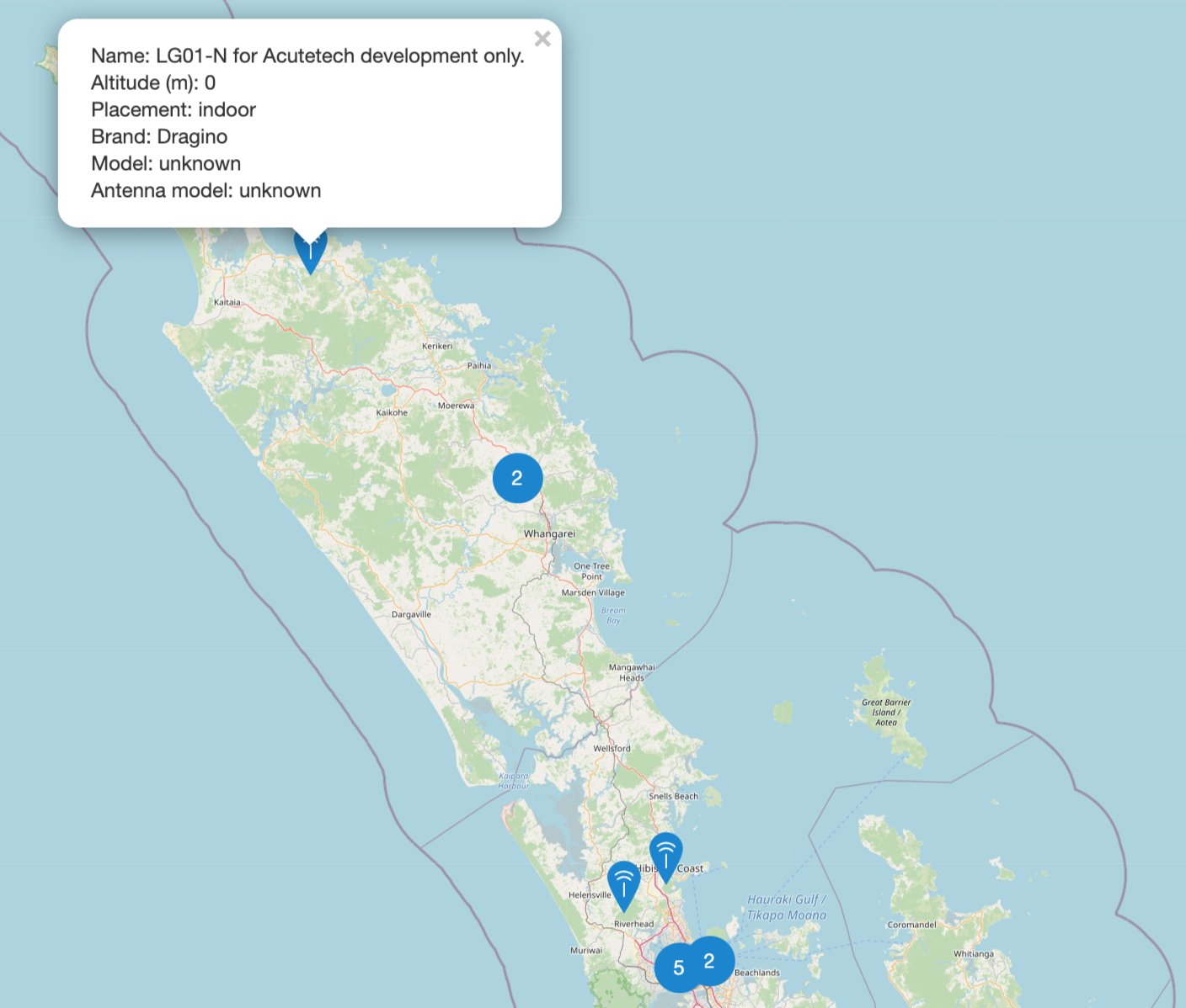

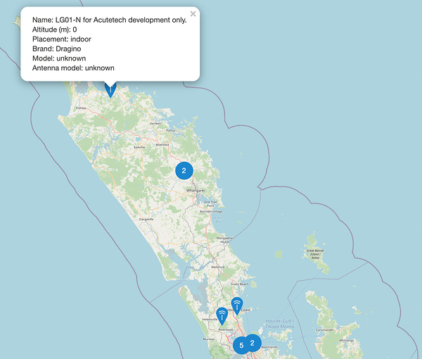

Please note that LoRaWAN devices or the TTN network servers cannot read the description you added. If your single-channel forwarder happens to receive traffic from TTN devices that would normally only be received by the other gateways (or TTN gateways that are not on the map), then you might very well be disturbing their operations. Remember this is long range radio.
