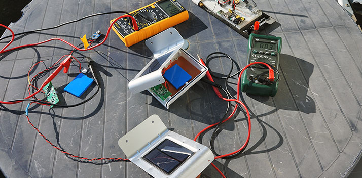

they finally arrived and are charging @ the moment – (will be continued and tested)
quick update
  • yes you can use them as a case/solarpower source for a node (lipo 3.7v/900mA intern) and enough space
  • found another seller with a newer version
Nice cases! The carton as well :wink:
Did you take Energy Harvesting May Break LoRa, SigFox LPWANs (that you posted yourself) into account when choosing those solar panels?
I am in the process of testing this very small step-up/ step-down voltage regulator S7V8F3 Pololu 2122
connected to a lipo… if the voltage drop to, let’s say 2.9 v… you still have 3V3 available.
And if your charging your node @ 4.2 V it can continue working @ 3V3.
Found it in one of my favo online shops (NL) and will write about it some more next week.

Yes the same package for me :wink:
read the manual before putting it in the sun for a whole day :wink:
you need to switch it on first with a small metal pin.
Sure…:wink:
hello Sun … exactly what I need :sunglasses:

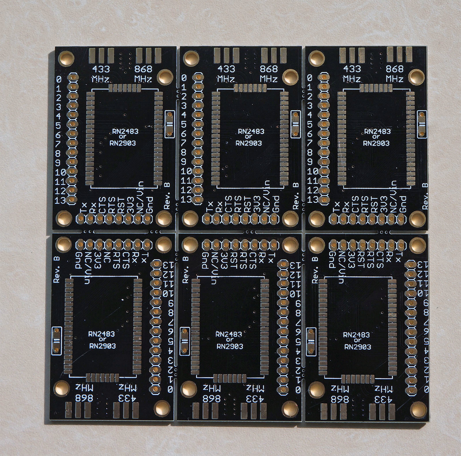

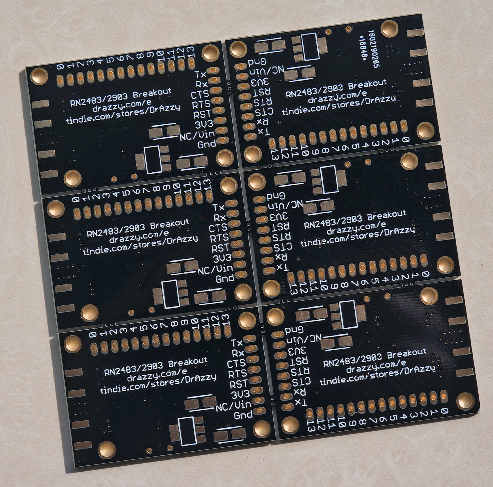

The new Dr.Azzy RN2483 breakout boards arrived and they look great ! :grinning:
