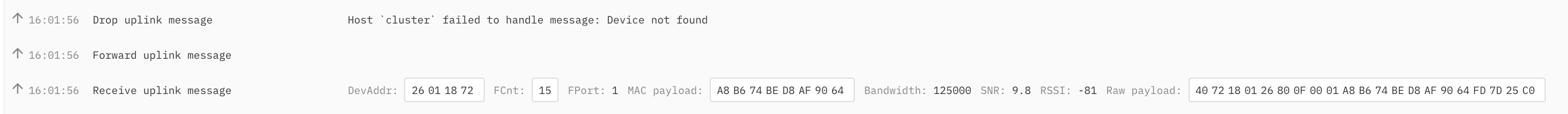

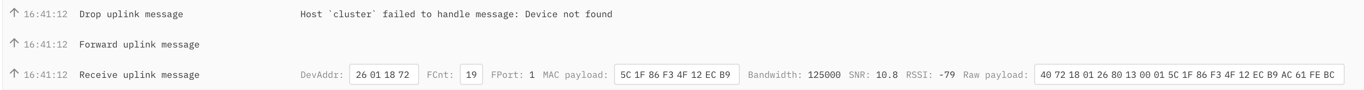

All i did on my end device was reseting via the RST pin, and it started working for 3 messages, i reached counter around 15/16 and it suddenly stopped working, then started working again for 3 messages, then again device not found for the next 5 messages, as example this node:
it reach fc_cnt 15 failed, device not found
10 min later, at next call from the same node, fc_cnt 16: worked :thinking:
30 min later, another device not found from same node ( it worked for 17 and 18)
When it fail i get this error:

I noticed i was missing always 5 messages in a row, then was receiving fine for 3 message in a row etc…
so by looking at frequencies, i noticed that it always work when received on those freqs:
868100000
868300000
868500000
and always fails from those freqs
867100000
867300000
867500000
867700000
867900000
I’m running out of idea and will probably migrate everything back to ttn v2 if not, but im asking if maybe anyone of you have any clue where to start searching ?

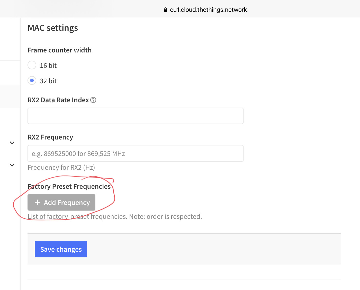

For ABP devices you need to tell the V3 stack which frequencies have been preprogrammed into the node apart from the 3 mandatory frequencies.
The dialog for this can be found in the advances network properties. You will need to reset the frame counter for the new settings to become active. Search the forum for instructions on how to do this with V3,

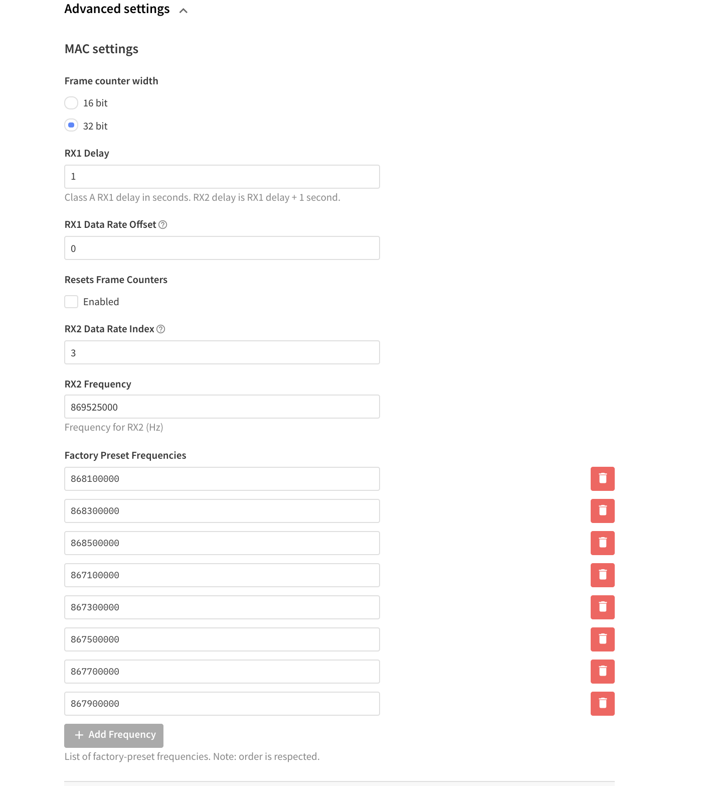

Thanks a lot for your response :wink:
Nevertheless, i already did that as it was part of the tutorial mentioned above.
Here is my console :
Screenshot 2021-05-11 at 22.13.10
i also did reset the frame counter ( i mean i just checked the checbox reset frame counter), it started counting at 0 again then i unchecked it , or maybe you mean running this command instead ? :
ttn-lw-cli end-devices set [application-id] [device-id] --session.last-a-f-cnt-down 0
I added those frequencies after having set up the node config though, should i recreate the whole node config and add them during first time configuration ? Does the order also matter ? meaning from lower to higher ?
Thanks a lot :slight_smile:
The order is not important, however the V3 stack needs to be forced in starting a new session. The easiest solution would be to add the device again with the addition frequencies. There should be other ways which may find on the forum, O recall having seen messages on the subject.

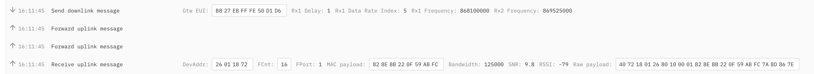

Alright, so reset the frame counter and making a hard reset on the node worked, now all my node report every 10 min just like old good v2 times. Migration to v3 100% complete. AwEsOmE !!!
Thanks a ton for your help :wink:
