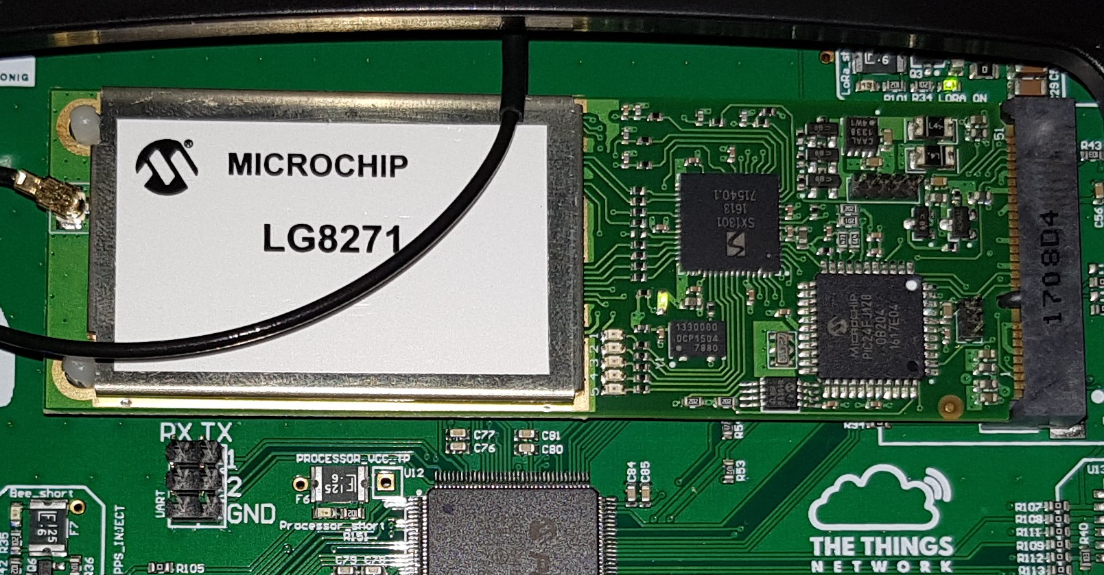

could it be the card connector inside ?
heat/cold/heat/cold … if its a bad or loose connection.
remove and then place back the card (push in firmly in the connector.

Just to say… it could be just one part in the GW base board/lora card , difficult to debug.
Indeed make sure you’re connections at that location are 100% (maybe test with another GW)
open the enclosure and use a hairdryer to heat the board/components a bit … see if that does something ?
Now even more bizarre. Tried all suggestions. Gateway would come up and then go down. So I decided to try the other (unused gateway) and start from scratch. This one will not connect at all. I have tried latest stable and beta firmware. This is what is coming out of the debug port … can anyone tell me what the problem is? The first two leds are solid, the third slowly flashing. This goes on for a while until an automatic reboot and then into the same state.

any changes in the network / router / firwall rules ect. ?
that second ‘new’ GW… was that working before on another location/network …
Nope, no changes to anything at all on the network side. And the gateway is completely virgin - never unboxed before! Totally perplexed. Wondering if there is something rogue on my network that ONLY affects these TTN gateways – there is loads of other gear (incl other gateways from Sentrius, ic880a, RAK) that work fine!!
well, I don’t know IF its related, but there also backend problems today.
Can you move , a working, not virgin, other GW to that location ?
I had similar issues and tried to resolve it on the node side. But since there are currently massive problems on TTN side (see the thread on broken gateway-app communication) it might be as well a TTN issue. I would wait for these issue to be resolved to see if things become stable again.
Best,
Niels
Looking at your debug report you don’t have problems with WIFI:
CNFG: WiFi SSID: M2M-UNIFI-UAP-AC-M
The gateway is getting an IP address:
WIFI: IP Address: 192.168.1.219
Debug Reboot reason: 0x40
It’s failing several times trying to configure LORA:
LORA: Configuration failed, retry
LORA: Starting reconfiguration
I would query what Reboot reason: 0x40 is.
Its failing to configure LORA.
Thanks for all of the support - I wonder if it is a combination of the TTN side issues, some flakey hardware my end and/or some diagnosed horror on my local LAN/WiFi network?
I updated the original gateway with the develop firmware branch and it is behaving better. It joins, stays up for a while, then gets unhappy but manages (so far) to re-join. I’ll try to capture all of the debug messages to see if I can figure it out.
The other (virgin) Gateway just refuses to play ball. I installed the same develop branch firmware, but I just cannot get it activated via the ttn.fyi/activate procedure. Mystery!
Both of the Gateways are now online. For now. I really have no clue about the original problem, but I do have a feeling that the LoRa daughter board was not properly seated in the 2nd (virgin) gateway - hence the LoRa errors in the log. They are a devil to get out and I end up snipping off the plastic supports and having a real wrestle with the double sided foam. I am going to have to find a way of re-securing properly. I have a feeling a small jolt will cause issues.
They are both on wired connections.
I’ll see how this pans out but to get to this point has taken more or less 7 or 8 hours of endless piddling about.
indeed… coincidence or not… the backend problems seems solved to :wink:
