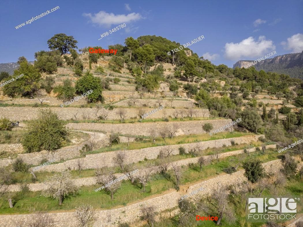

The location is like this.
May you recommend to me another approach that you think that fit better?
I would like to have only a getaway and all the sensors send the data with this getaway and the sensor need to send the data in a long enough range.
As this is the LoRaWAN on TTN forum, the approach is buy proper kit - like an 8 channel gateway - like the DLS08N (not sure if there is mobile internet for that) or any other compliant gateway you can find using, as suggested, the search on the forum.
However the laws of physics apply to all radio systems, so your terrain will introduce a universal problem. If a device is near a wall at the bottom of the hill and the gateway is at the top (gateways high up are good, but it leaves an immediate dead-zone right underneath), then the device may not be heard, even if it’s only a few hundred meters away:
7ae3fa91a8f941799b54a1828324eca348595237
Ideally you want gateways on the top of each of those stacks surrounding the devices, so the device on hill A is heard by gateways on hills B, C & D, but not likely to be heard by the one on the same hill.
