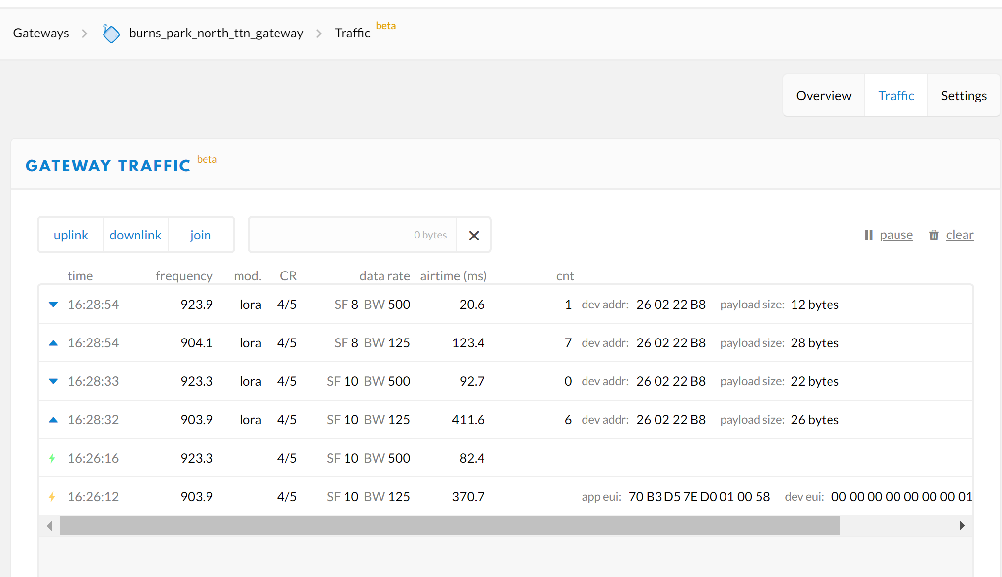

Looking at your first logs I observe the following:
  • Things Uno does a JOIN REQUEST on SF10BW125. JOIN ACCEPT received on SF10BW500.
    It does the join request on SF10BW125 and not one of the lower spreading factors.
    Is this US / 915MHz specs or a ‘feature’ of the Things Uno / RN2903 (sketch)?
  • After Things Uno receives the JOIN ACCEPT the first message is transmitted on SB7BW125. How does it know to transmit on SB7, is this ADR already ‘kicking in’ embedded in the join accept? is this US / 915MHz specs? or is this a feature of the Things Uno / RN2903 (sketch)?
  • The Arduino Uno starts its JOIN REQUEST on SF9BW125, not SF10BW125 like Things Uno and JOIN accept is received on SF9BW500.
    Why does it start the request on SF9BW125 while Things Uno starts on SF10BW125?
  • Arduino Uno starts it first message on SF9BW125, which is different from Things Uno.
    After first (uplink) message a downlink message is received on SF9BW500. The next message is sent at SF7BW125, so apparently this is ADR kicking in. A separate downlink message appears to be used for this, that downlink message is not visible in the log for Things Uno.
  • After the second uplink message another downlink message is received (at SB7BW125). What is it for? Maybe another ADR related message to adjust the power?

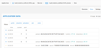

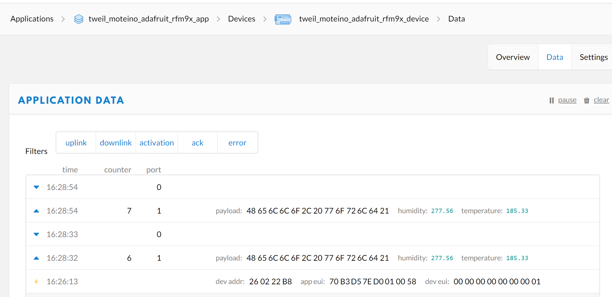

  • Frame counter starts at 109 instead of 0.
    The time lapse between JOIN ACCEPT and the first message visible (frame 109) is around 30 minutes.
    With around 1 uplink message every 20 seconds that whould be about 30 x 3 = 90 messages which comes close to the frame count 109.
  • Message with framecounter 109 appears to be the first message that is successfully received on the backend, because you see ‘almost directly’ appear three downlink messages after that which are probably ADR related. With Arduino Uno these downlink messages came ‘quickly after’ the join accept so it is plausible that the backend sees uplink message with framecounter 109 as the first successful uplink message (which is an assumption).
  • Once ‘the flow has started’ everything appears to continue normally.

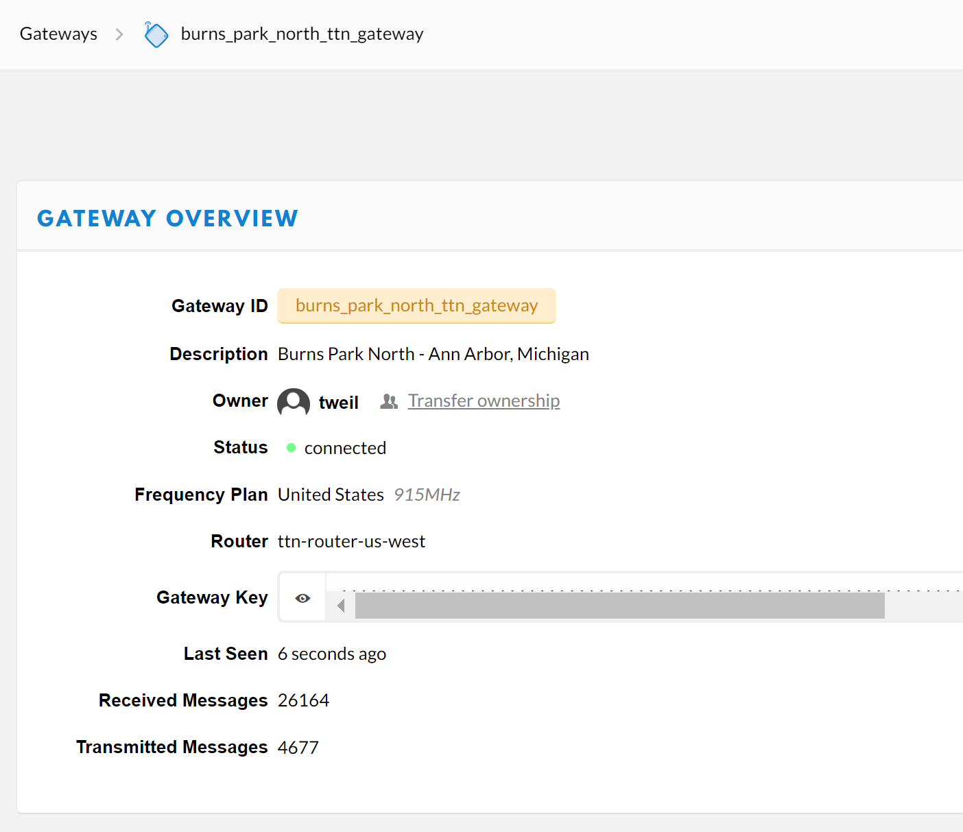

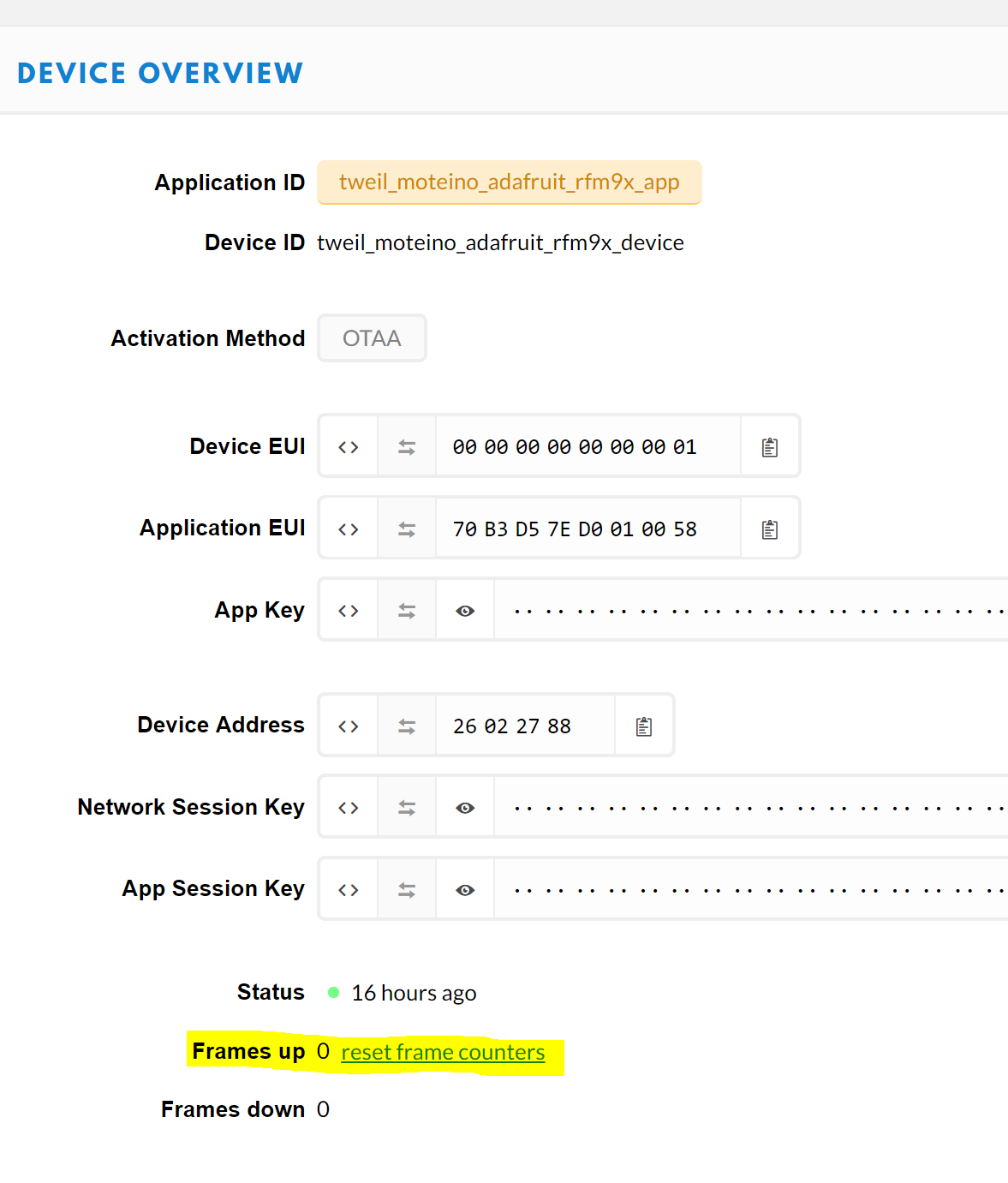

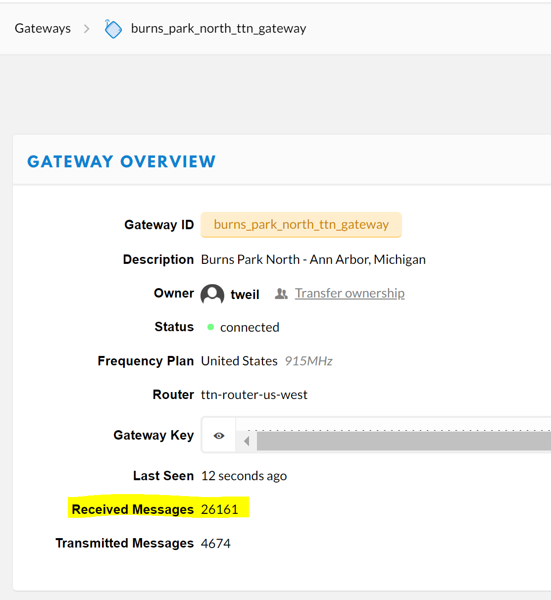

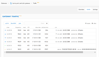

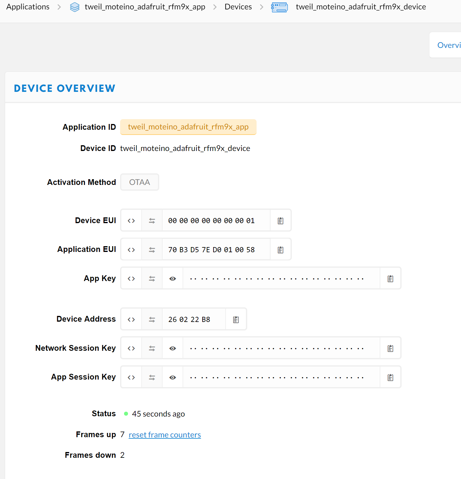

  • What do you see happening in Console Gateway Overview in the received messages counter, does it increment between the Moteino’s JOIN REQUEST and sending the ‘first’ uplink message (framecounter 109)?
  • Similar for Console Device Overview.
    What do Status , Frames up and Frames down show between JOIN REQUEST and transmitting the ‘first’ uplink message (framecounter 109)?
In the Arduino Uno? and Moteino node logs the join requests appear to be starting at SB7BW125 and then the spreading factor is gradually increased. This is not visible on the console logs but is probably because you have not included the failed join requests in the console log screendumps()?
This at least explains the behavior of and the difference between Arduino Uno succeeding the join at SF10BW125 and the Moteino succeeding the join at SF9BW125 (they both started joining at SF7BW125 but it is just not visible on the Console screen dumps).
This (failing to join at SF7BW125) behavior with Arduino’s and LMIC is normally fixed with relaxing LMIC timing.
It does not explain why Things Uno initally joins at SF10BW125 (which the directly switches to SF7BW125 when transmitting its first message).

The Console Gateway Overview in the received messages counter does NOT increment between the Moteino’s JOIN REQUEST and sending the ‘first’ uplink message
Gateway Overview Before JOIN REQUEST and Before any frames appear in Gateway Traffic or Application Data. Received Messages: 26161
Gateway Overview shows Received messages increased 3 after JOIN REQUEST and 2 successful frames (frames 6 and 7) appear in Gateway Traffic and Application Data. Received Messages: 26164
Console Device Overview before JOIN REQUEST and while waiting for Frames to populate Application Data: Frames Up/Down: 0
Console Device Overview after JOIN Accept and 7 frames received (counter 6 and 7)
I did not purposely not include failed join requests in the console log screendumps. Is there a way to make them visible? I tried to include as much as I could.
By the way, thanks so much for all the time you have put into helping me. Hopefully, we will all learn something.
Not a problem. The join requests will be visible in the gateway traffic log and when you then see a join accept but no transmit from the first message (‘directly’) afterwards then the node hasn’t properly pickup up the accept. This is what I call ‘failed join request’.
Your screen captures have confirmed what you already said and the symptoms are not normal, but I am running out of ideas.
