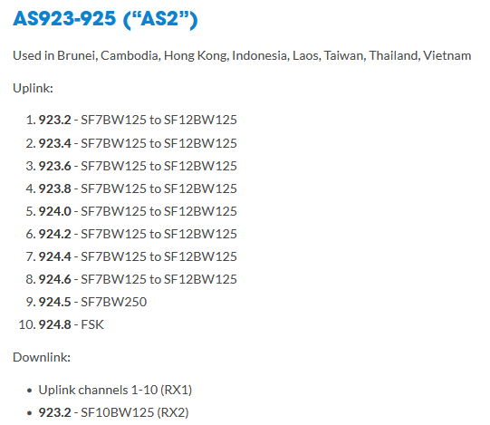

Check if the frequencies used in the uplink packets (as displayed in the gateway console) match the frequencies used by the device as set in TTN console. If not a 100% match the uplink will not be delivered to the application.
From the gateway uplink message, the data frequency json are either 924400000 or 924600000
According to the frequency plan for AS2, the frequency matches with data frequency received (point 7 and 8).
as2-frequencies

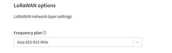

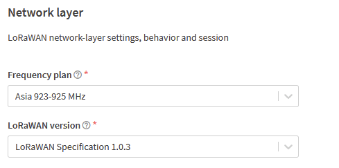

Have deleted and re-added both the device and the gateway. However, the same behavior of no downlink join accept and no registration of live data on the Application Device side. For reference, here is my settings:
On the TTN gateway side, the frequency setting
And similarly on the TTN Application device side
