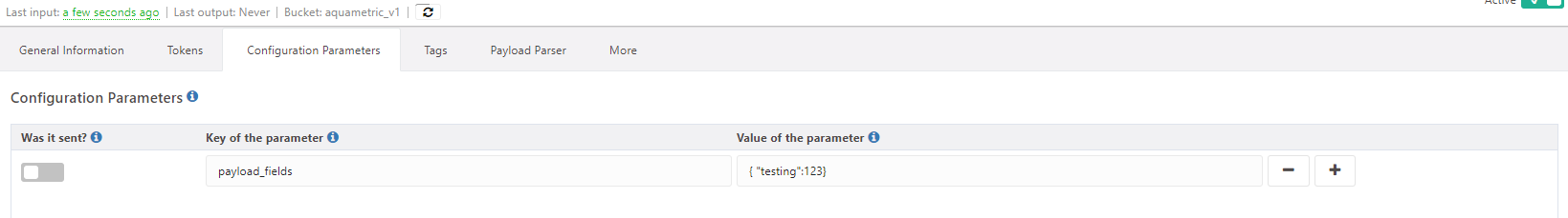

This is what Iâm trying to send:
Downlinks used show up in my TTN console on fport 0(they donât any longer for some reason) but the payload is empty every time, whether I use payload_fields or payload_raw.
Itâs also very non-intuitive how to actually send downlinks. The âWas it Sentâ tab is really ambiguous even after you read the information tab.
Do you enable âWas it Sentâ because you want it to be sent or disable it because it was sent.
When youâre creating a new key and value pair, youâd click the button because intuitively thatâs how you expect things to work but that will disable the downlink. I spent a TON of time trying to get downlinks to send my payload, then I just gave up
Once it works it would be nice to specify with fport it comes in on as well.

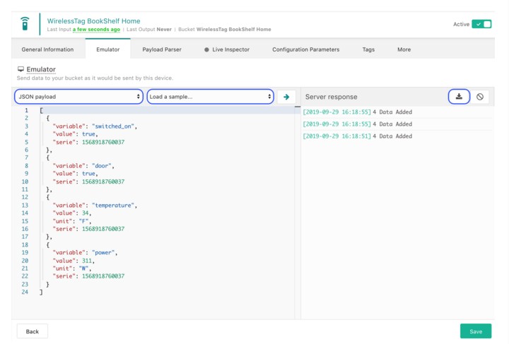

Check out the recent changes in the Device configuration tabs. Now you will find the Emulator inside each device, along with some format examples ready to be used. Developers can emulate data in two formats: JSON or RAW payloads. When using the new Live Inspector to monitor data traffic, users can navigate in any tabs without resetting the historical data of the main display. The Live Inspector is a great feature for debugging as it shows each package that arrives; it is also helpful for when you are creating parser scripts for the payload.
