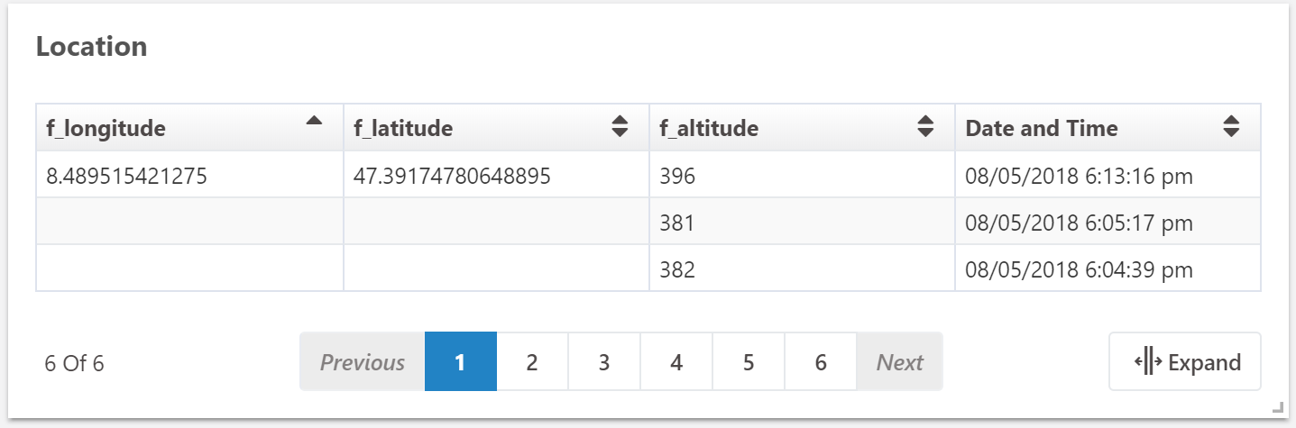

Longitude and Latitude appear in the table:

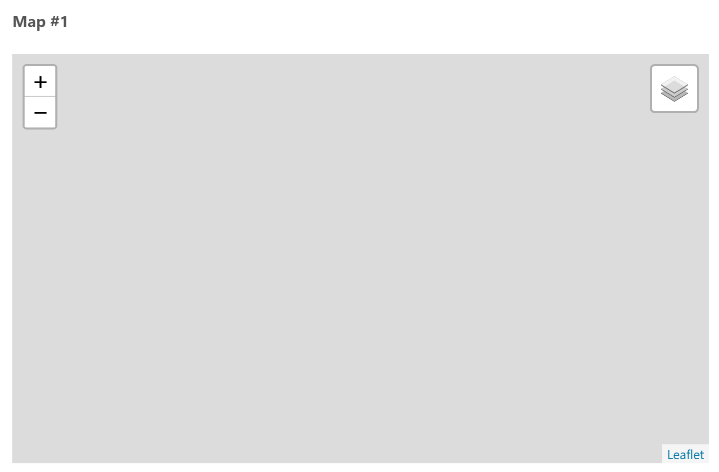

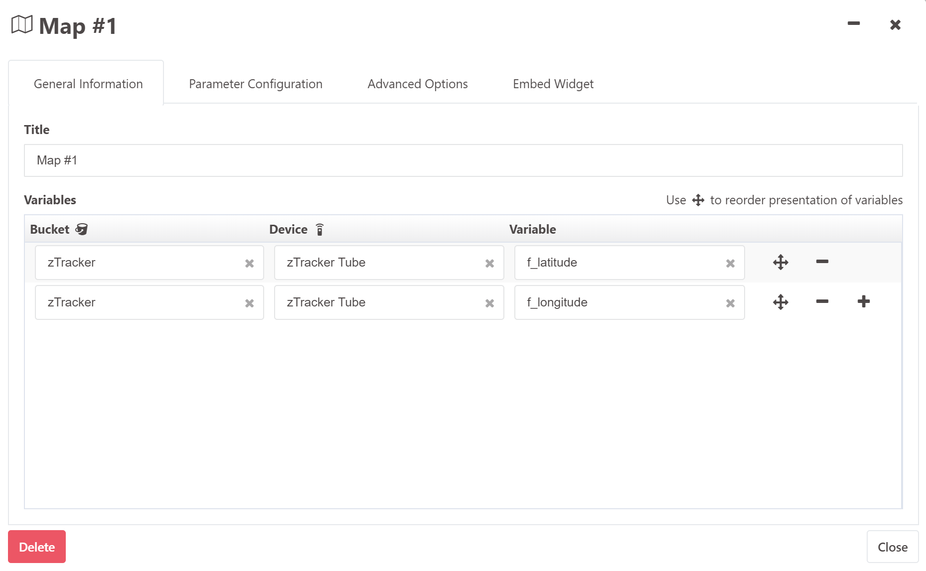

However, the map stays empty when configuring the diagram:
Result:
Does anyone know, where my thinking error is?
@rcanoff ? :sunglasses:

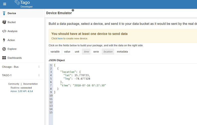

Hello @lombi The problem is that the map is expecting the latitude and longitude in a different key of the json, something like this
  "variable": "any_variable_name",
  "location": {
    "lat": 42.2974279,
    "lng": -85.628292
to do that you would have to create a conversion for this value.
You could follow our parse tutorial, and instead of parsing the data, just build the json with the location key.
Link to the tutorial:
https://tago.elevio.help/en/articles/118-parsing-raw-payloads-into-actual-values
you would have to change a few things, instead of getting the raw payload, you can get your latitude and longitude and instead of doing some calculation, just put them into one variable

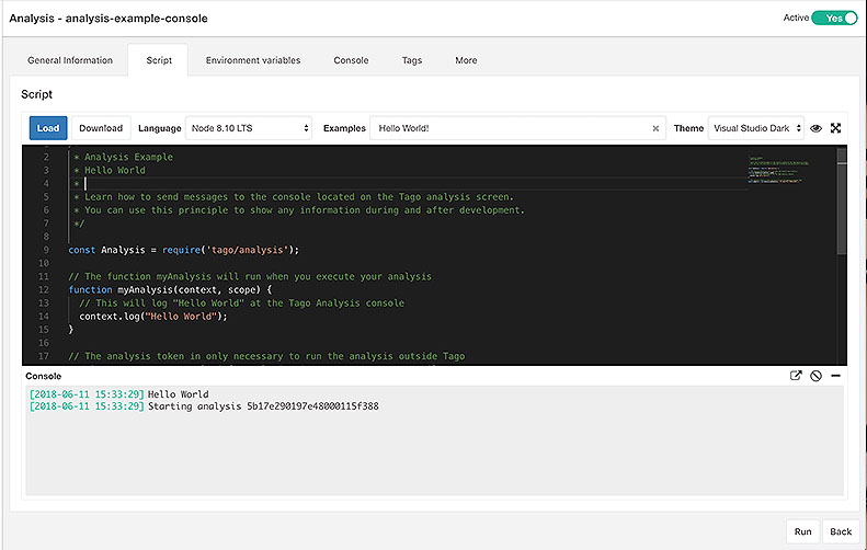

Thank you for the link. I used the tutorial and built something that works. It’s probably not very sexy, but it fulfils it’s purpose. Here’s my solution:
 * Analysis Example
 * Generic Payload Parse
 * Learn how to parse from a hexadecimal raw payload into temperature and humidity variables
 * Tutorial: https://tago.elevio.help/en/articles/118
const Analysis = require('tago/analysis');
const Device = require('tago/device');
// The function myAnalysis will run when you execute your analysis
async function myAnalysis(context, scope) {
  // Create a variable called payload with the value sent by the device
  const latVal = Number(scope[12].value);
  const lngVal = Number(scope[13].value);
  const port = Number(scope[8].value);
    if(port == 204){
      const variables = {
            variable: "location_action",
            location: {
                lat : latVal,
                lng : lngVal
        // Instantiate the device with your device token
        const device = new Device('507b2b6a-1657-4e54-93b7-7f36956d2798');
        // Insert the actual variables temperature and humidity to TagoIO
        await device.insert(variables).then(context.log).catch(context.log);
// The analysis token in only necessary to run the analysis outside Tago
module.exports = new Analysis(myAnalysis, 'YOUR-ANALYSIS-TOKEN');
Thats very nice, one thing I would change as you have a lot of scope variables is to find the variable instead of using the position
something like this:
const latVal = Number(scope.find(x => x.variable === 'latitude variable').value);
