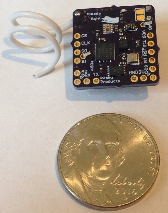

My latest hardware is the Adafruit Feather M0 with ICS43434 I2S microphone and BME280 environmental sensor. More details are discussed in https://community.hiveeyes.org/t/audio-acquisition-and-analysis-with-arm-cortex-m0-and-i2s-microphone/1530/94.

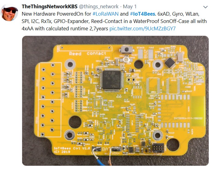

IoT4Bees
