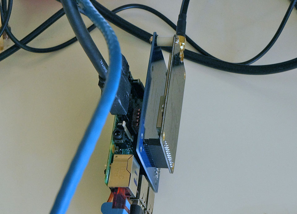

I have had some ā€˜unexpected reset’ problems.
The RPI was slowly heating the converter PCB which in turn heated the RAK.
Yesterday I mounted a copper heatsink on the RPI and rotate the setup 90 degrees so that the heated air could flow better.
Maybe coincidence, but I didn’t have the resets .
  • update - nope… still a problem but less
ERROR: [main] unintended SX1301 reset detected, terminating packet forwarder.
root@raspberrypi:/opt/ttn-gateway#
@ jezd - cpu monitor shows 0 % ?

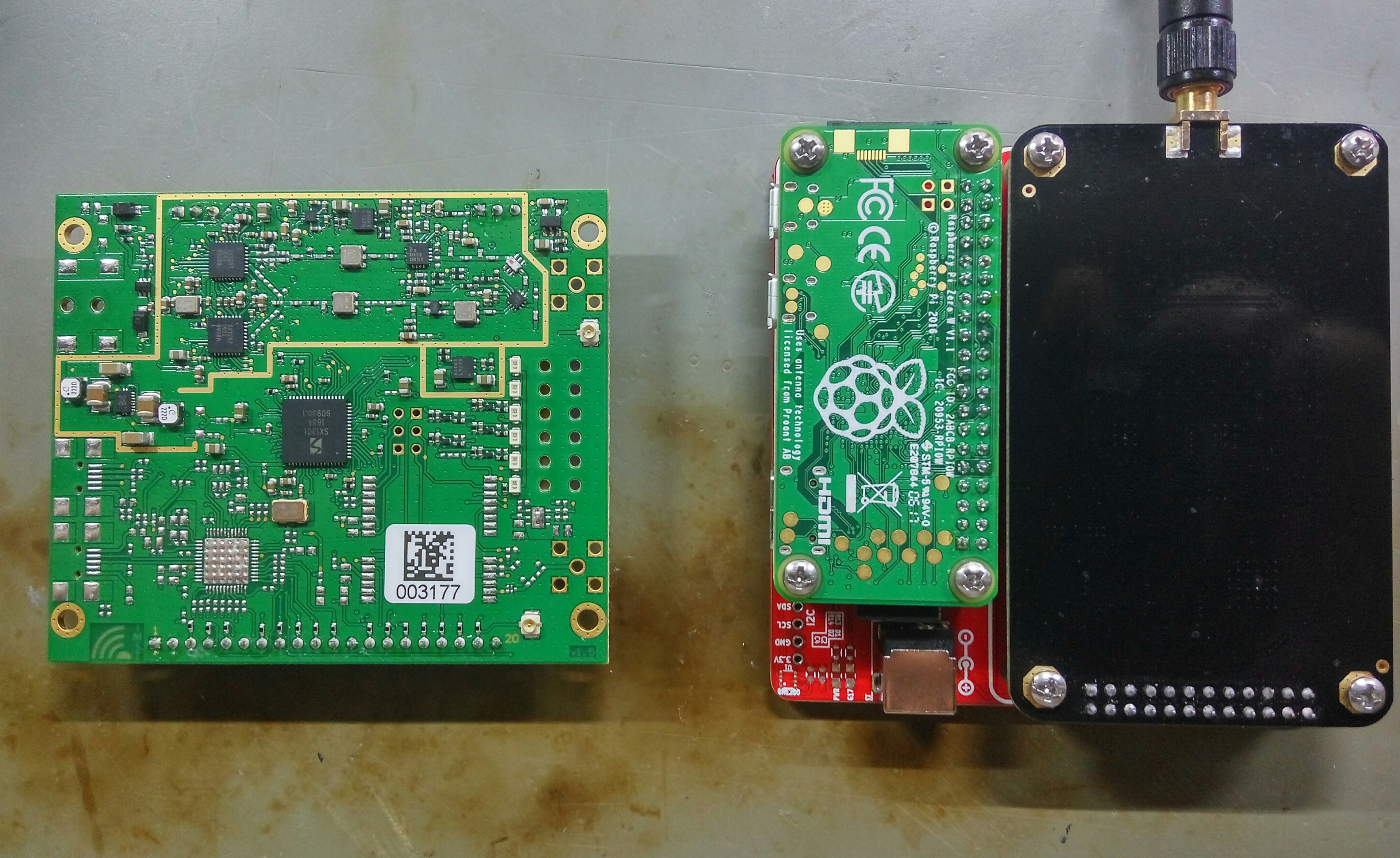

I’m now using Kilobytes new adapter board, includes BME280 sensors too - more stable than wires
I created a new Adapter Board for the RAK831! It fits an Raspberry Pi Zero and is on the bigger side just 1.5cm bigger than the IMST concentrator itself.
Available on Tindie: https://www.tindie.com/products/kilobyte/rak831-raspberry-pi-zero-breakoutbackplane/

@mfalkvidd If you need a solution which works out-of-the-box with e.g. the ttn-zh installer then you propably are better served with a Board from the community (They are compatible and/or designed for the ttn-zh installer). Also you get a quite big variation between different sizes/concepts from the community Boards. If that all isn’t a need then you can also use the RAK Board. You generally don’t want to use dupont wires unless you have to.
@admiral99 Meassured the consumption of my Pi3 RAK831 and Pi Zero W RAK831 Setup. Pi3 = 720mA, Pi Zero W = 490mA. Exact same SW, both connected via WiFi, RAK831 in ā€œRX Modeā€.
btw, I’m currently working on a new RAK831 Breakout Board which should be quite a lot more power efficient than the current Pi3 and Pi Zero W solutions… :slight_smile:
@kilobyte
Great, would you mind expose RX/TX with FTDI like. I’ve done on this one it can save us (even if with Zero we can have serial other USB) some pain when network config does not work first time.
It’s just a matter of wiring routing, won’t increase price :wink:
