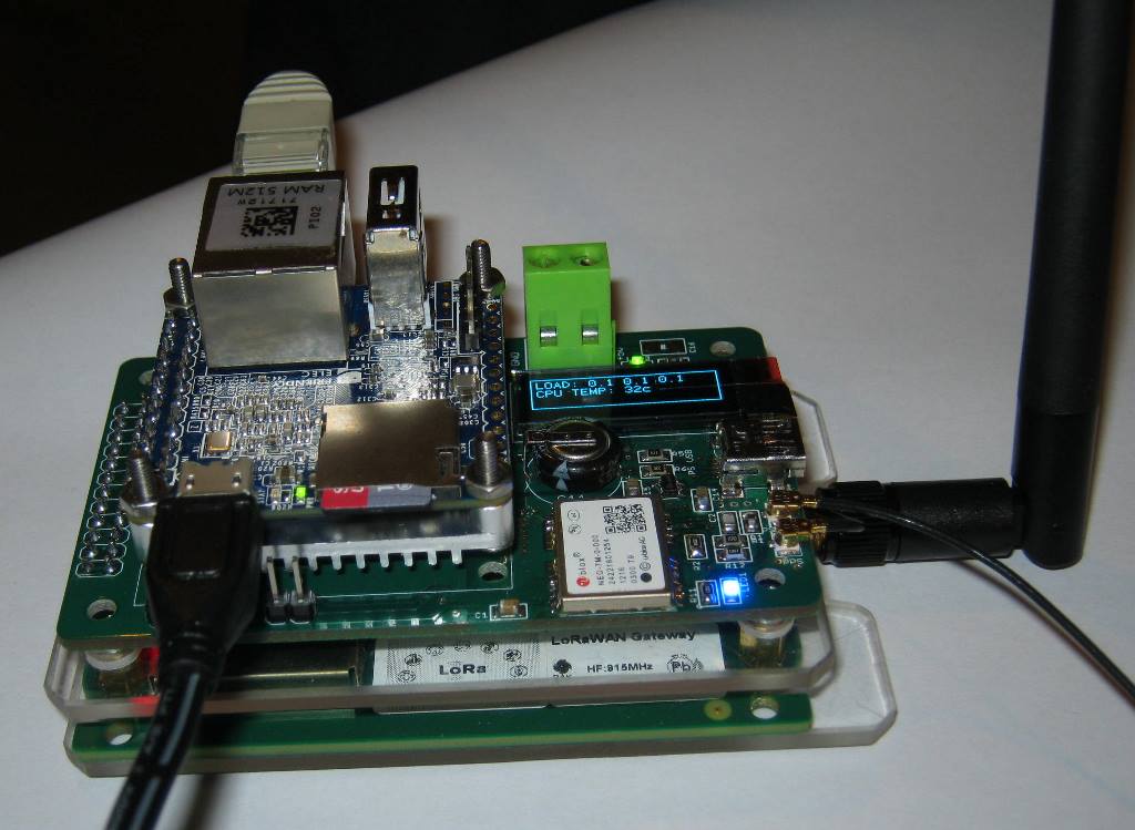

I’ve been led astray - The NanoPi Neo and RAK831.
Anyone interested is making one of these, the design files are here:
https://github.com/pcm52/NanoPi_Neo_RAK831
I have a few extra bare boards going free for anyone who is really keen and likes soldering 0805 sized parts.
Currently running this with AU915.

I love this one, thanks for sharing, I’ll try to add FTDI connector on the board and let it fit it on a classic enclosure. Many thanks for sharing
What distro are you using? Is it stable on nanoPI?
Remember it had some SPI issues, is it okay now?
I think new @kersing multi packet forwarder should works fine, need to be tried
I’m using Friendly Elec’s distro of Ubuntu 4.11.2.
Is it stable? - I haven’t run it for any long periods of time. So far so good.
I haven’t heard of any issues with SPI. Was that using the Armbian distro?
Yes, it needs testing with the new packet forwarders. I’ve stuck with the basic setup for now.
I think others have tested the NanoPi Neo with the new packet forwarders? - @Epyon?
Hi Olabec, I am also running a RAK831 with the NanoPi Neo - but without your wonderful interface PCB. I mention my setup here: - https://www.thethingsnetwork.org/labs/story/what-next-after-the-first-run-of-your-gateway - seems a stable configuration so far. Also, see my post in this topic on September 1st.
Running very fine and stable on a NanoPi Neo with the Armbian mainline kernel here
