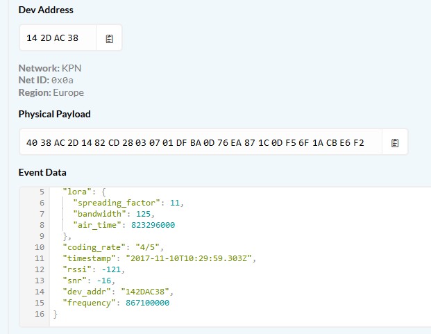

I received with RAK 831 @ - 123 db according to the console.
* searching for the screenshot
couldn’t find it off course but made a new one just now … -121 db very good
and that’s with an indoor GP antenna
