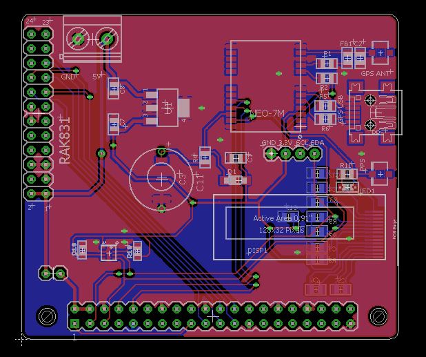

Also working on a ā€œPi-RAKā€ too. Rather than mounting the board upside down (Spacing seems a bit tight ) I thought of mounting the boards end to end and adding GPS and OLED options. 128x32 OLED on board or the usual 128x64 modules through header pins, BME280 too rather than monitor core temp. GPS USB is not really needed.
Still work in progress. All components on board are entirely optional of course.
Wouldn’t it be very hard to get to the sdcard slot with the RAK831 module at that side? How about positioning the RAK831 next to the RPi I/O connector?

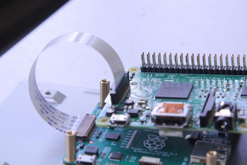

If you use an adapter ā€˜hat’ (or another hat) … is it then still possible to use the display connector ?

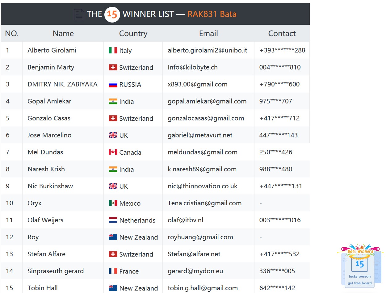

I see some names I recognize… congrats RAK contest winners :sunglasses:

That depends on the design of the hat. For official hats the answer should be yes, however I don’t think any of the current designs meets the official ā€˜hat’ criteria.
For two of the current designs (kilobyte and mine [looks like kilobytes with the RAK831 connector near the RPi USB connectors]) I think it should work. For the Olabec design I think the position of the RAK831 connector combined with the PCB footprint will make it hard or even impossible to connect the cable and keep it undamaged.

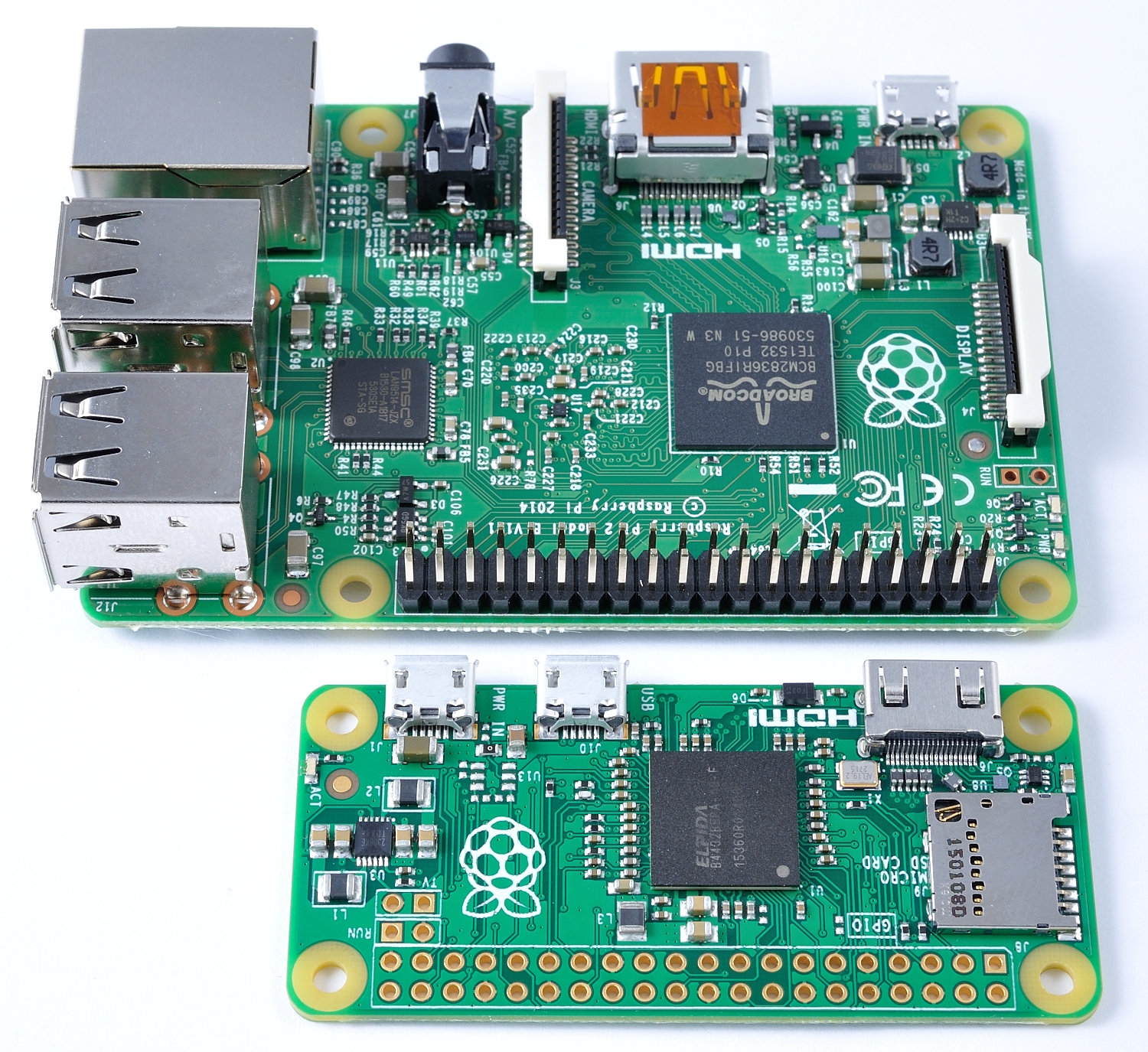

Is there a reason most people stay with the ā€˜full’ RasPi and not cheaper boards such as the Zero or NanoPi? In my experience a whole RasPi is quite overkill just to forward packets :nerd_face: .
the difference in price is not that much and there’s a lot more info and projects available, there is a life after LoRaWAN :sunglasses:
also … I don’t mind if the final enclosure is 7 cm wider, its not important for a ā€˜modem’
Also, the original Zero (as pictured in above post) needed quite some additional investment for network access, and availability of a bare Zero (without some starter package) was bad.
I don’t know how availability of the Zero W has been since its release in February, but Kiwi Electronics in the Netherlands still only allows one per customer! (And the same still applies to the first Zero.)
