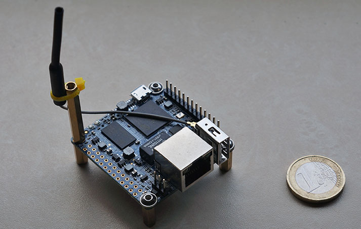

Armbian for the Orange Pi is still a work in progress. You’re better off with the NanoPi Zero, Armbian support for the peripherals is better there and they run more stable. My latest gateway is using a NanoPi Zero with the TTN packet forwarder, running good for weeks now.
Really looking forward to Armbian support for the NanoPi Zero Plus 2, which has 8GB of onboard eMMC memory. That makes for a much more stable and reliable product than using an OS on a SD card.

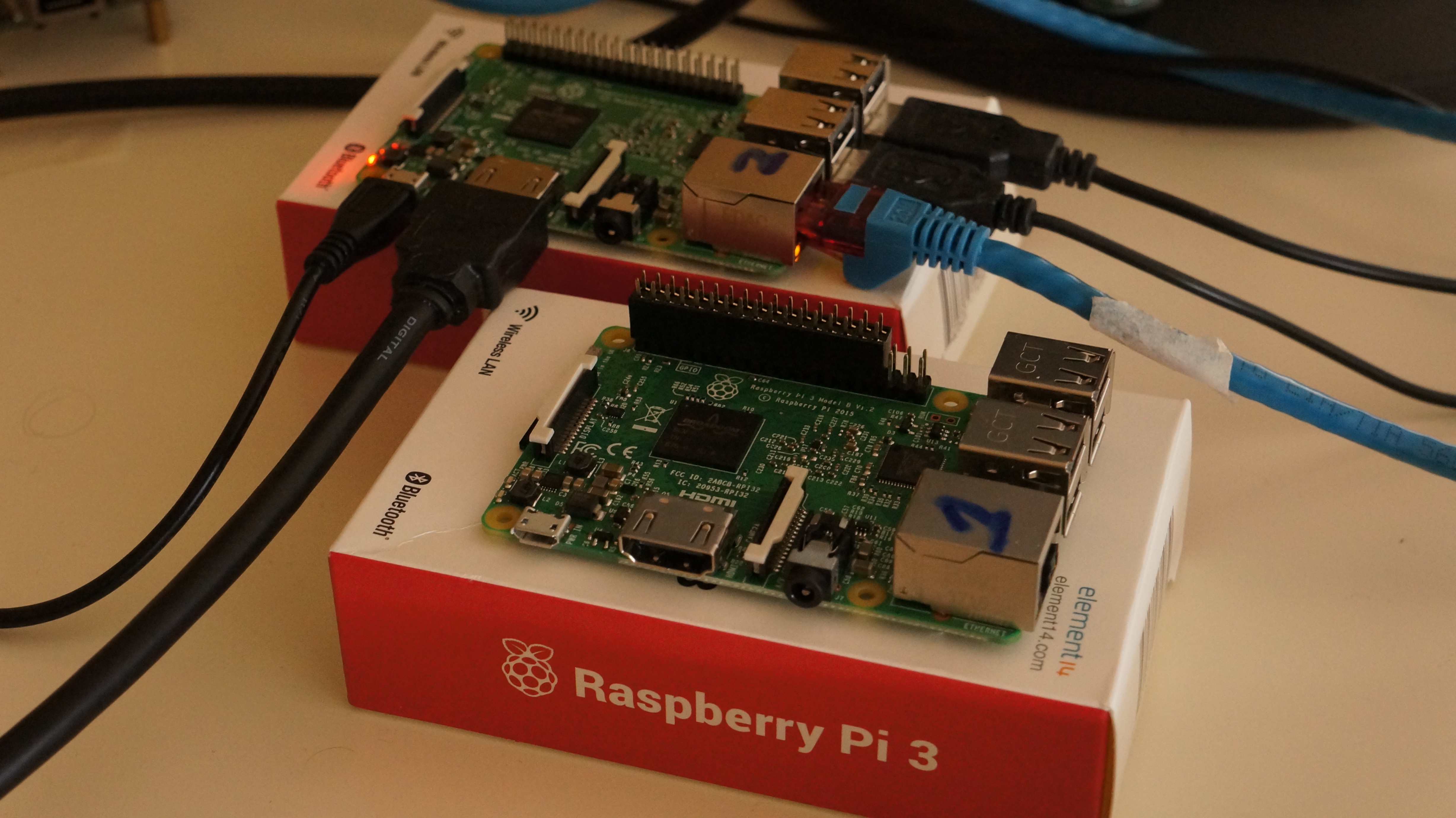

Getting started with the RAK 831 Lora Gateway and RPi3

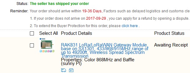

Nice, my RAK831 is on its way :slight_smile:
