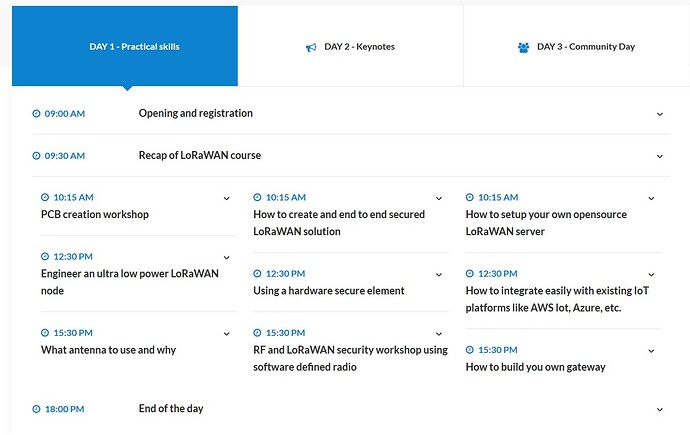

For those that are in the wrong continent to go to the conference @BoRRoZ, will there be RAK831 demonstration?
day one of the conference is all about practical skills.
also ‘building your own gateway’ I assume that here is a role for RAK831 boards, have to check that
laurens posted above that there will be a session on building a gateway with the RAK831
I think you may also see Rak’s new SX1308 gateway there ![]()

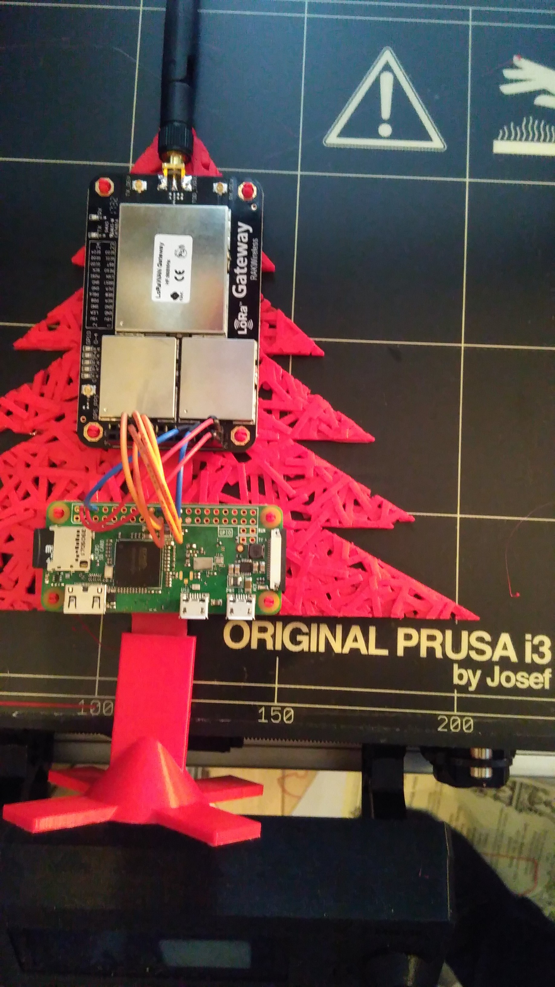

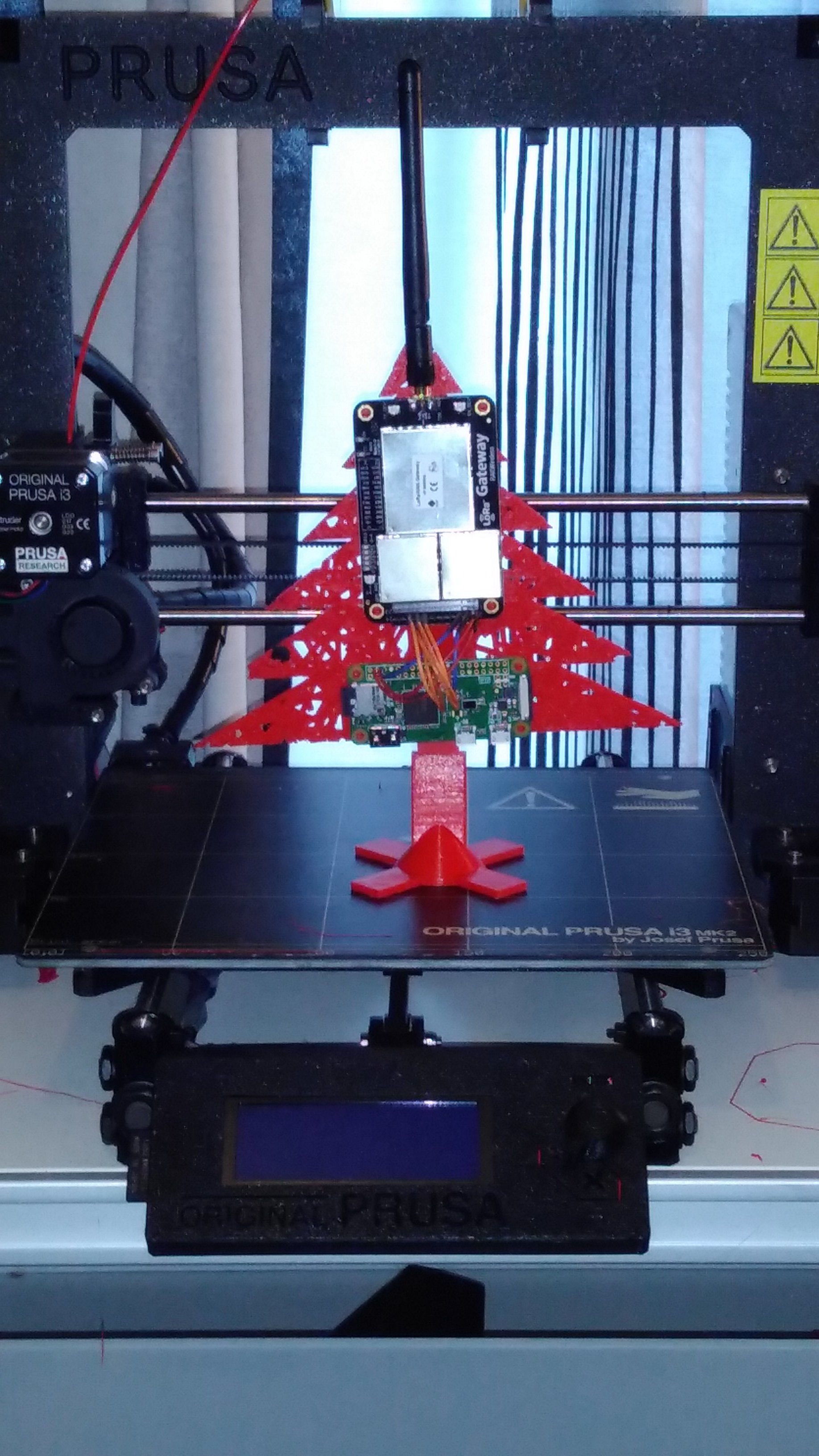

Christmas rak831

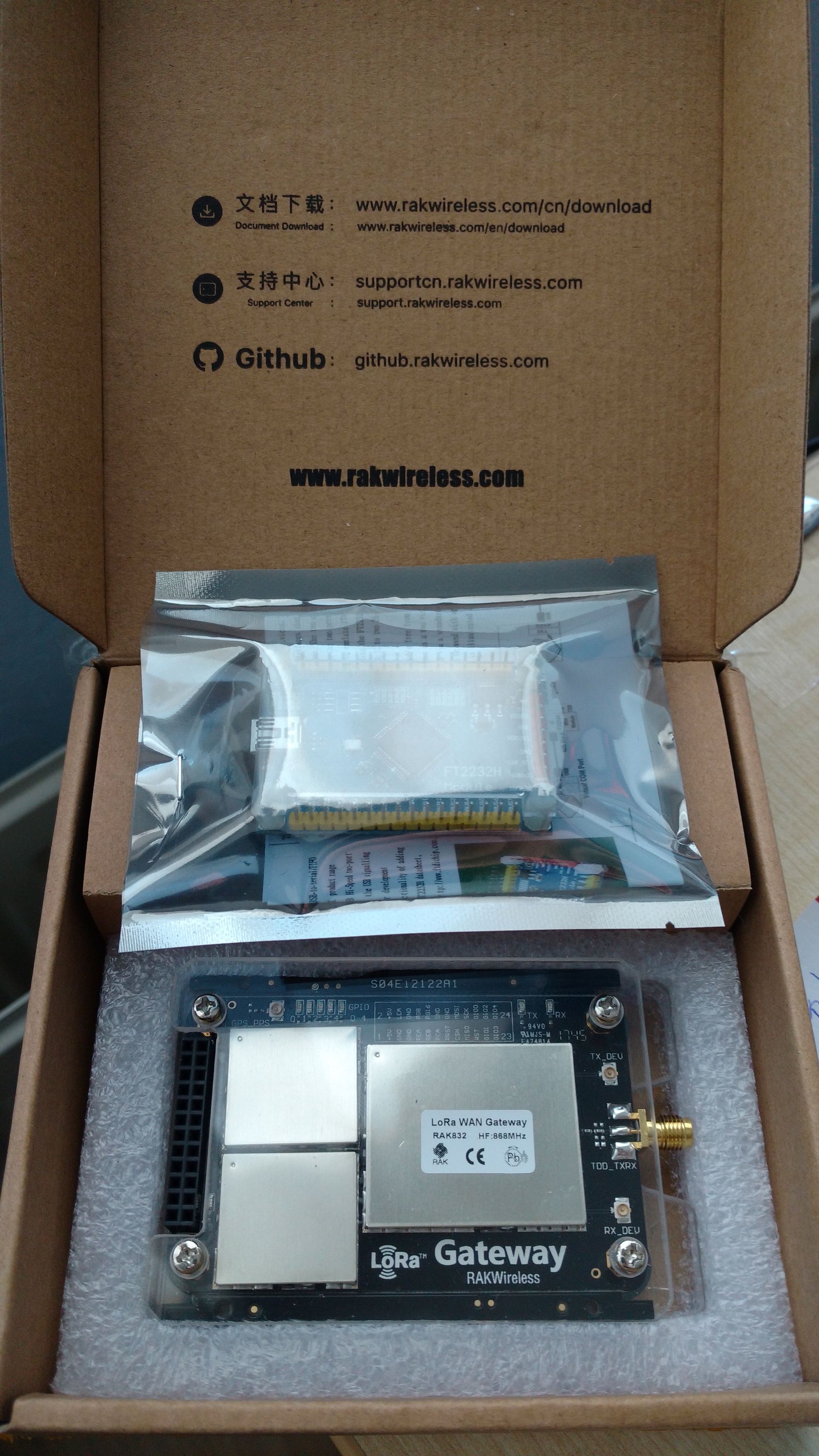

and the RAK832 arrived today from Rak
Looks very familiar
Maybe the first SX1308 commercial gateway?
And the RAK832 arrived in The Netherlands
