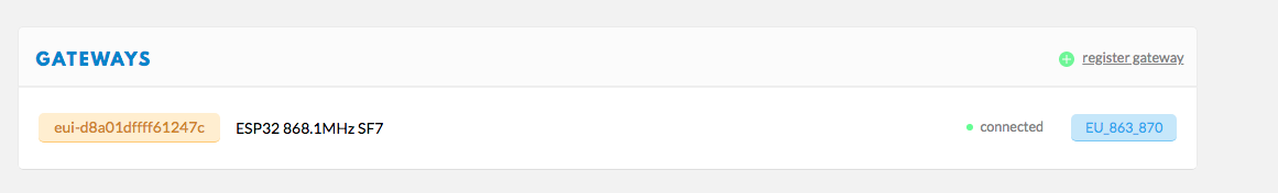

We are in Sydney Australia and have an own designed gateway device and several node devices on test. Two of the devices were also sending data to 3rd party visualisation platforms. They all worked fine for quite a while until last Sunday (18 Aug) late night (AEST). The TTN applications all of a sudden did not show any incoming data any more and the 3rd party platform were unable to receive any new data since then. The console gateway traffic still shows incoming data from these node devices:
But these data seemed not going through to the applications.
We haven’t done any changes to any of the devices in the test and just let them run over the time.
