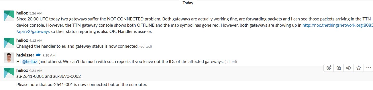

About 4 hrs ago both my gateways au-2641-0001 and au-3690-0002 are suffering the NOT-CONNECTED problem.
Gateways are MultiTech Conduit V1.4.17, one installed installed last week the other a month ago, showed up on the map until 2018-09-26T20:00 UTC (06:00 local time)
Now the console says last seen at xxxx and the map symbol has gone red.
Handler is ttn-router-asia-se for both.
As with all other cases listed in this topic packets are coming through the gateway and the gateway is doing what it’s supposed to be doing.
We have four gateways in our community, two have the old style eui-00800000a000xxxx ID and two have the new freely definable ID. The gateways with the eui ID style are still showing as connected - could there be a connection between gateway ID and the NOT CONNECTED issue?
I have changed one of the gateways to use the eu handler and it’s status immediately went “connected”.
Any comment on this issue from the TTN team would be appreciated.
