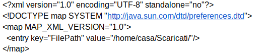

I was finally able to install the tool on Ubuntu 64 bit 17.10 following these steps:
I posted the problem I had later related to the firmware update to another specific forum thread (Where to find RN2483 firmware updates)
I successfully updated “the things node” RN2483 to version 1.0.3. Instructions here: HowTo: Update RN2483 Firmware on ‘The Things Node’ to prevent excessive battery drain
but due to the bug in the file selection dialog, I had to switch to win10.
