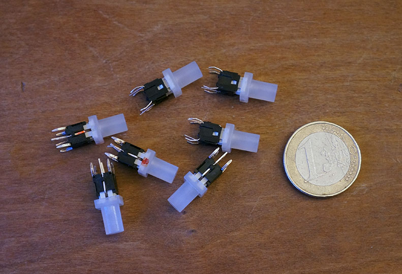

nice (momentary) switch.
is it also available with a RGB led?
indeed momentary nonlatch with buildin LED… I bought them a few years ago unfortunately I can’t find a link.
have them with a green,red and blue led
RGB I don’t know… if I find the link from the supplier I will post it here ![]()

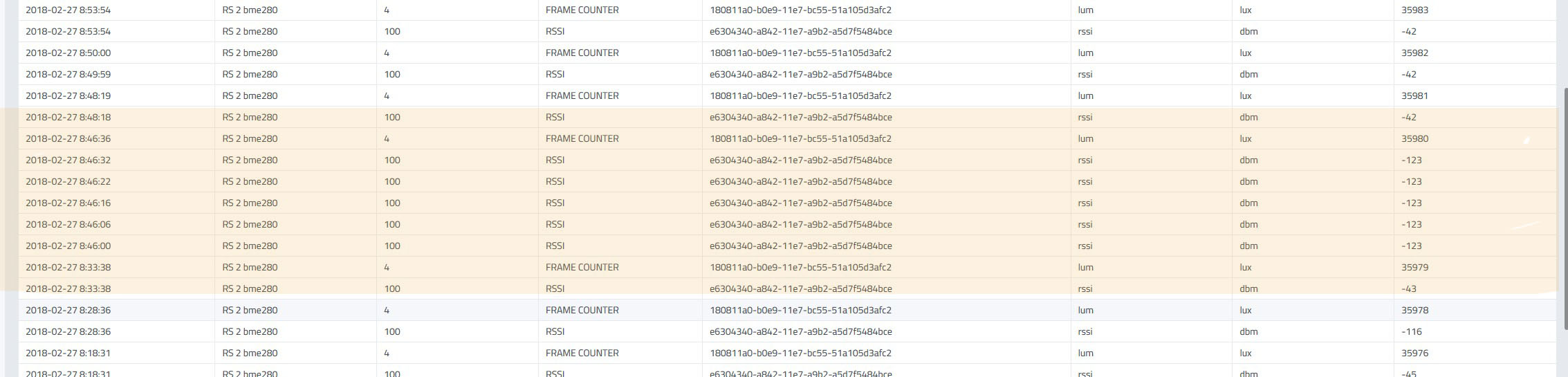

@ the moment I am trying to understand this.

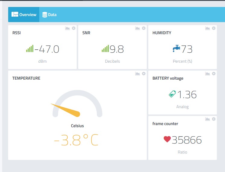

you see filtered sensor data from early this morning… only RSSI and framecounter
I am watching this closely @ the moment because I want to see how the RN2483 behaves in the cold
Is this the ‘problem’ with the old silicon ? see the enormous drop in the RSSI and some retrys and then happely continuing as if nothing happend
data made available through new Cayenne feature

yes its a know hardware problem with the rn2483 version.
the new ones, the rn2483A ,seem to have a better crystal tolerance.

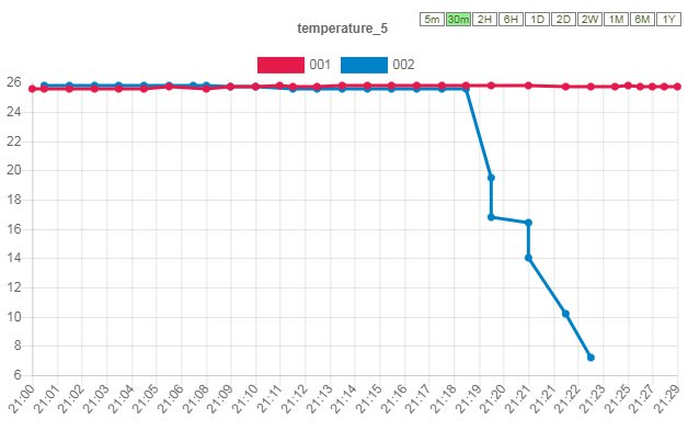

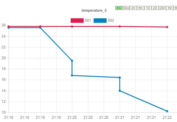

I don’t understand your graph, temperatures drop very fast in your shed

Node 001 is INside, I took Node 002 OUTside
It is cold outside… and the Node stopped working at around 7 degrees:
7 or -7 ?
ok I see it stopped transmitting at 7 on your graph but that’s not normal behavior
+7 (see Y axis)
(yes, the x-axis needs some work)
