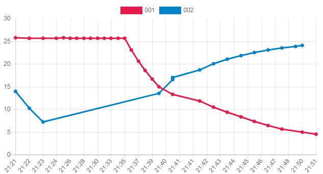

Both are on USB power (I stopped ordering AAA batteries every week)
Firmware is december 23rd version (don’t have Arduino software at hand now)
Switched them, now it drops below 7
Will see what happened tomorrow … (wife says cold Nodes should not be my priority now :wink:

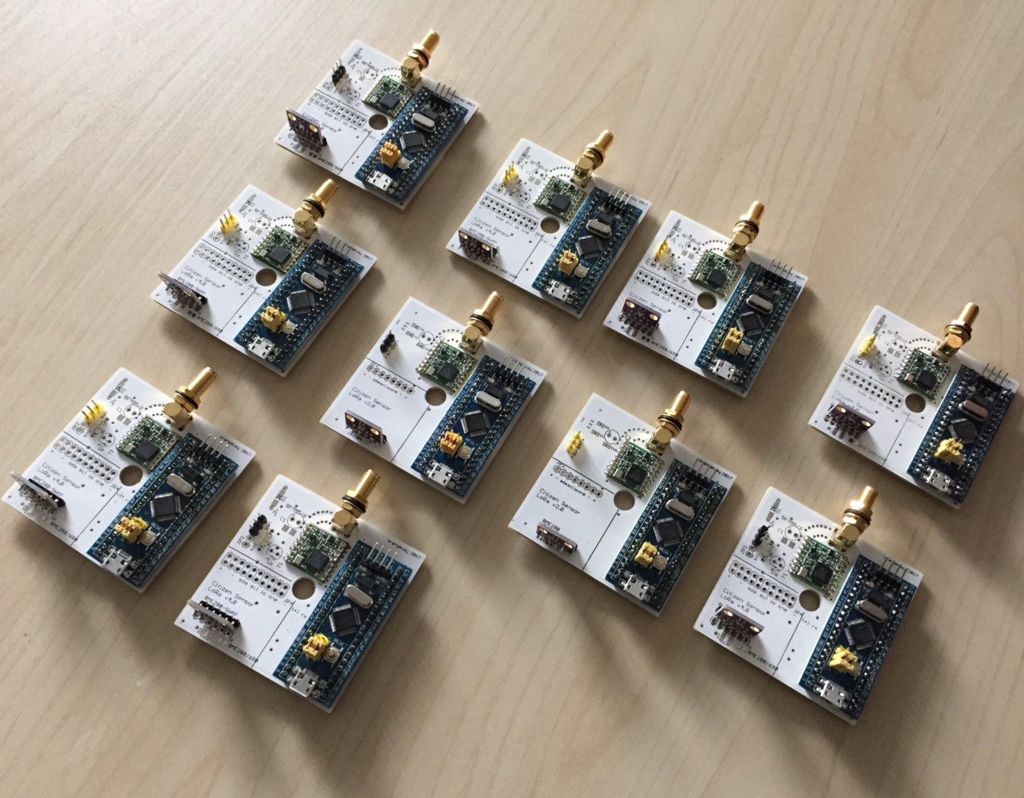

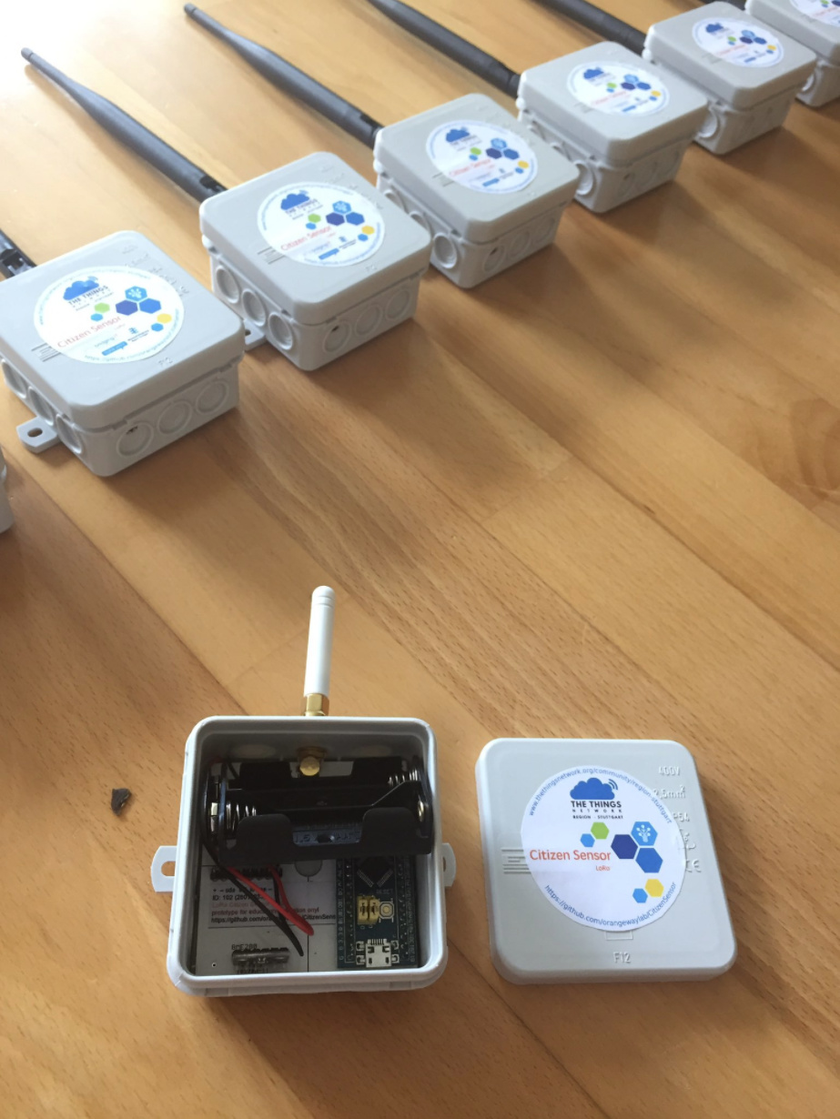

Teaser for @BoRRoZ STM32 Blue Pil based Things Network Citizen Sensors. :wink:
capture 2018-02-27 23·22·47
https://twitter.com/orangeway
The antenna connectors may need some Liquid Electrical Tape for weather proofing.
#468
Temperature/Humidity/Barometric Pressure Sensor inside the enclosure ? … hmm interesting
#469
I notice at least one hole in the bottom, below the BME280.

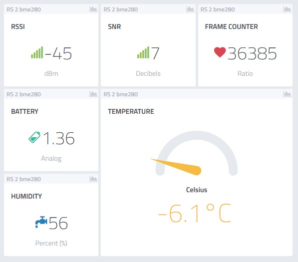

(Kalon33) #470
I have a Seeeduino LoRaWAN based node with a 3.7V LiPo battery and a BME280 module, currently reporting -6.2°C, so based on my experience, a LiPo battery should be OK there. But indeed, it’s protected from rain :wink:

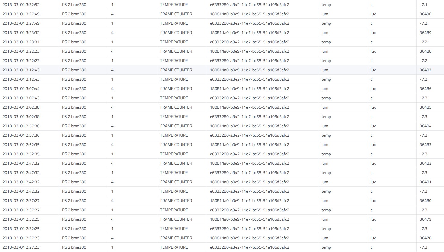

(Danny Engelman) #471
Here is my ‘first generation’ result:
Stopped transmitting temperature once it went below 0
#472
Hi DannyE
I suspect that’s a bug in your code somewhere, not handeling the negative values right because I have never seen a module stopping at exactly zero degrees.
Tx = RN2483 until now no problem
  • update last night was a very cold night in Holland -7 (some of you will laugh) and I was curious what will happen to the RN2483 based node… in short nothing, it just worked.

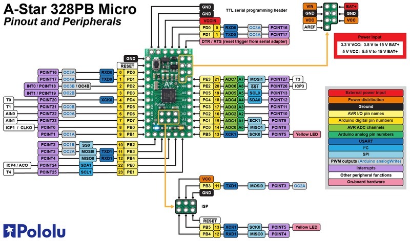

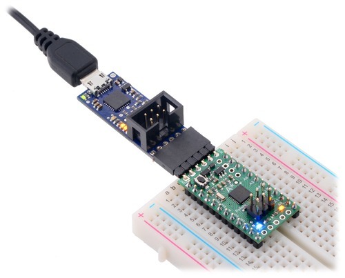

today I expect the Pololu A-Star 328PB… an arduino pro mini look a like, but with the new MICROCHIP ‘extended’ 328PB processor.
I have some use case ideas and also expect some problems, because its not yet fully suported in the arduino IDE

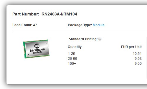

rn2483-104
seems that there’s a new rn2483A firmware update coming

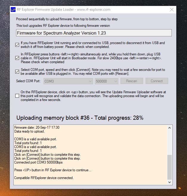

support and updating process for RF explorer products is excellent !
still need to test further the RAK magic stick 8 dbm 868 antenna.
first things first… installing and updating the spectrum analyzer/ rf generator and rf explorer.
updates under win 10 … pfffffffff ,seems that my second screen don’t work anymore on my laptop
worked fine under ubuntu…

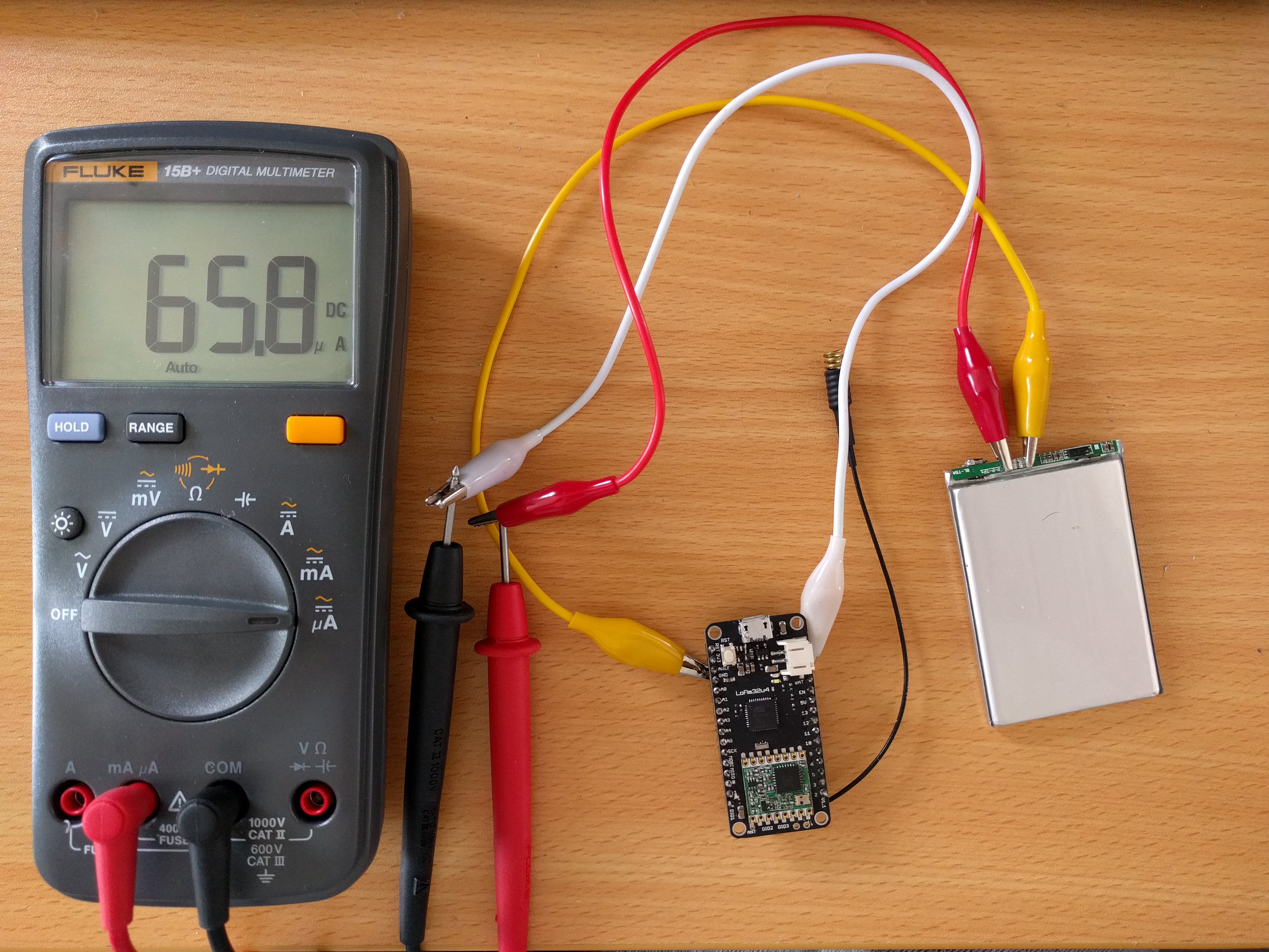

(chaolue) #479
Sure BoRRoZ,
I originally used some code from here - Adafruit Feather32u4 with Lora
With a couple of additions:
#include "LowPower.h"
void loop()
// Sleep radio
rf95.sleep();
//USBDevice.detach(); doesn't work on 32u4
// Disable USB clock
USBCON |= _BV(FRZCLK);
// Disable USB PLL
PLLCSR &= ~_BV(PLLE);
// Disable USB
USBCON &= ~_BV(USBE);
// ATmega32U4 sleep
LowPower.powerDown(SLEEP_8S, ADC_OFF, BOD_OFF);
// Reattach USB to have Serial working again
USBDevice.attach();
Found in RocketScream forum here. The most important bit being disabling the USB, which saved a lot.
I’ve also had some attempts at removing the voltage regulator and bridging the 5V/3.3V pins. (Note: that you really need to program via ISP after this)
Here are the results with the Adafruit code above:
I have been able to replicate the same power usage with LMIC lib. The only additions I’ve made to the TTN ABP example code is changing pins, adding LowPower lib sleep and disabling the USB with same code as above.
Hope this helps.

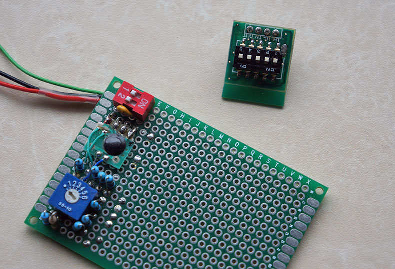

#481
sure (and tnx for your info) , but the external timer prototype is … uh gone, this is what I have left
  • one DIY timer and one complete 'module, have to search for info.
these are the two I’ve tested, the one without the dipswitches is cheap, but not very accurate and I had to buy a seperate switch
the whole idea was to test if a customer/installer could set a node interval from the outside, but there are better , more accurate, ways over the network
