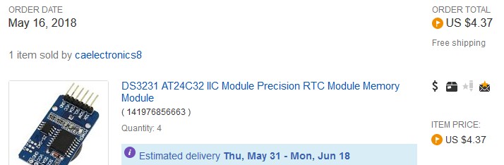

luckily I also ordered 4 of these with memory… thinking ’ maybe I could desolder the mem + led
ebay%203231

That is the module I have used a few times. It does not have a reset pin but I never needed one. The 32kHz can be disabled and the SQW can be used as alarm output.
#855
indeed a nice accurate and very cheap RTC module.
lots of info and libs too :sunglasses:

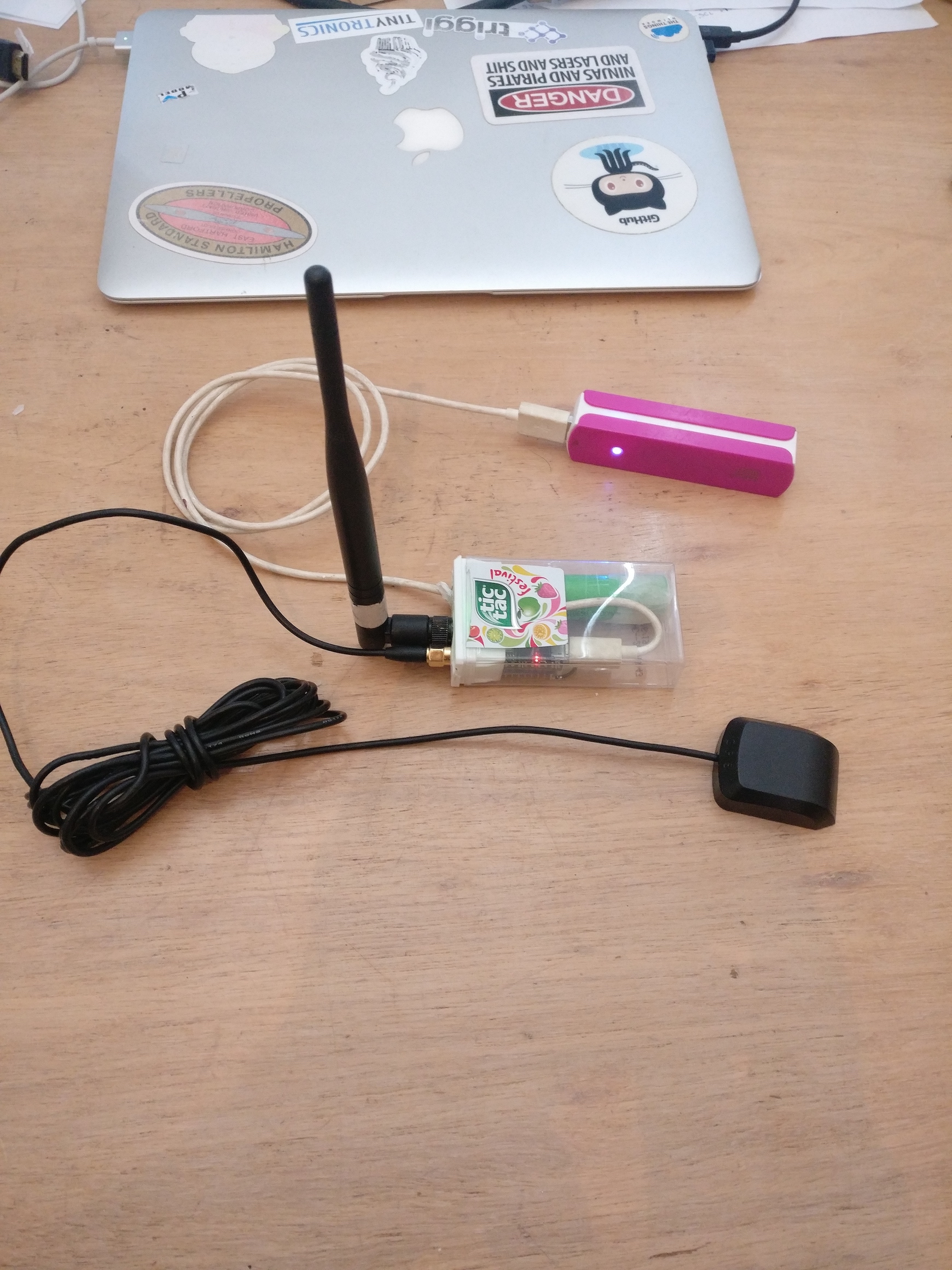

Meet the Tic-Tac Rak-Tracker
46
Naturally with the required pink battery from the Action store
#857
very ’ crea ’ Paul :grinning:
  • off course we want to see the opened IOT TTN TicTac enclosure… what’s inside ?
#858
and
39
#859
confusing picture because I think a NCR18650B would never fit in a TicTac box … this is a smaller battery/lipo (AAA?) (but same green colour)
(Jeff Uk) #860
Larger pack/bulk buy Tic-Tacs?! :wink:
#861
This box looks bigger, was also a lot of candy to eat

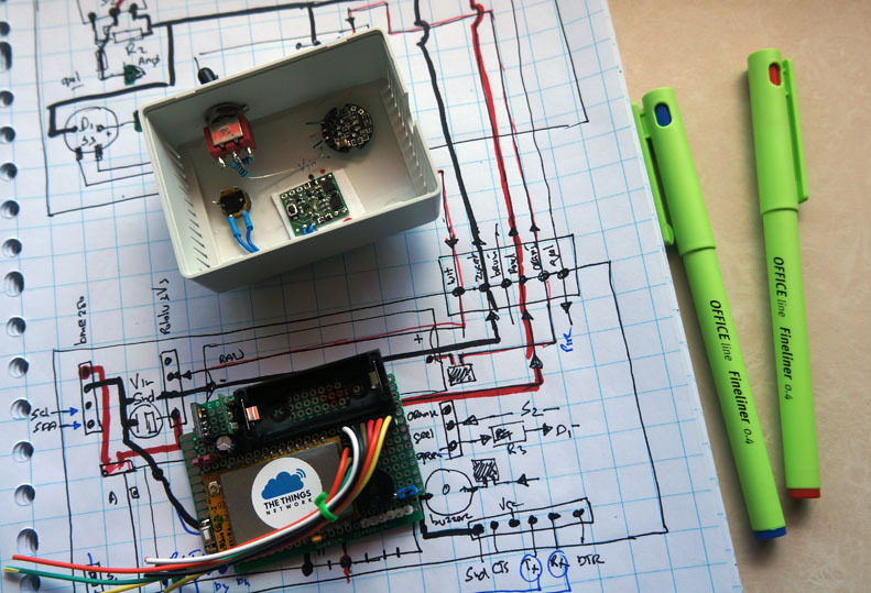

detail
x828
x829

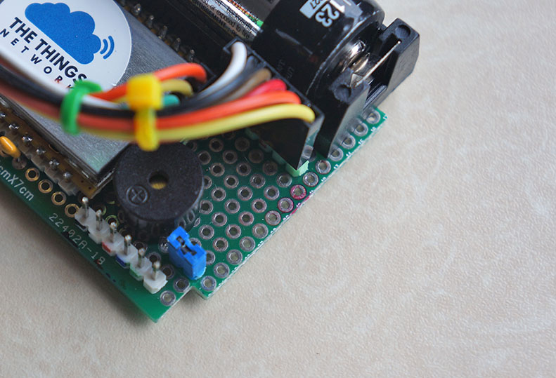

audio feedback (buzzer) when testing and placing the PIR sensor, remove jumper when done (silent alarm)
x832
for more complicated wiring I use analog design tools :wink:
(Hix) #863
An alternative to ty-raps I use in such cases are water hose clamps with a screw band.
https://en.wikipedia.org/wiki/Hose_clamp
You can get them in varying sizes from gardening equipment stores or construction stores, either in galvanised or stainless steel versions. If you need more length, you can join two or more of them in ‘series’.
Hix
#864
I mentioned with a link : https://eshop.wurth.nl/Geperforeerde-montageband-met-randperforatie-MONTAGE-GATENBAND-VERZINKT-25MM/097225.sku/nl/NL/EUR/
With some bolts and nuts M4 / M5 you mount in a few steps to each pipe.

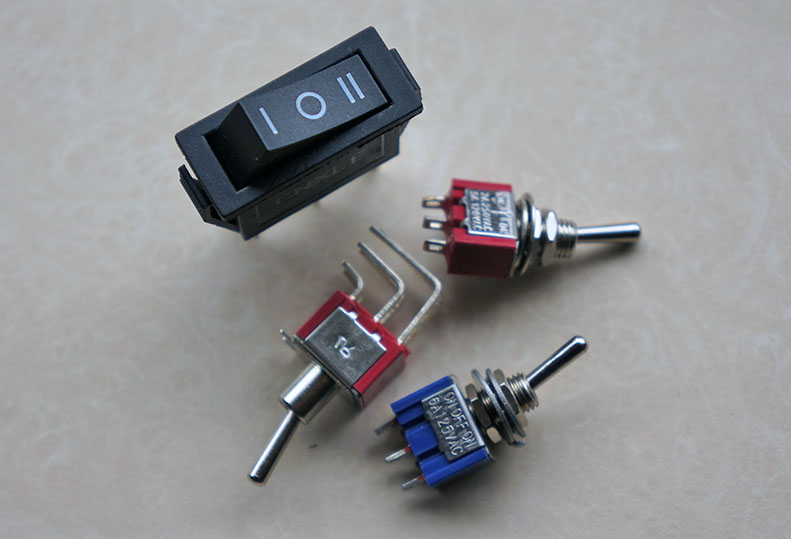

x830
read the position of a 3-way on-off-on switch with a single arduino pin

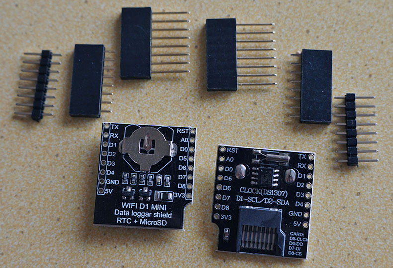

x831
Micro SD Wemos D1 Mini Data Logger Shield+RTC DS1307 Clock
I don’t have a use case for them (yet) but they are so cheap:sunglasses:

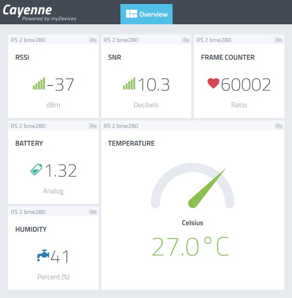

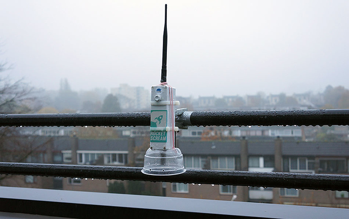

and still running :sunglasses: (started 24-10-2017 on a single 1.5 battery)
60k
monatoetjerocketscream
rocket scream + monatoetje node
(Ssozonoff) #870
Huh … with LMIC stack ? I have yet to have mine run longer than a couple of weeks before something crashes and it needs a reboot. I took some example the Rocket Scream guys.
Good to know that its possible though!!
