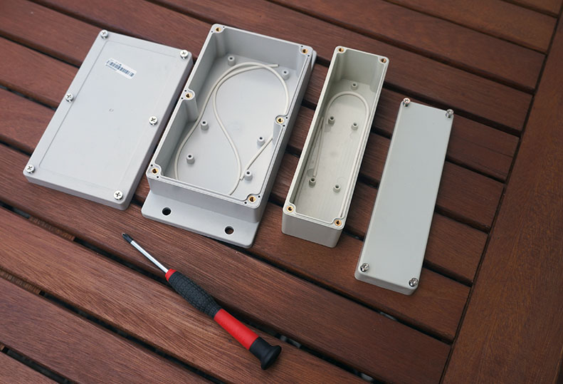

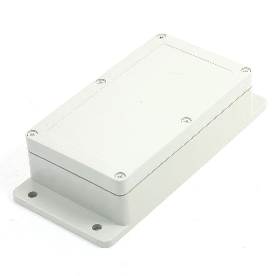

Any reference for this nice enclosure?
Rocket scream gave me one, and still on “to do” box, shame on me
there seems to be a problem worldwide buying the rn2483A that should be solved end of june.
@Charles … what’s that ?
Enclosure, sorry
Thanks,
found them on ebay but $9 that’s a shame
this is also a very nice one Charles
https://www.ebay.com/itm/158mmx90mmx46mm-White-Waterproof-Plastic-Enclosure-Case-Power-Junction-Box-/192480262829
$4.99 incl. shipping

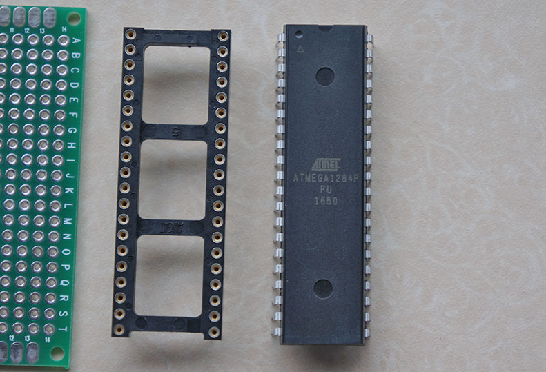

That’s interesting, just send to fab a 1284P board for a customer, I plan to use MightyCore for bootloader
don’t forget this fully assembled one Moteino Mega LoRa, really nice.
I used MightyCore, I will check your Moteina Mega Lora.

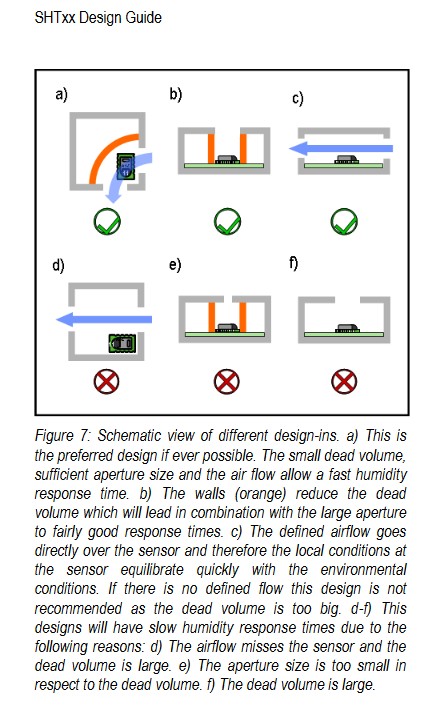

Just reading something about dead volume in relation to a temp / humidity sensor
(thanks Anatol from closedcube for the doc)
so placing a sensor in the 'open but, inside a weather enclosure like this one
a so called Stevenson screen, will result in a lot of ‘dead volume’ hence the humidity calculations can give problems…

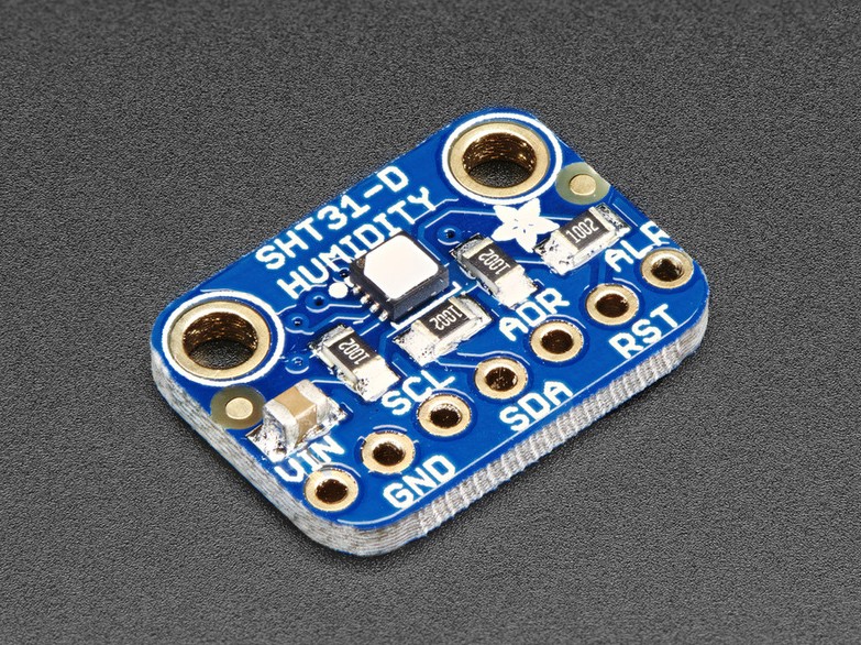

SHT31D with PTFE filter.
next week I expect the new Rocket Scream low power extra long life V 2.0 LoRaWAN node
and I’m going to combine him with the above, precise and fast Sensirion sensor.
In the past these sensors gave sometimes problems because they didn’t had a ‘real’ I2C bus… but now they do, ‘real’ I2C onboard … so no problems going to sleep/wake up ect.
Also nice is that you can set an alarm temperature and when that is reached it wakes the processor and transmits a LoRaWAN frame .
why should a Stevenson give problems?
the sensor is shielded from direct influence but good airflow is guaranteed.
