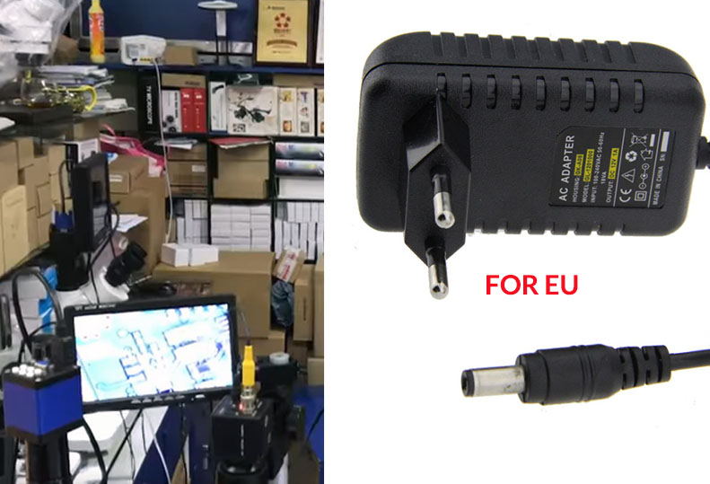

to suki liao from the microscope shop… THIS is what we need in Europe
Alternatively
to suki liao from the microscope shop… THIS is what we need in parts of Europe
@BoRRoZ, there fixed that for you!

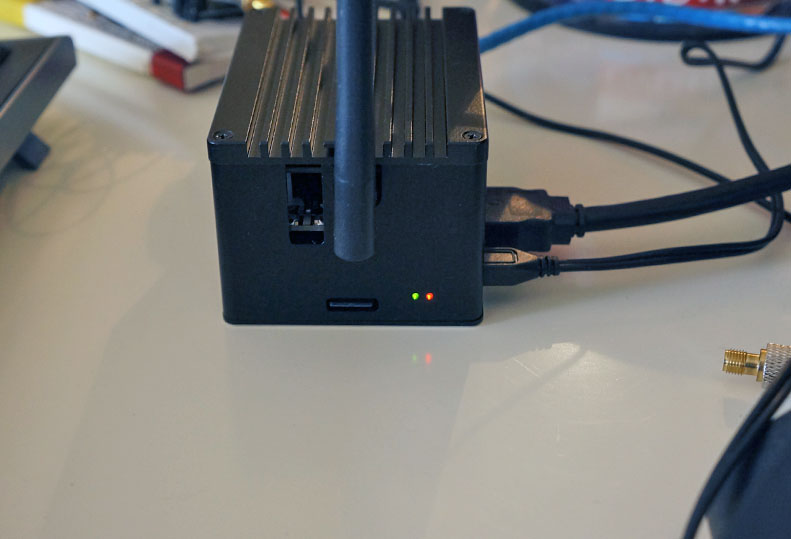

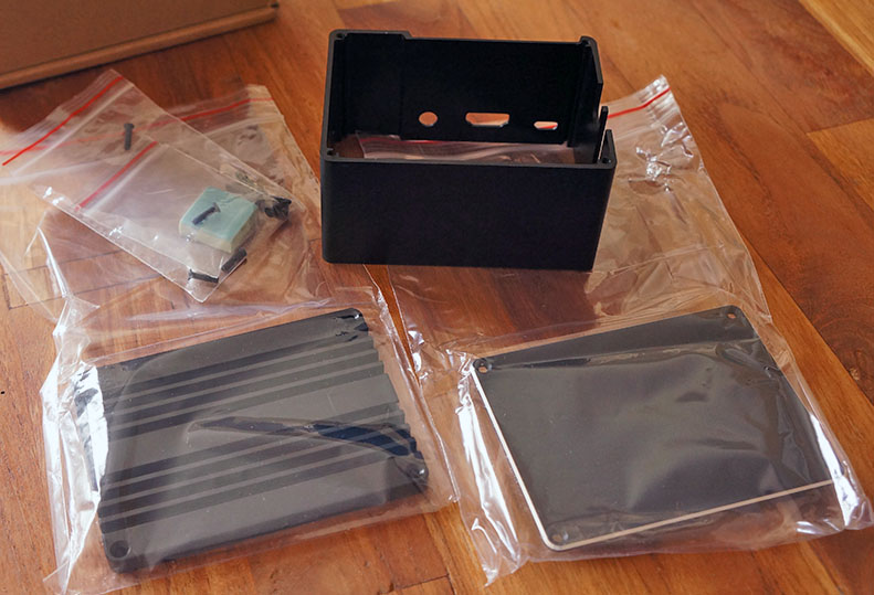

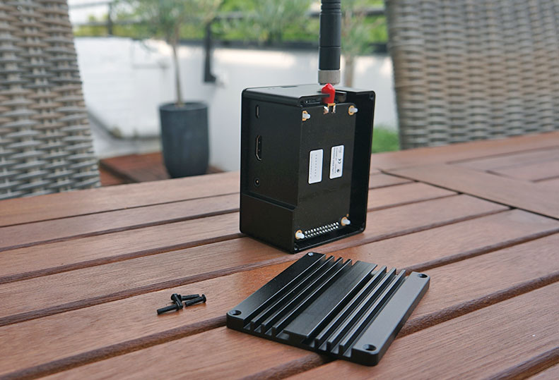

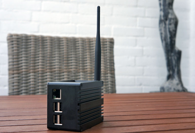

the new RAK TALKY

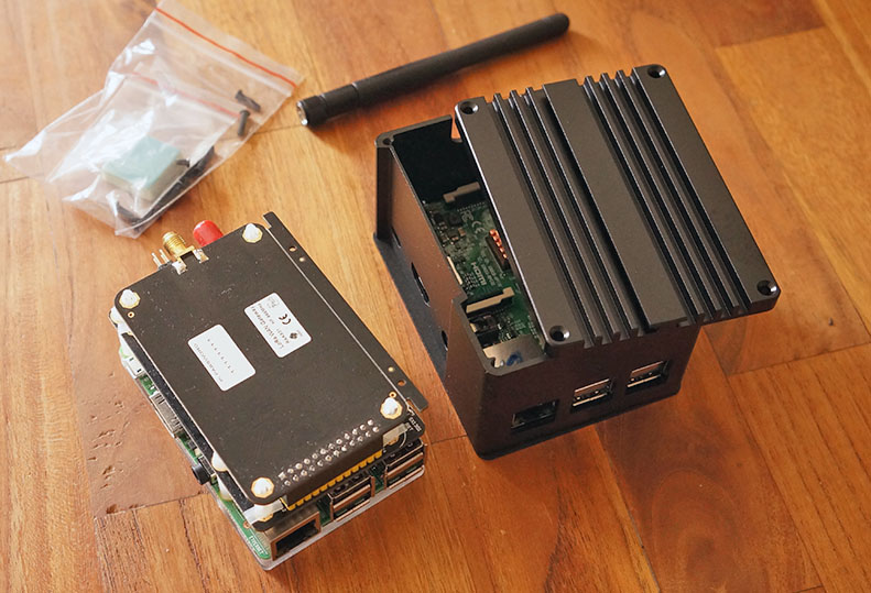

The PCB’s are not mounted to the case which any screws?
the rpi is mounted on the bottomplate with screws.

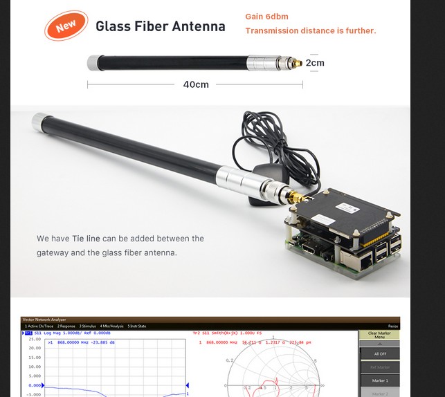

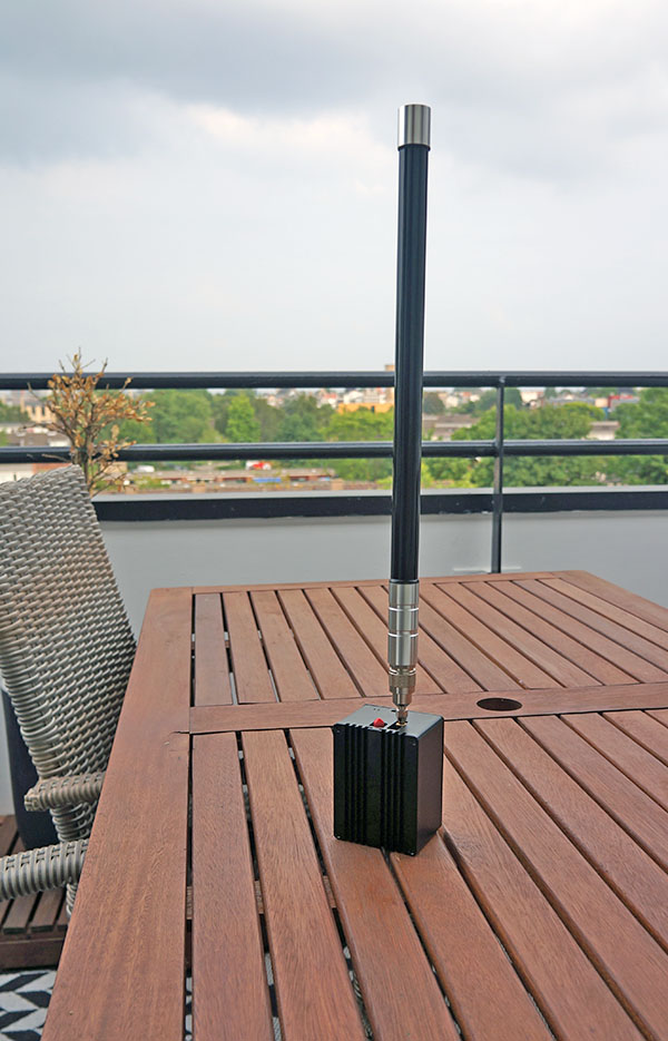

more dangerous is the impression given by RAK, that you can mount their ‘magic stick’ antenna with an adapter plug direct on the adapter board.
DON’T try this @ home !! it breaks …
luckily its the GPS connector (gps module is not mounted so no probs but… be carefull)
didn’t noticed the led’s before… nice touch

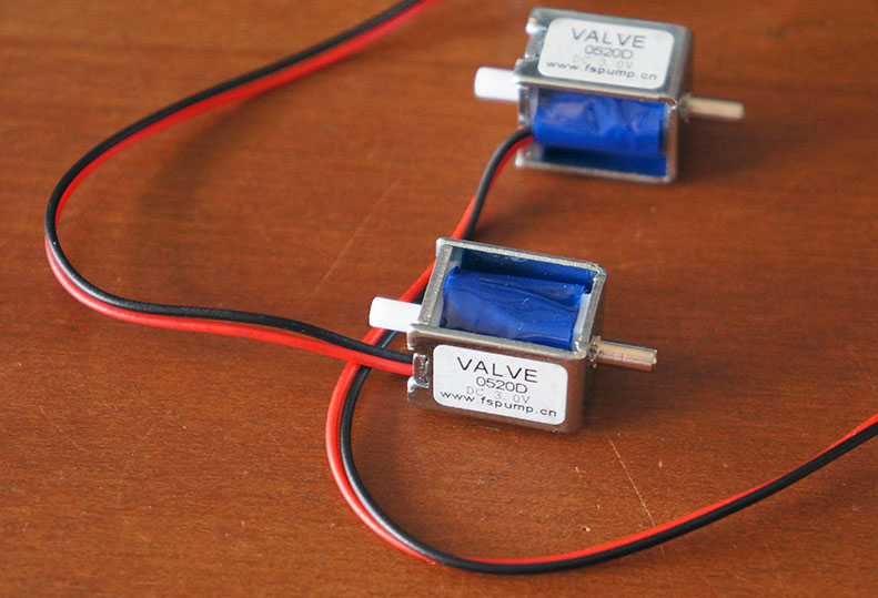

air inlet / outlet for the mcu controlled 'particle chamber.
3oo mA is a lot to open a little valve… hope the little pump is powerfull enough to switch off after a short time.

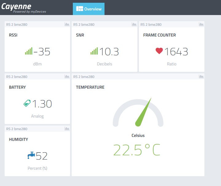

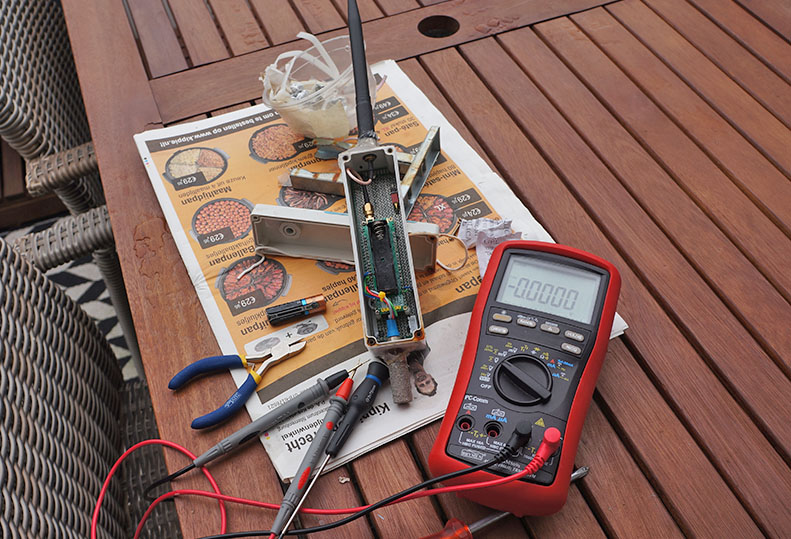

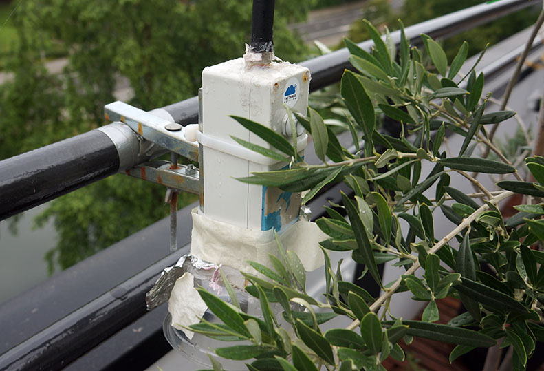

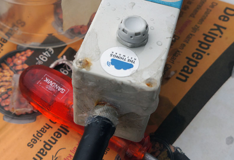

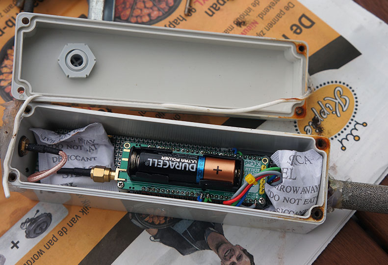

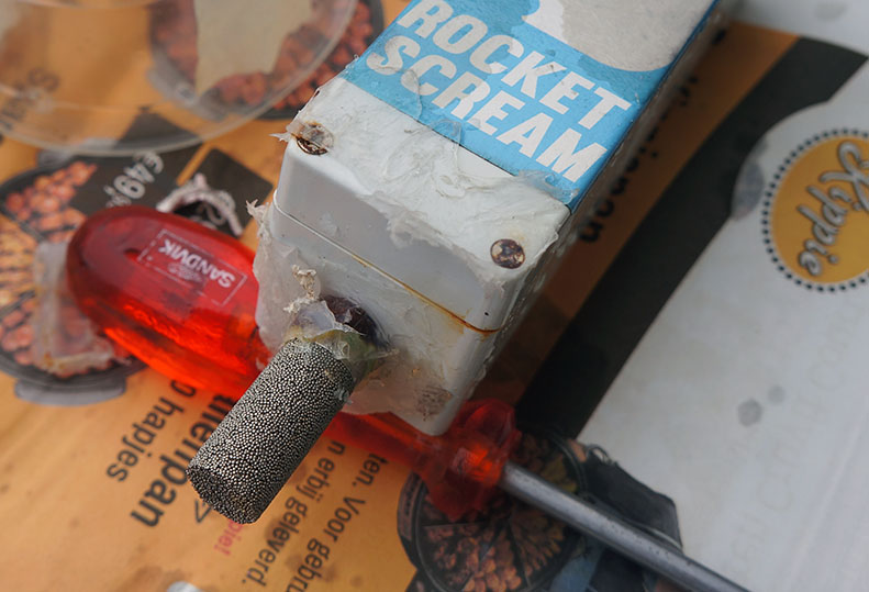

R.I.P. rocket scream testnode model 1 24-10-2017 - 17- 6-2018
65535 + 1643 + 1 + 1 = 67180 frames transmitted
67180 x 5 min = 335900 minutes / 60 = 5590 hours / 24 = 233.2 days on a single AA battery …
no sign of moisture inside
R.I.P. old LoRaWAN friend …
Way to go! Well done @BoRRoZ & @rocketscream…now if only we could buy them!
5 minute intervals are very close for a “deployed for life” environmental node? Had your interrupts been hourly or 4 x daily I think the hardware issues with Bosch sensor or physical robustness would have been limiting factors, not the battery life.
, That all said, to get 67,000 transmits from a single AA cell is an achievement, cudos to you and the RocketScream crew!
it was just for testing… max input voltage is 3v so you could more then double the life when using a lithium 123 battery.
the new model has an even better dc/dc converter that will work with voltages below 1.2 v so extending the node’s life, all is done to see what you can achieve with ‘normal’ batteries.

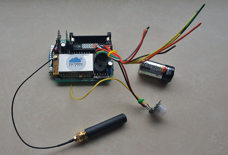

time to finish this 'dragino combi sensor (temperature / movement)
