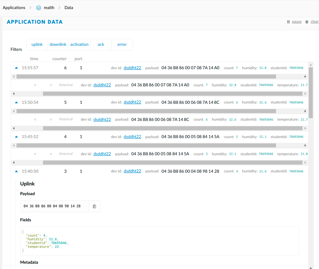

I’ve set up my first LoRa device and managed to transfer the data to TTN correctly. I’m using ttn-handler-eu. My “Payload Formats” code correctly interprets the data. Decoder returns a JSON object with the 4 fields shown, all 4 values are numbers, I’ve crosschecked that:
TTNpostImage

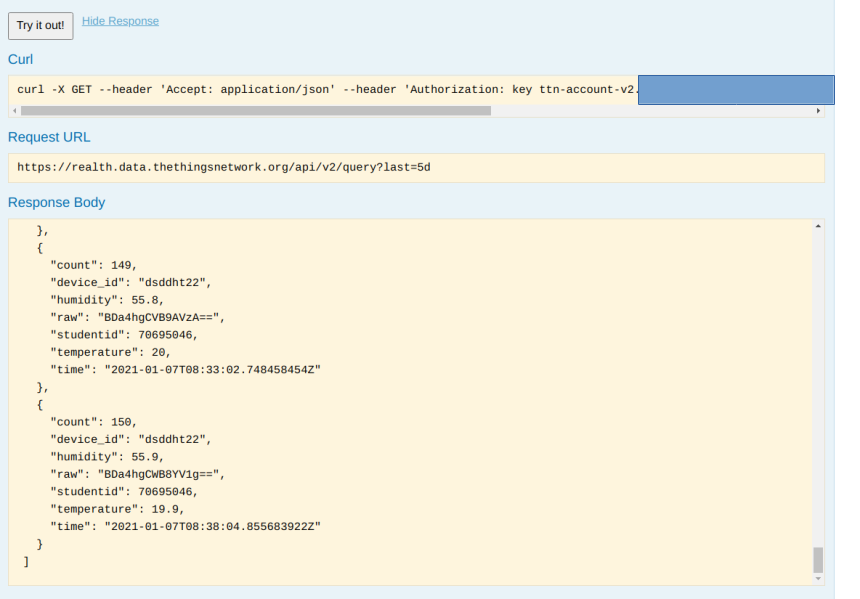

When I enter the Storage integration and click on “Platform”, it brings me to a swagger page. There I can do a manual authorization by copying my application’s access key. I can use the “try it out” feature of swagger then, which provides me my data in JSON format. Everything is perfect here. This is a small slice, I can retrieve my data several days back:
StrorageIntegrationS
If I query Thing speak (all fields) it returns nulls for the very same messages (identify the message based on the timestamp):
request: https://api.thingspeak.com/channels/1271033/feeds.json?results=2
answer: {“channel”:{“id”:1271033,“name”:“realthch”,“description”:“TTN2SP”,“latitude”:“0.0”,“longitude”:“0.0”,“field1”:“studentid”,“field2”:“count”,“field3”:“temperature”,“field4”:“humidity”,“created_at”:“2020-12-28T00:20:30Z”,“updated_at”:“2021-01-06T20:10:08Z”,“last_entry_id”:333},“feeds”:[{“created_at”:“2021-01-07T08:33:03Z”,“entry_id”:332,“field1”:null,“field2”:null,“field3”:null,“field4”:null},{“created_at”:“2021-01-07T08:38:05Z”,“entry_id”:333,“field1”:null,“field2”:null,“field3”:null,“field4”:null}]}
